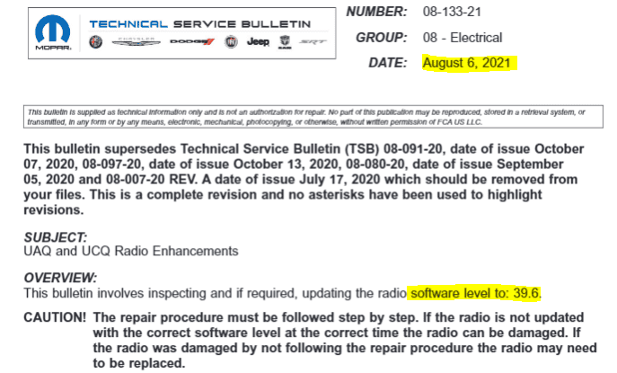

I know that quite a few people overseas have had an issue with the reversing lines not showing 100% of the time and I was wondering what the Australian experience has been. I have had my JL for about a month and my lines show maybe 25% of the time. There was mention elsewhere that a recent Uconnect update has fixed the problem.
So, does anyone else in Australia have this issue, and has anyone had it fixed?
thanks, Malcolm

Thanks. Unfortunately, we don't get OTA updates for Uconnect in Australia. And as far as I know, the Uconnect versions deployed here by the dealer are slightly differnent to the US market. Hopefully there will be a local update soon.

Jeep Wrangler JL Reversing lines not showing 700AA425-836A-4DE0-8615-3B67607A3398

A possible way to end that issue of intermittent lines...
When you start your JL, start it and wait say 15-20 seconds before put the JL in reverse.
Quite often it is seen if you do not let UConnect boot up fully that you will have no backup camera, or other b/u camera glitches like no lines, etc..

I have started using remote start and this seems to increase the chance of the lines showing. It doesn't guarantee them though. From what I have read, this is a software issue and the code needs to be fixed

Allowing more time for UConnect to boot up and get it's act together so to speak does seem to make a difference in regard to this lines showing or not showing issue.
As quite a few others have noticed over the last 3+ years, when you use Remote Start or just wait say 15-20 seconds after starting the JL and before placing the JL is reverse, that this will greatly minimize seeing the hiccup or seeing it at all.
Sure the hiccup could probably be addressed by a software fix.. but the issue is still an issue even with 2021 JL's.
