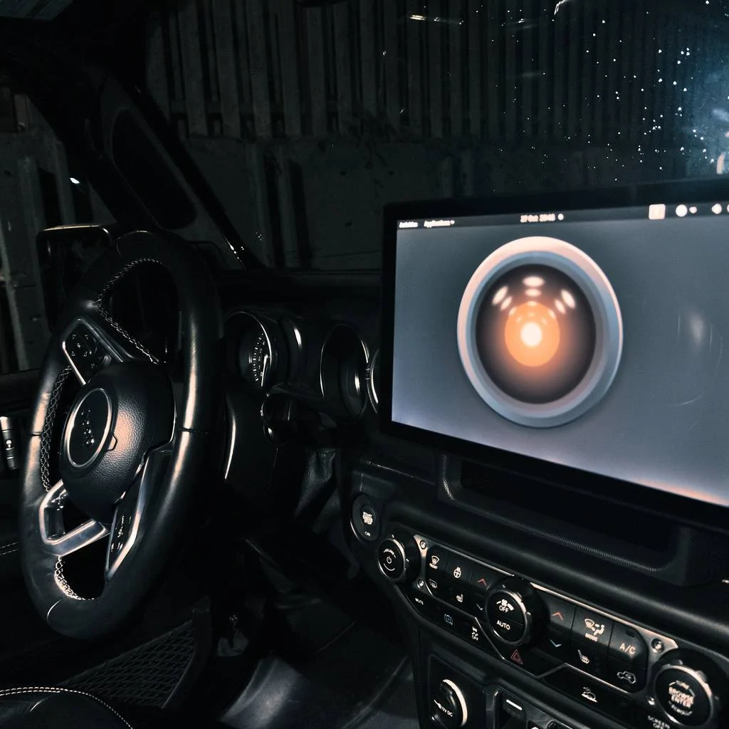

What I did was get this screen+case combo, a 67 designs ball mount, a 20mm ball mount to vesa adaptor, some arms, and it mounts nicely like this vertically or horizontally. Pi and hat fit within the case with some spacers (standard, motherboard spacers will work). Likely some hats might not need spacers.
Only advice I'd have is when you're drilling down, make sure to dismantle the dash and remove the Uconnect unit, since it'd be easy to damage otherwise. Also lowering the windshield makes it easier. From there it's easy to reach the glove box CAN connectors:
Jeep Wrangler JL JEEP HACKING CAN-C / CAN-IHS / UDS ! (Reverse Engineering) jeep_pi
I ended up writing something that displays a flashing eye when the doors are opened, but I'm still trying to figure out how to reliably detect when the vehicle is unplugged. Once I have that, I'll publish it. Silent alarm is also implemented, but only for door events.
