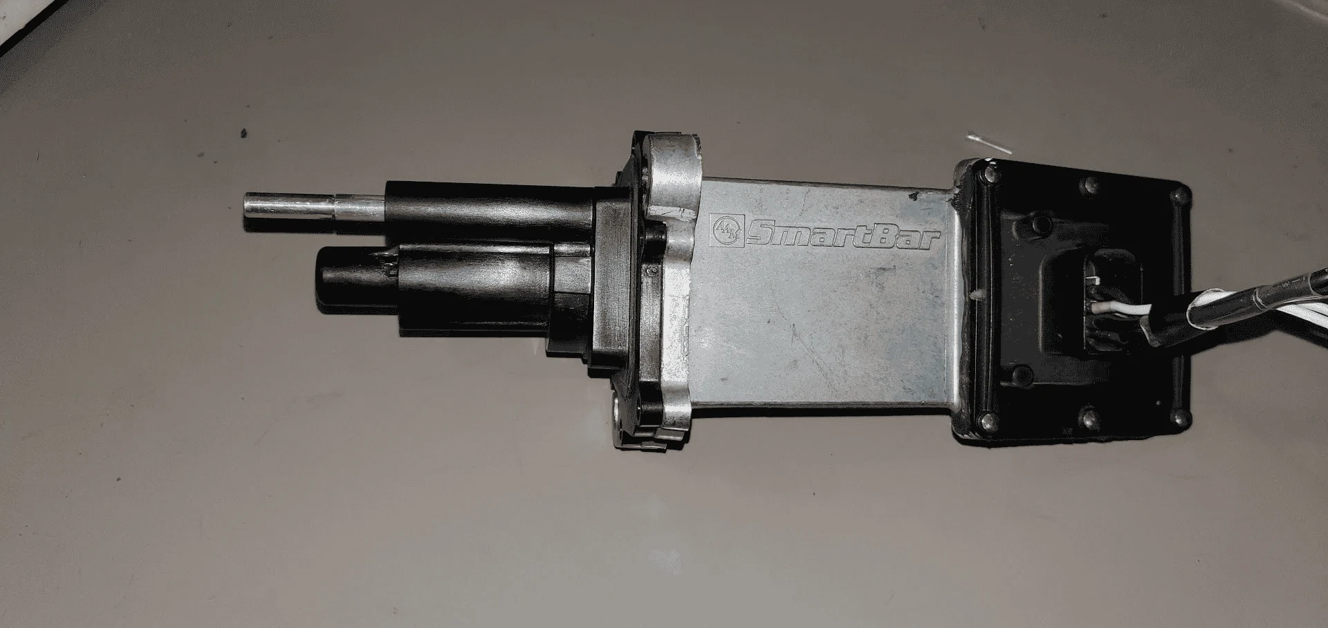

So you are testing a new one on your bench, sending commands directly to it? without it being attached to the jeep's wiring?
I'm wondering if the sway bar, being a critical safety component, is on the other bus for critical things. Someone earlier mentioned the bus name, but I can't remember it. I'd bet that we are sending commands to a different module that in turn is commanding the smart sway bar to operate. Does this make sense?
My sway bar came from a JT Rubicon which was basically brand new when removed... I have not connected the sway bar to the JL's wiring because mine is a JLU Sport.. it does not come with that sway bar wiring (the wiring diagram shows the sway bar connected to the CAN-C bus) ... also.. I only have the motor / control module on the bench.. .not the entire assembly (I wonder if the thing has to be completely assembled for it to work... ??? I doubt it)
The shiny metal rod is the plunger sensor.. the one below is the actual motor actuated plunger that pushes the collar to engage/disengage the sway bar mechanism (this photo is of my smartbar on the bench)

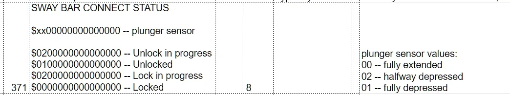

I'm trying to document message ID $371 in the spreadsheet, but it looks like both of you are describing it two different ways? RedRacer has a wider-ranged value in the first byte and that 00-02 status in the second byte. You've got just a 00-02 status as the first byte and that's it. Both of you have the rest of your bytes padded with zeros. Which way is it?
As it stands, I've currently documented it as:
Could it be that what RedRacer sees on the bus with that first byte D0 being populated with different values and the plunger sensor value moved to the second byte is only when a toggle command is issued by ID 0x26F ??
RedRacer... when you get a chance.. can you please check what the sway bar sends to the bus
when no commands are being issued? do you see 0x371 sending all Zeroes on all bytes about once a second? Thanks!!!
This is what Redracer sees:
0x26F 00 40 FF FF FF 7F 7F 7F Sway Bar Request - unlock / lock toggle - need to test this.
0x371 51 02 00 00 00 00 00 00 sway bar unlock in progress
0x371 70 01 00 00 00 00 00 00 sway bar unlocked
0x371 42 02 00 00 00 00 00 00 sway bar lock in progress
0x371 61 00 00 00 00 00 00 00 sway bar locked

Please let me know the results once you get to test the Sway bar unlock / lock toggle.. I tested the smartbar on my bench .. I sent the packet but the smartbar did not react to it.. and I did not see any sway bar response on 0x371 ( I only see the sway bar generic poll every second with
0x371 00 00 00 00 00 00 00 00 ,,, that is all... no response to the toggle command.. no movement of the motor.. ☹ )

The sway bar module has all of the safety logic located inside of it. It needs to know the status of the 4wd shifter and vehicle speed. There may be other things that it listens for as well. But if this status is not present on the bus that the sway bar is connected to then it won't respond. It may also have to be enabled (using a tazer or something similar).
Good points... Thanks!.. I will connect it to the canbus at some point in the coming weeks.. a little issue is that I have not been able to find the connector anywhere... I actually wrote to both Hirsmannn Automotive USA and Austria about where to buy the connector... I received no reply.. ugh..
