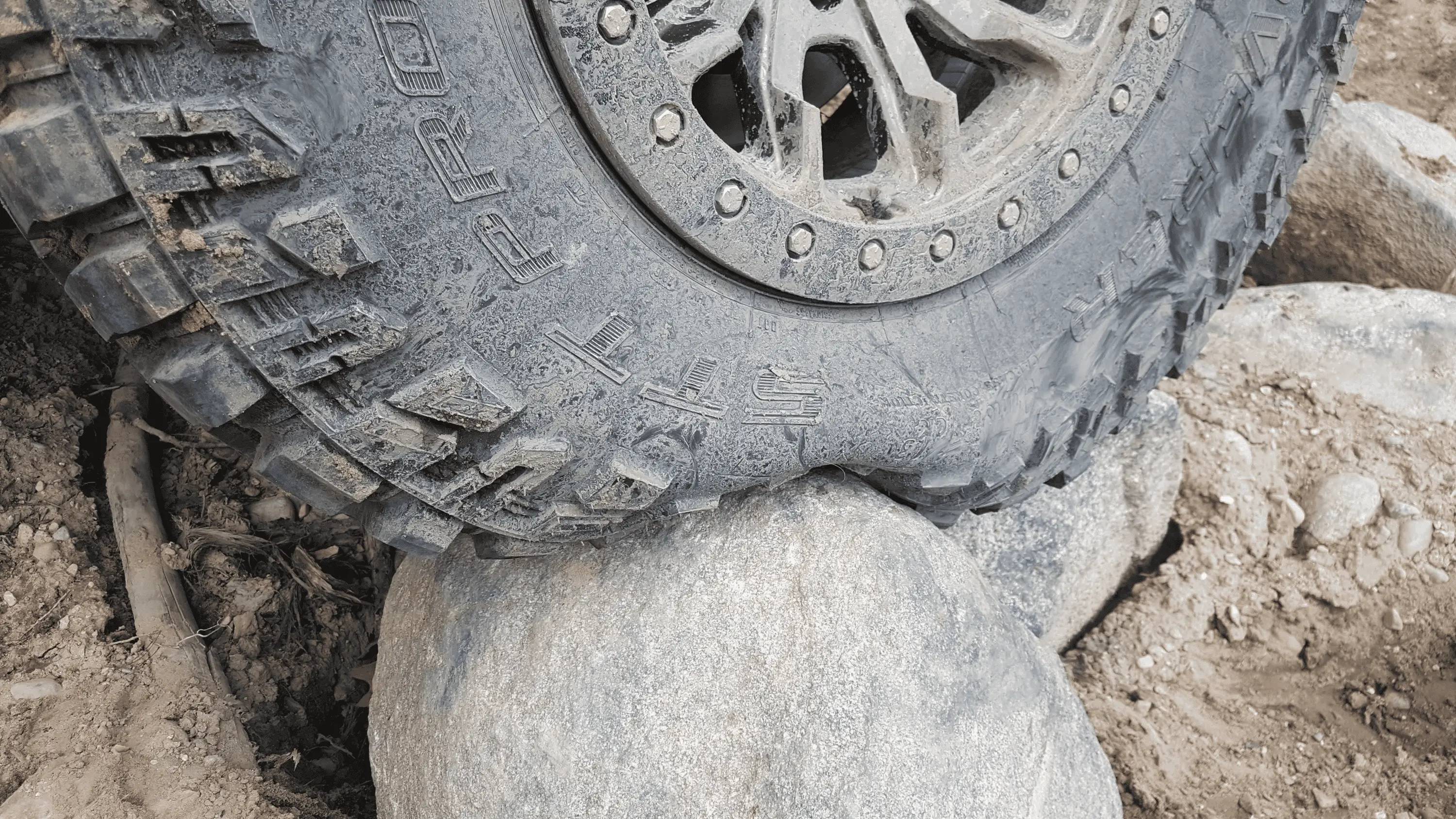

Of course MT tires and lockers all would help. I think you needed to drop down the air pressure. It is way more important than you think. When you air the tire down, it gives the tire the ability to fold over the rock and help lift the Jeep up. Air down tires will wrap around and obstacles instead of spinning on the obstacle. The aired down tire would have conformed to the rock, and created an easier climb with the folded over the rock.
Many look at a few pounds as not that big of a deal when in fact it can be huge. Going from 15 psi to 10 psi is a 33% drop in pressure. and then every pound under 10 psi is 10%. Everyone thinks its about the contact patch, and of course it is, but it is also about letting the tire flex and conform.
Like this...
This is what a tire conforming to the obstacle looks like. It will fold, mold to the obstacle and be able to lift and get traction where as a more inflated tire will not grip and spin easier.

Absolutely true. Thank you for the input.
