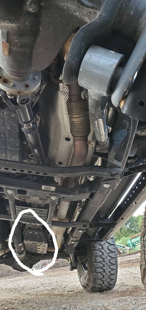

As @Ratbert said first confirm that you do not have a 48 volt etorque secondary battery under the vehicle rather than the small secondary 12 volt auxillary batttery in the passenger fender area. Perhaps you already know what you have, but people have done the work to get to the 12 volt auxillary battery holder only to discover it’s empty because they have the etorque battery, Take a quick look under the vehicle. Here’s a couple of pics of what you’re looking for.

In regards to the 48 Volt Aux ESS Battery, that is supposed to be a 7 year battery. It is a Lithium battery. I'm not sure what is the factory warranty for this battery. It may be just covered on the bumper-to-bumper warranty.
Yes good info…I should have said the 48 volt etorque battery is a factory warrantied battery that should be serviced by a factory authorized tech.
