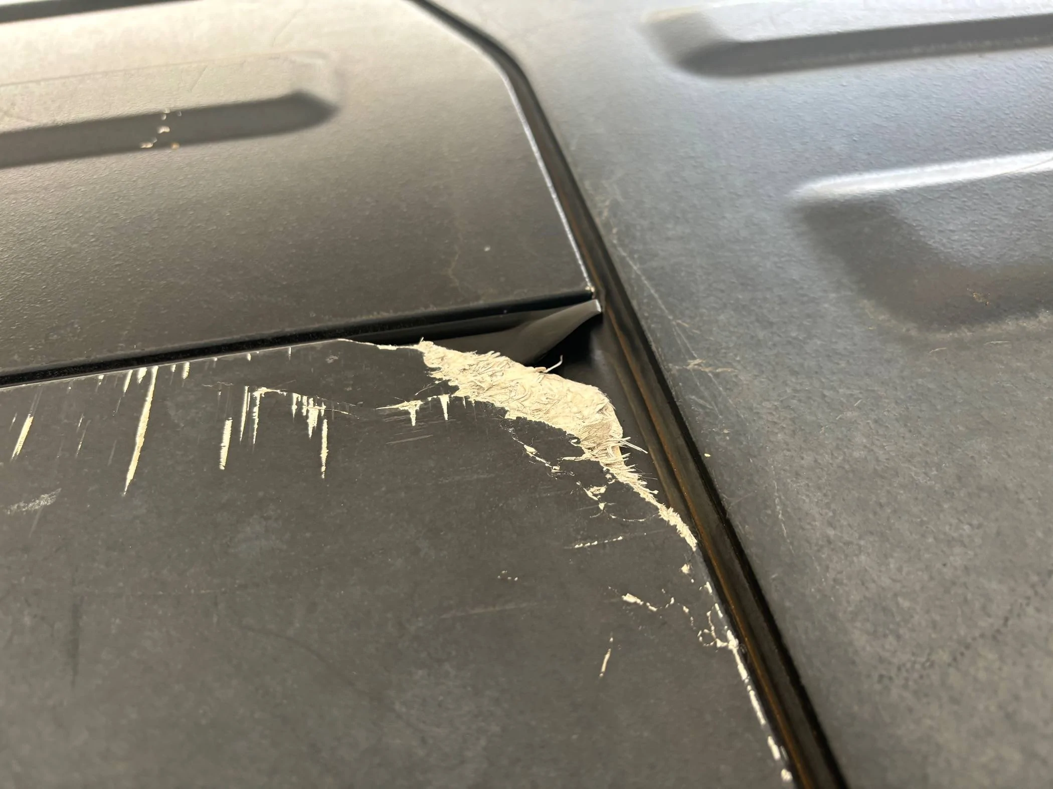

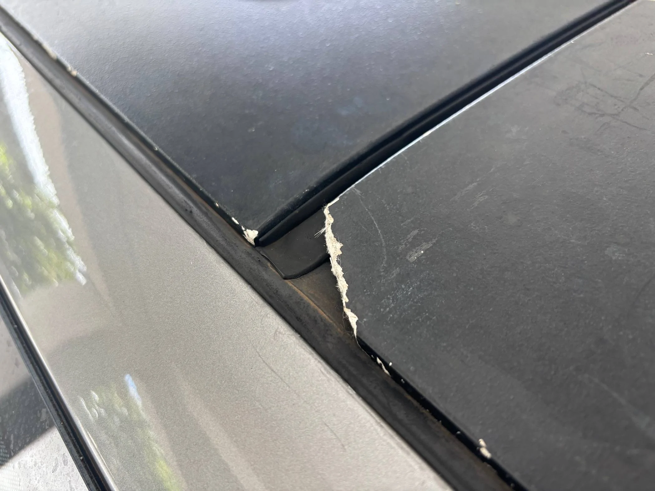

I’ve seen a few threads of people repairing their hardtops where the fiberglass is all intact, just broken/separated. Has anyone tried to repair a freedom panel with corner pieces missing entirely? The inner front and rear corners of my drivers side freedom panel are completely gone at this point.
There’s no water leaking in, but the wind noise isn’t ideal and this damage can’t be good long-term…

Maybe take it to a small surfboard or boat repair shop and see what they think. But inquiring minds want to hear the story on this damage.
Surfboard repair shop is a really good idea, hopefully the cost will be under $100…
My best guess as to how they were damaged is that someone dropped them. I guess this comes with the territory of buying a used rental jeep

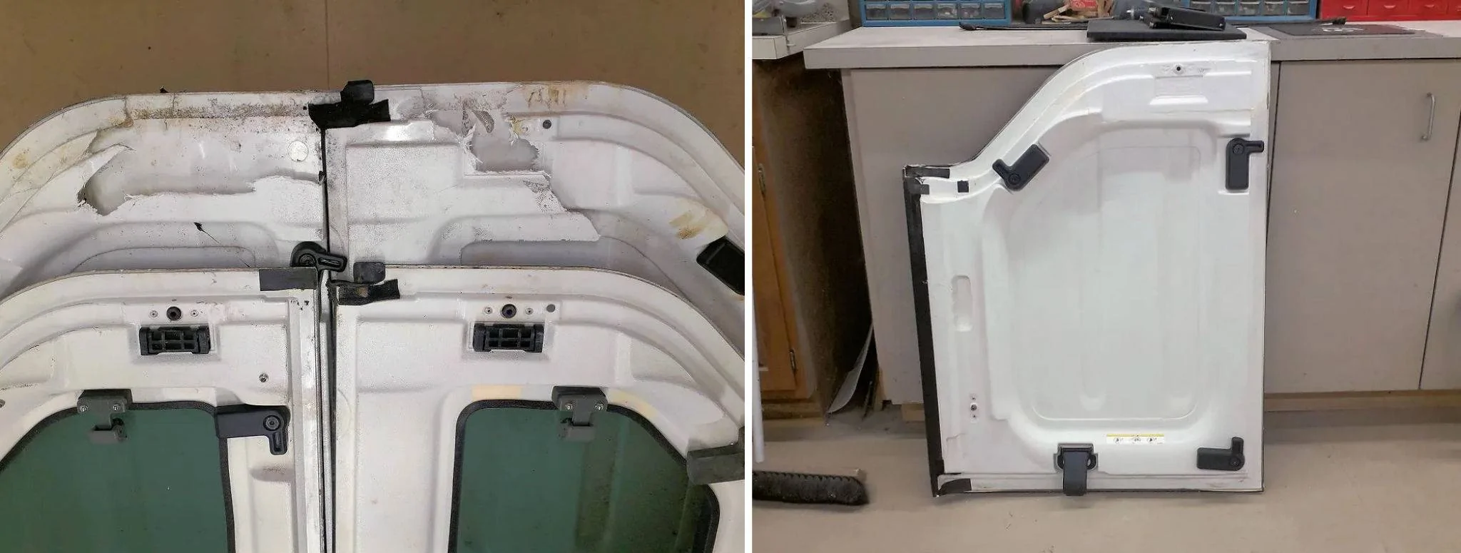

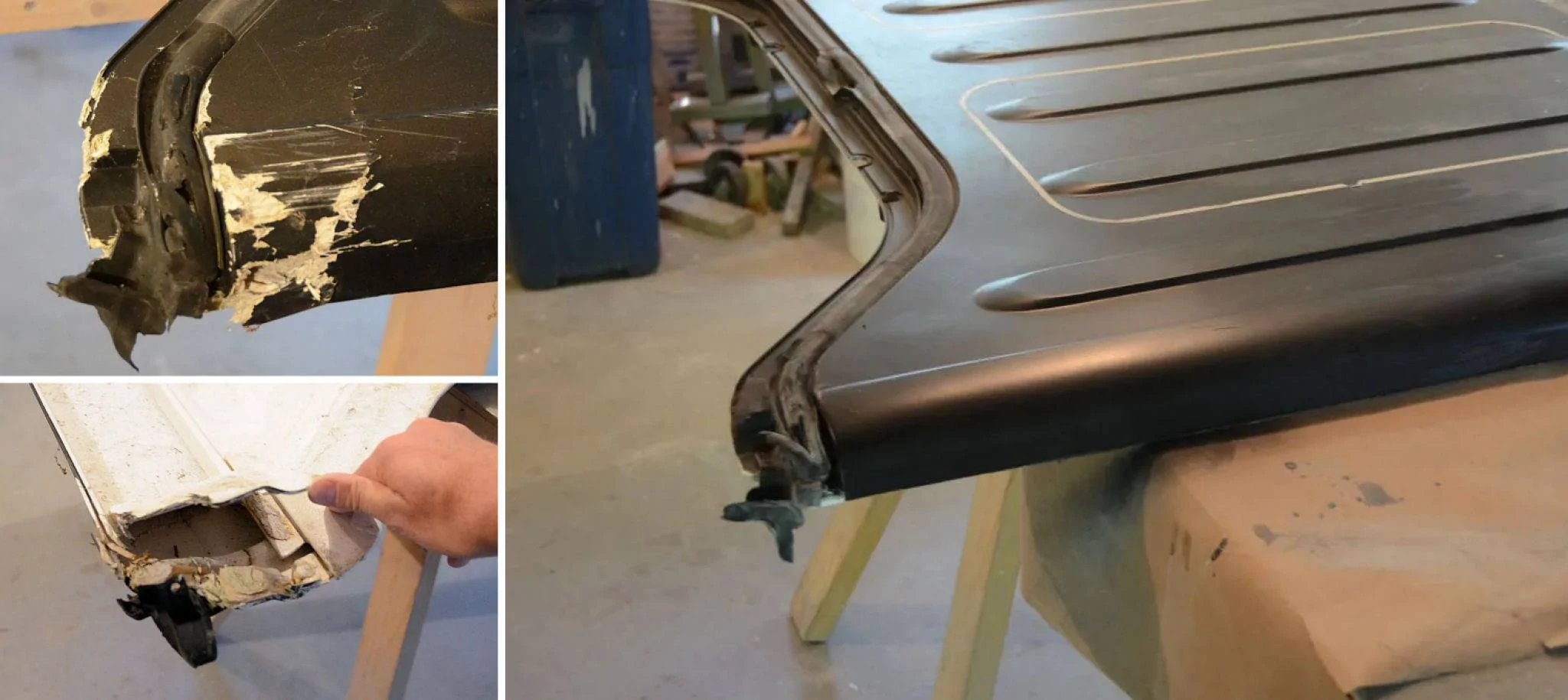

Pretty much anything made of fiberglass or fiberglass variants like the SMC the factory hardtops are made of is repairable, even if pieces are missing. Here are two examples of repairs...
This first pair of photos shows a hardtop that someone had dropped on its corner, which cracked the inner and outer skins and separated them. Nothing was missing, but both inner and outer skins were cracked pretty badly. The right photo shows the hardtop after being repaired:
Jeep Wrangler JL Repairing Hardtop Damage? HardtopRepair1
And speaking of pieces missing entirely...
This next pair of Freedom Panels were in a bad accident and large chunks of the rear side of the inner skins were missing. The left photo compares the damaged panels (top) to undamaged ones, you can see what's missing. (BTW if you look closely at the undamaged panels they've been modified to have pop-up skylights, but that's another story). The right photo shows one of the two panels after being repaired, you can see that the missing section has been replaced:
Jeep Wrangler JL Repairing Hardtop Damage? FreedomPanelRepairs
With more detailed photos of the damaged Freedom Panel (both inside and outside) I can offer suggestions on how to do a repair.
