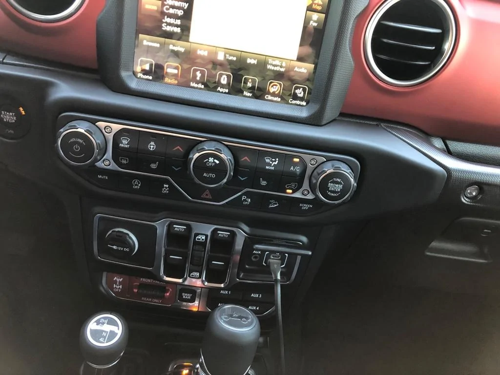

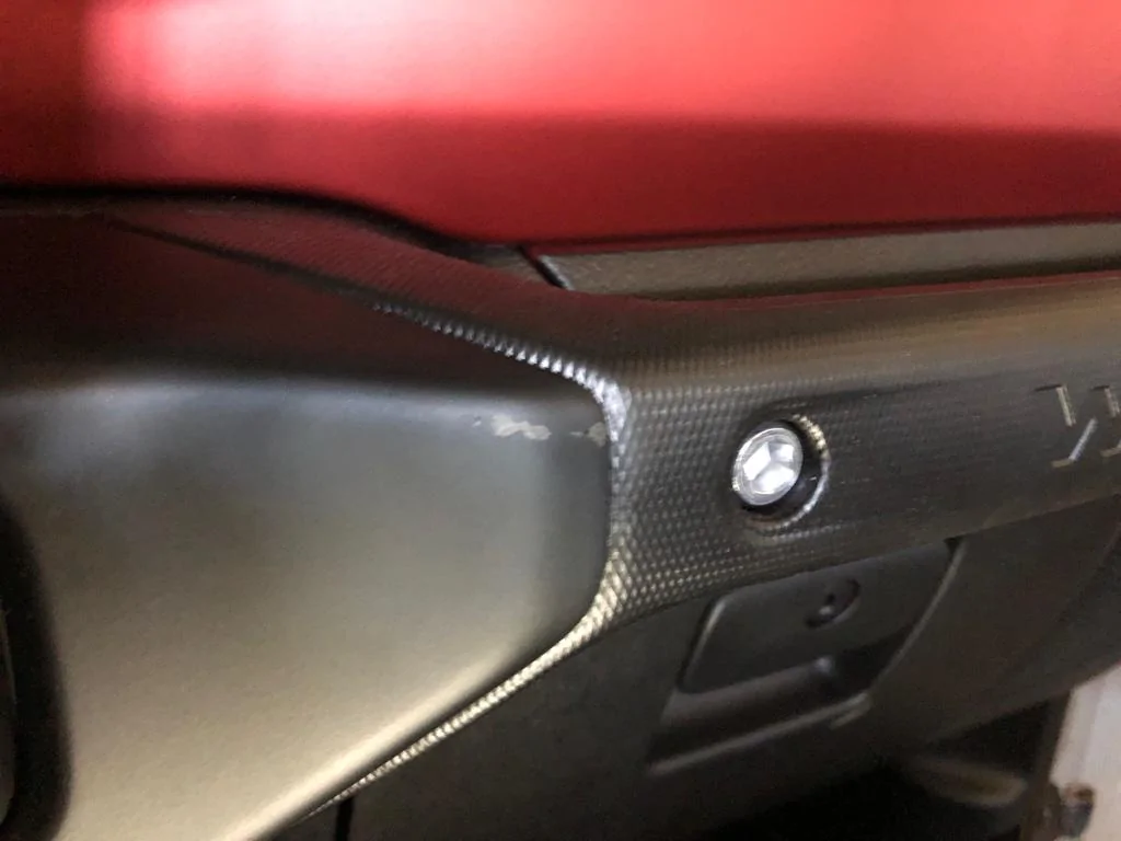

Hey Team, I thought my best bet was was to ask JLWF detail guys & gals. I noticed this damage to the dash plastic dash panel just to the left the rugged rubberized grab handle. The texture is a soft grippy black plastic with a slightly soft rubbery sheen to it. I cannot figure out the best way to repair this, any suggestions or know of where I can order a replacement panel? Is it hard to replace/remove? I would hate to just live with it since it is in prominent eyesight. Also, i fear that now that the damage has started it will expand and more areas are going to come off.

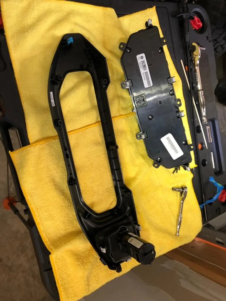

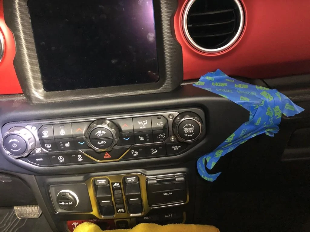

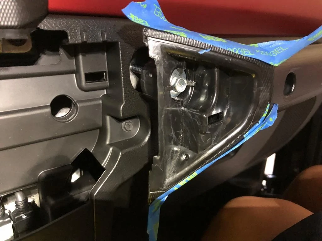

All done. The only difficult thing was that it was in the middle of this heat wave in a hot garage.

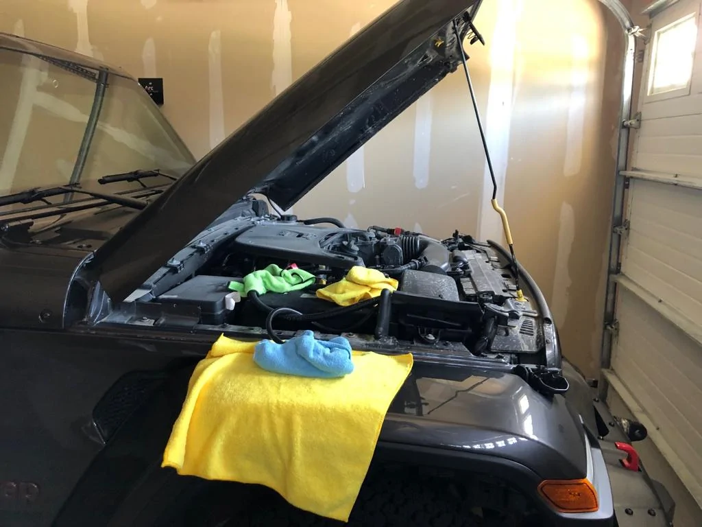

1. Disconnect battery (wasn't sure if I needed to do this for just the HVAC and the ignition button but played it safe
2. Removed per @ShockerRacing video
3. I lost a clip in the tiny hole and some ingenuity fished it out the back
4. Removed the old trim from the ignition switch and the HVAC cluster -> use original hardware and placed on new trim
5. Push back on, good as new
