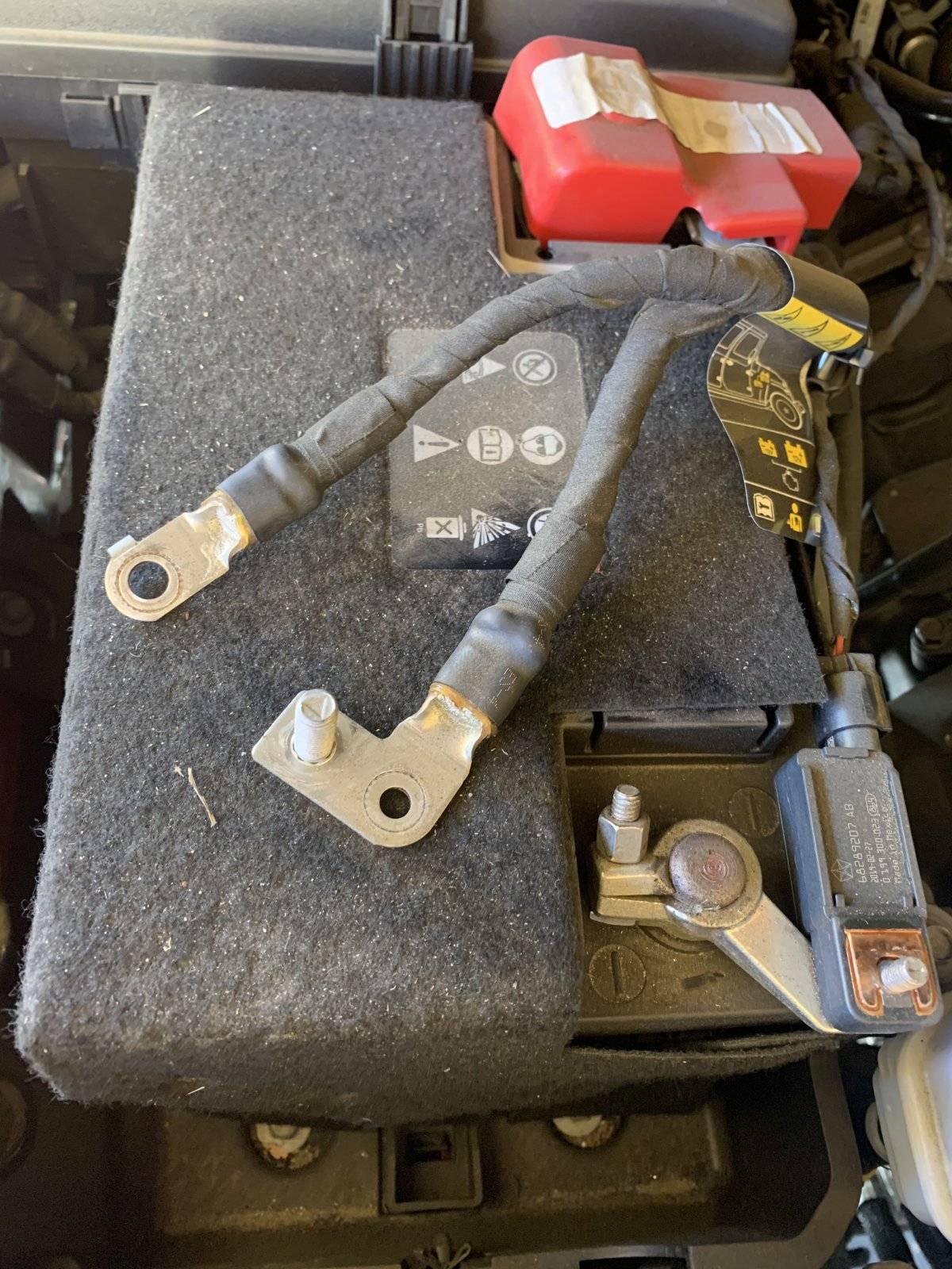

So it’s supposed to look like the last pic after everything is done? Isn’t it still connected though? Since the red positive is also connected. Which is confusing. Since wouldn’t it still get power? Thanks.
Yes.
Without the negative/ground connected, nothing will be powered.

I just followed the instructions as shown in the picture. Should I be all set to start working on removing the wheel? Thank you so much for the help!

Should be good to go. Just be sure to keep the negative leads from touching each other or the negative terminal on the battery.
