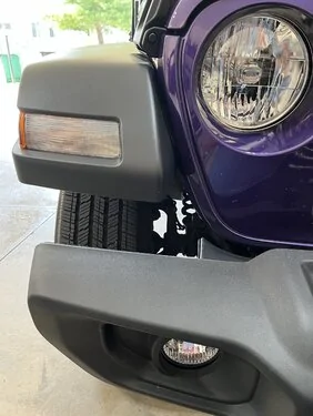

I trimmed them on mine and my wife's. I removed the nutserts on my bumper and reinstalled them with pushpins because the screws are waaaaay too long. When I did my wife's, I borrowed my son's 1/4" drive electric Milwaukee ratchet and put it back together with the OEM screws. I gotta buy one for myself for Xmas, it's a great tool.
Jeep Wrangler JL Removing splash guards from plastic sport front bumper question. IMG_6648.JPG
Jeep Wrangler JL Removing splash guards from plastic sport front bumper question. IMG_6650.JPG
And @gl420 is correct, the fog light wiring is exposed on the OEM steel bumper.

that looks clean good job Im gonna see if i can come close to yours lol

The Fixer !!!!
got mine done today your pics basically gave me the "where to cut" thanks a ton!

That's great! Happy to help!

I left my wiring exposed, but that looks good, you left a smaller profile than others I have seen.

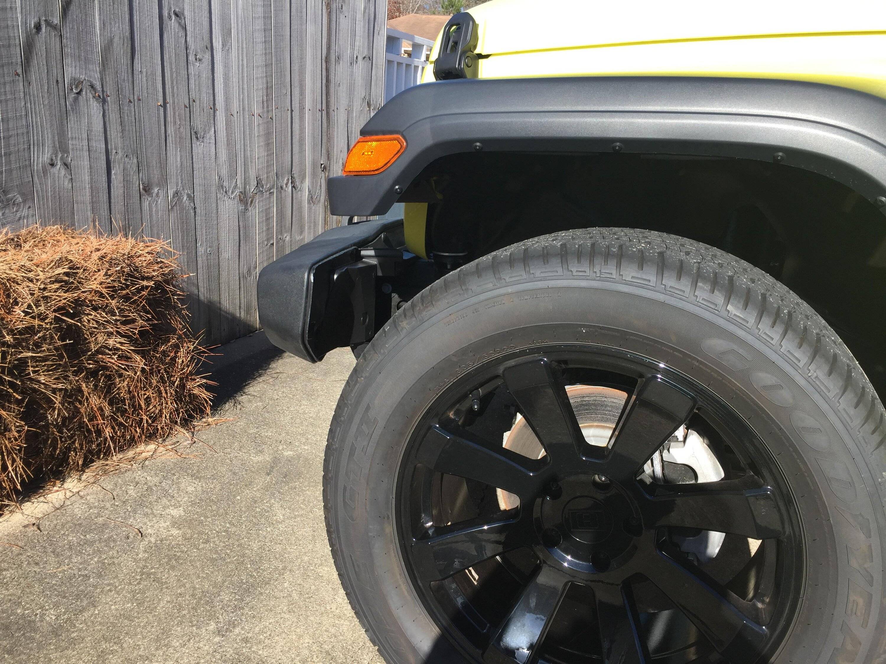

I left mine to cover the wiring. Turned out pretty good, almost forgot I ever had those stupid things :)

Felt weird cutting up somthing off a new car lol
Haha, you get used to it quick! Looks great, you did a nice clean job!
Thanks!
