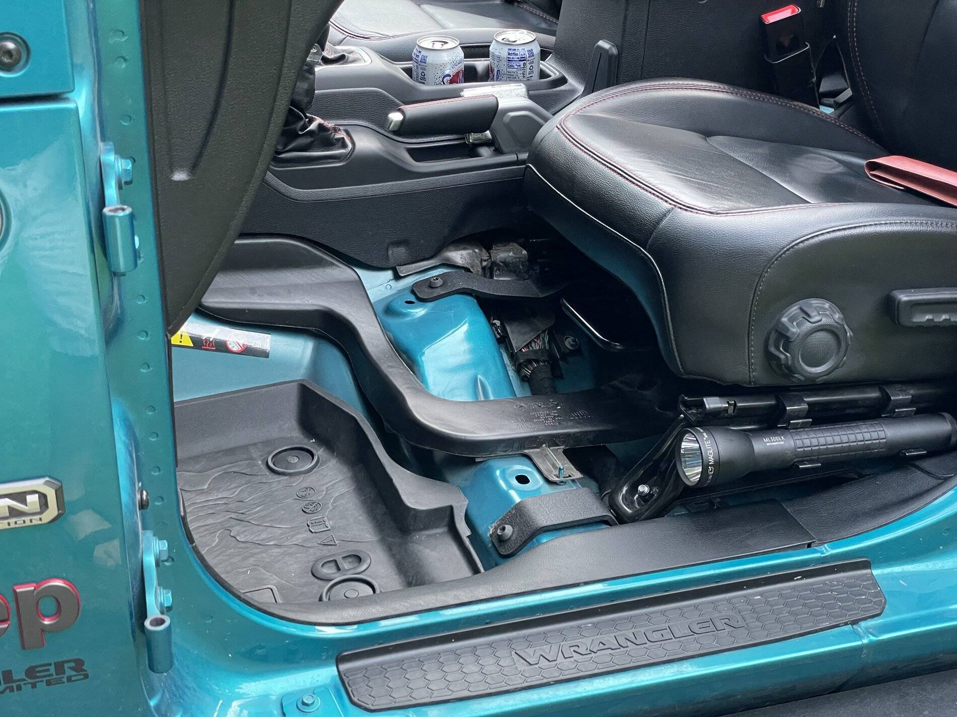

I took mine out a couple weeks ago because I was hoping to do some water crossings and I thought it would be easier to put in my Misch 4x4 Big Boy seat extender.
A couple things; while the floor pan is painted it’s not the beautiful, several layers, and clear coated finish of the Jeep proper. Kind of dull.
Also there are wires all over under the seats that will be exposed.
in the fall I’ll hose the heck out of the carpet, let it dry, then put it back in.
