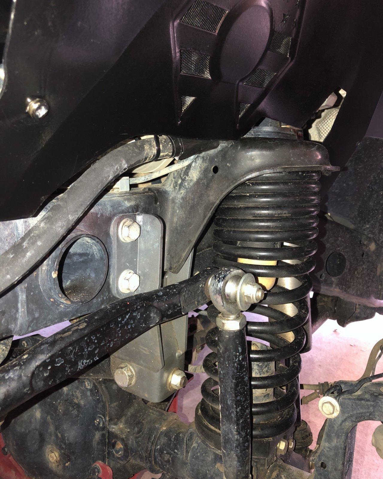

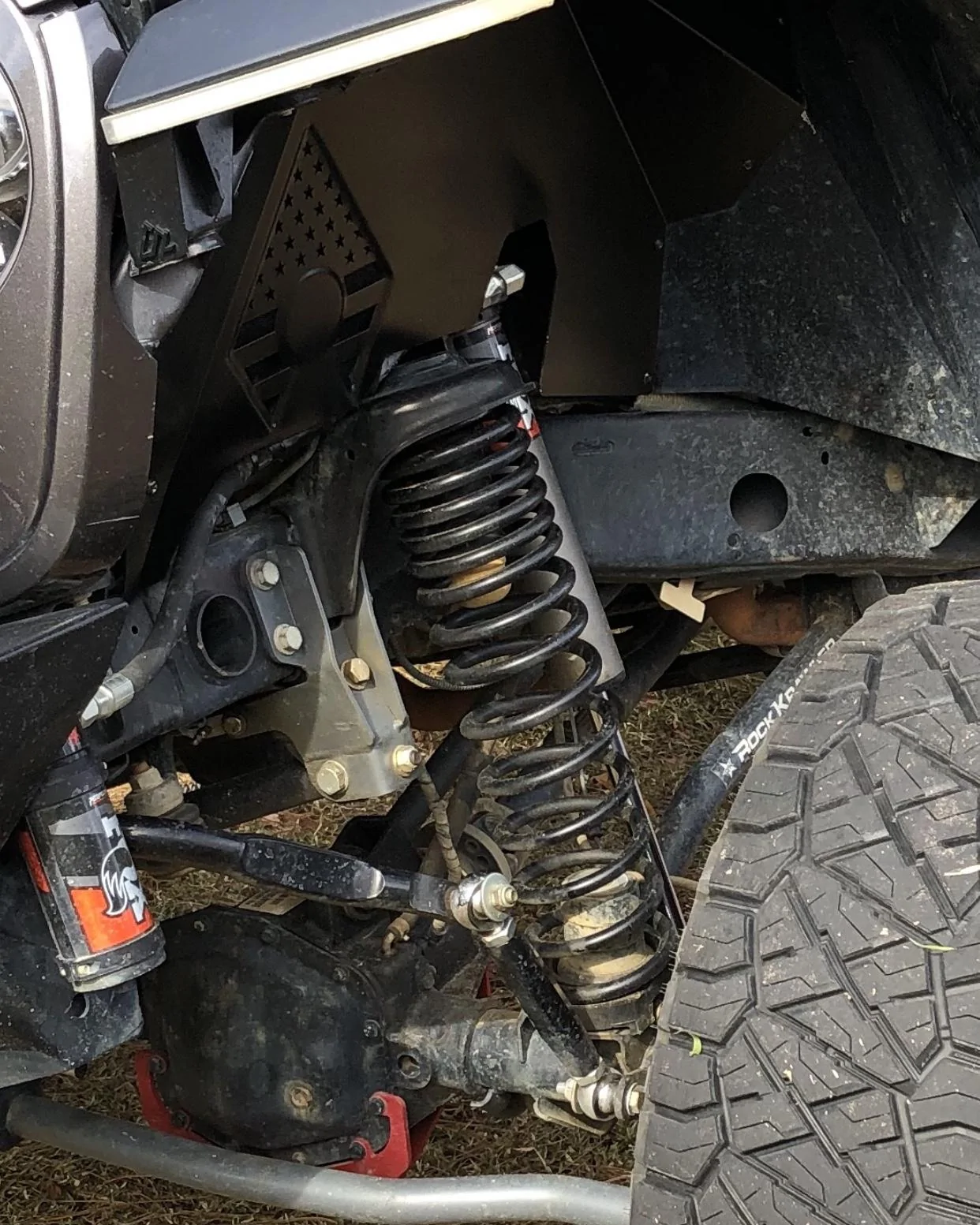

The shorter ones are 7” between the jam nuts. My shocks are at 31” extended and I’m adjusted to 10-3/4” eye to eye. Assuming yours droops a little more with the 6 pks, I’d say you’d be good at 11.5”.
Fully stuffed I was hitting inner fender, but that was mostly because I shimmed them out to not rub on resi hose. I’ve since notched for hose, no more issues. Also I turned the bolt around on the top to get a little extra clearance.
Your gonna love these , there is essentially no difference in droop hooked to the sway bar or unhooked. Here’s couple pics of ride height, stuffed, and extended.

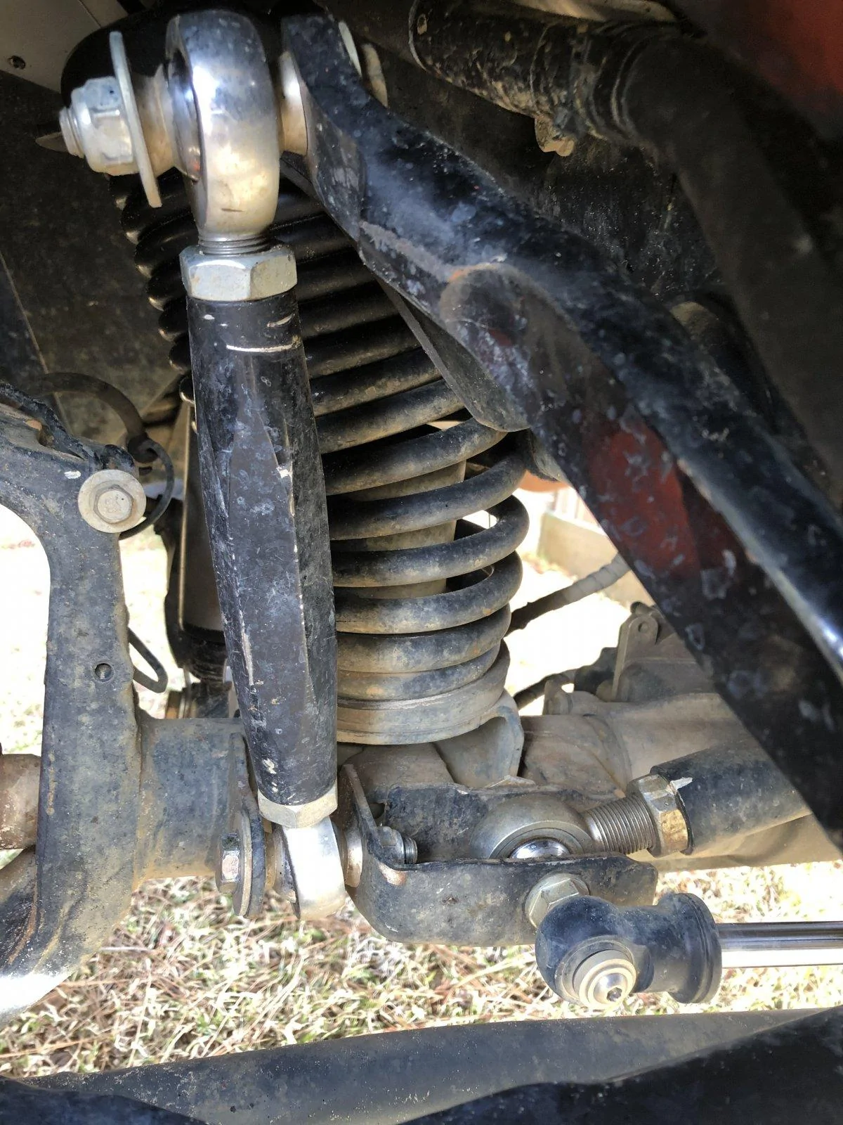

That's where my confusion was. They look like they're more than 1" difference on their product pages. They mention lift heights, but not their own lengths.
I have the smaller 7's, and are extended as far as they'll go before not have enough threads engaged. I could definitely use that extra inch, and it has nothing to do with my being Irish. The flex of the 6-packs is ridiculous. I may even switch to the 4.5" lift coils that Metalcloak is supposedly coming out with. These shocks and the upper relocation brackets make it too easy to unseat the springs.
And, pics as promised.
Edit to add: I measured the total length of my adjustment at roughly bolt centers, which has it at 11.25".
