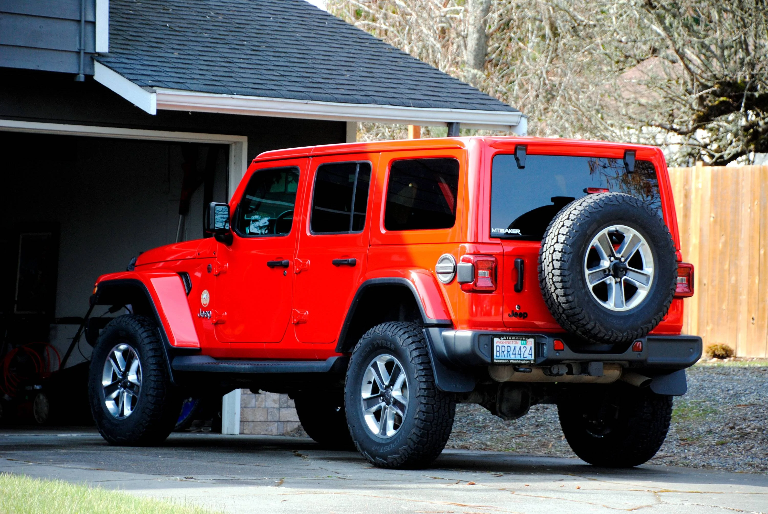

My Sahara runs on 35s; had 4.88 gears put on a year ago. Best decision I ever made.
Just wish Eaton offered a TrueTrac for our Jeeps back then. I’d have had it swapped then, too.
