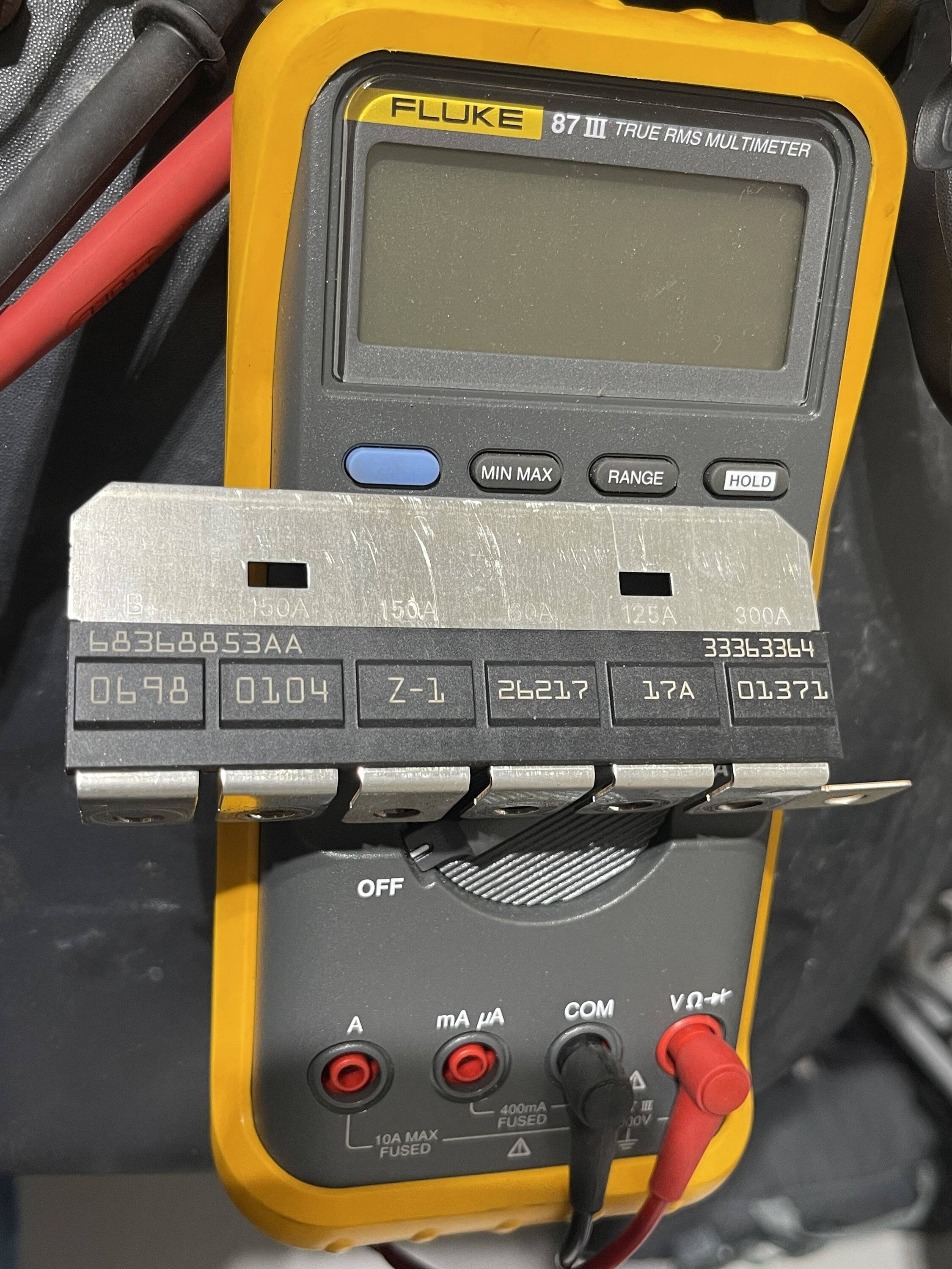

I appreciate the heads up. I’ll actually test the block tomorrow. Looks like a new block is $53. Might be handy just to have on hand in case it just quits on me. (Or swap N3 with N4 to get home).
EDIT: you got me paranoid enough to check it now. I don’t want to get stranded or kill $400 in batteries. All fuses are good.
Good to see a guy that is pro-active.... on top of things..
I keep a spare High Amp Fuse Array in the vehicle at all times.
I see you have a 68368853AA Mopar Z Case Fuse Array (has the 60 amp fan fuse).
JL's with the trailer package have /use a different array that has a 100 amp fan fuse.
Read here: https://www.jlwranglerforums.com/forum/threads/alert-high-amp-fuse-array-related.65085/
After communicating with a few dealership techs and fellow JL owner's, it has become pretty apparent to me, that Stellanits had a problem sourcing fuse arrays for a while and they used 60 amp and not 100 amp on some vehicles leaving the factory that had the tow package and should have had the 100 amp fuse.
Suggest, if yours is one of those, buy a 100 amp, install it and keep the 60 for your spare.
