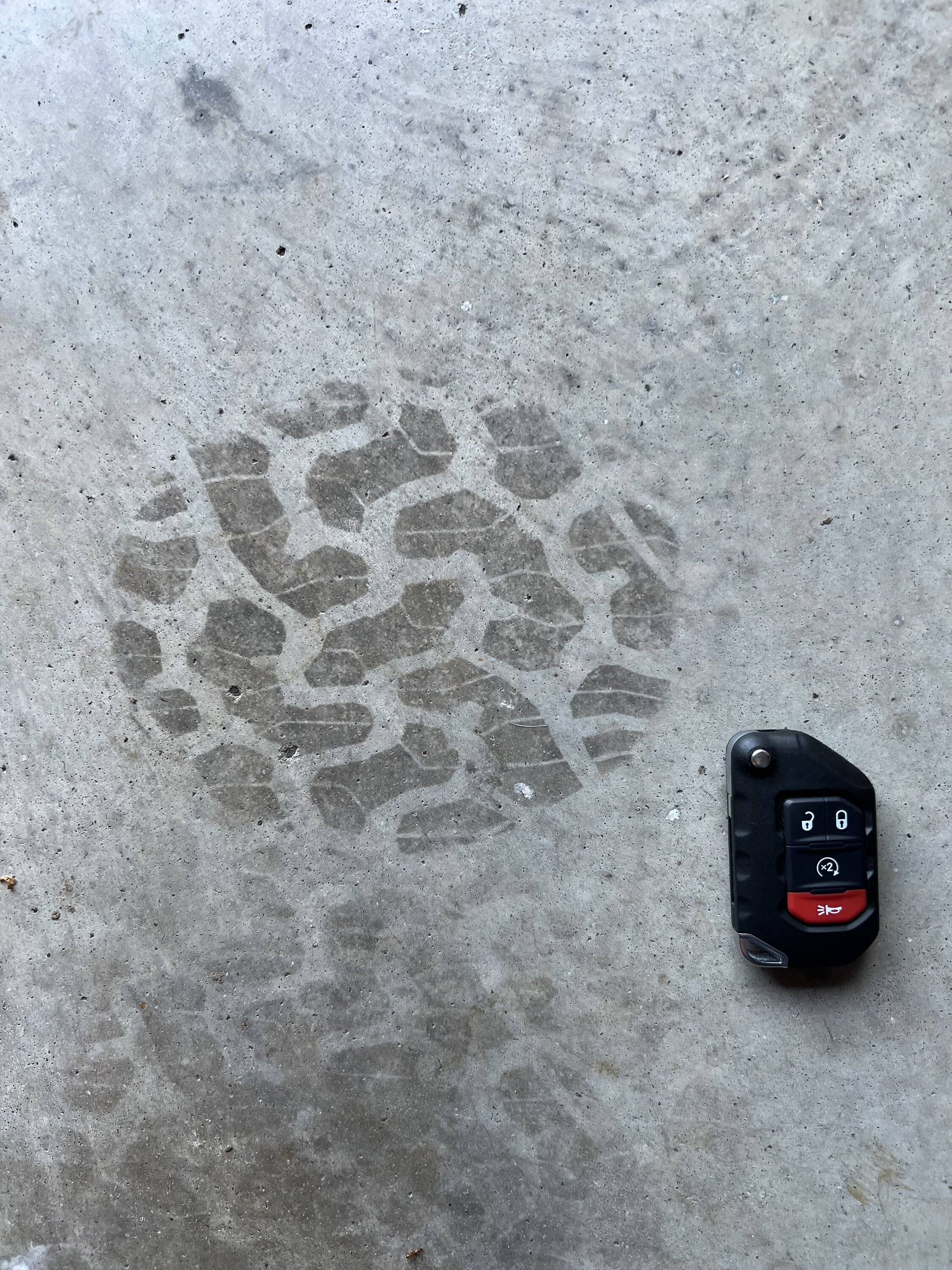

This is the contact footprint for the driver rear BFG KO2 at 37psi on a Rubicon Diesel weighed on a CAT scale as per below
