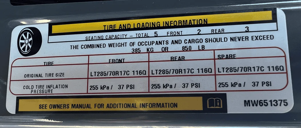

I put some KO2's on Willy's wheels on my Sahara. Was wondering if anyone has a pic of the recommended tire pressure from a Rubicon.
The tires are 285/70/17 KO2's. Discount tire filled them to like 48psi, but I think that is way to high - anyone have a pic of the tire badge from a vehicle that has KO2's from the factory?
I checked in the manual and it is not there unless I missed it. Thanks in advance!
I run 37 psi, other's run less.

37 is what the Rubicon spec is and the factory knows what they’re doing. I run that whenever I’m not aired down. There’s more wear on the edges than the tread center even so, although that’s probably all the twisty CO roads. I corner somewhat quickly.
Ford also knew what they were saying when they recommended 26 psi with Firestone equipped Explorers.
We all know how that turned out.
Do a chalk test and never run above or below the tire manufacturers suggested pressures.
