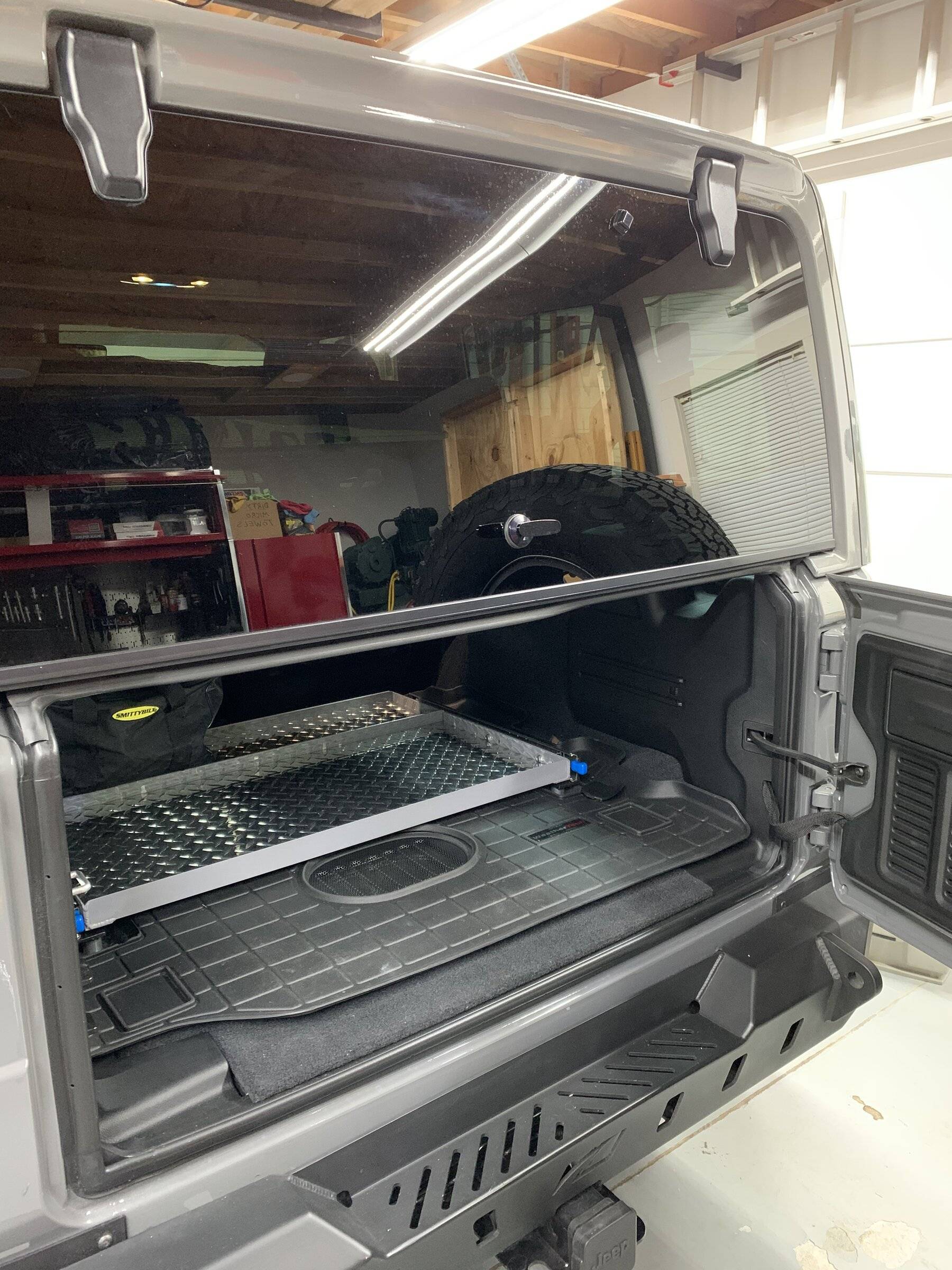

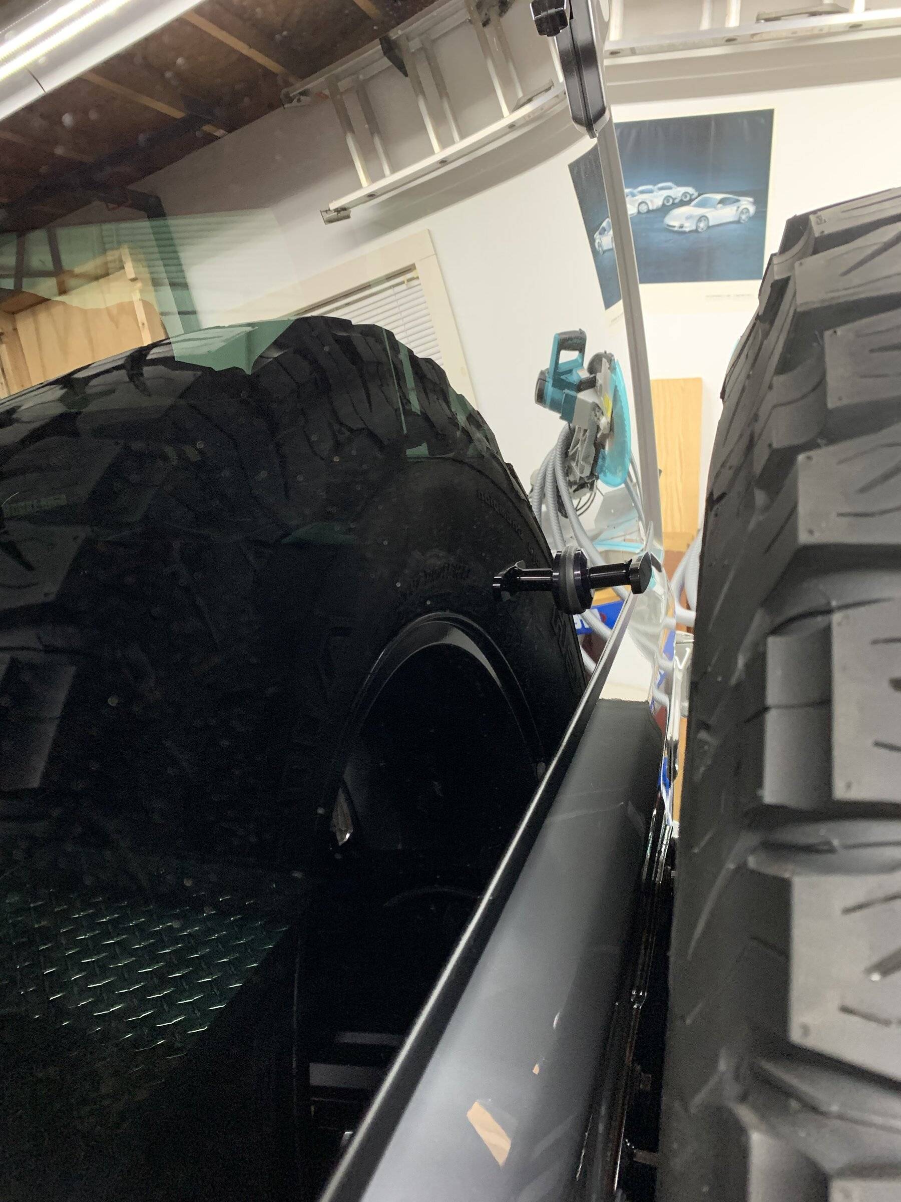

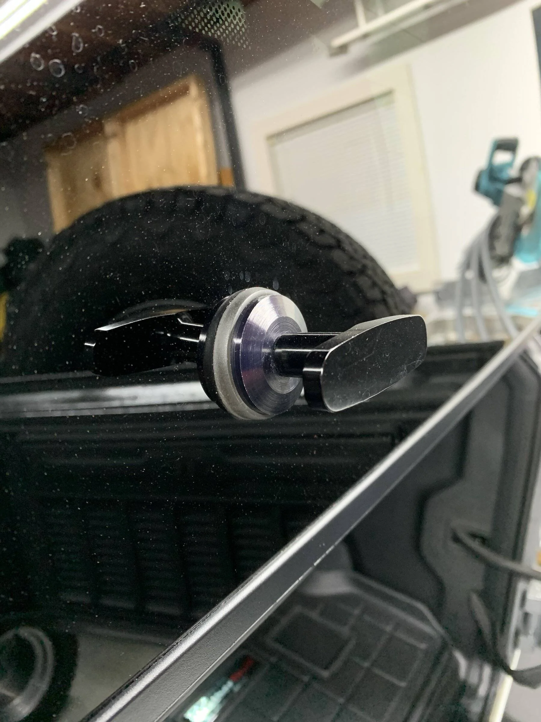

Remove wiper motor and cover ends of wires with either heat shrink or electrical tape. Zip tie to keep wire from moving around. I think I re-used the rubber grommet, installed stringer washer with T handle, cut some rubber hose ( pieces had lying around ) installed expanding rubber nut sert then on the inside a fender washer and nut. All of this was what I had lying around my shop. The rubber hose and the expanding nut sert was used to take up the space of the large I.d. of the rubber grommet and to keep everything centered. Just being creative here. All you really need is something to fill the i.d. of the rubber grommet with a hole for the t handle rod and the fender washer and nut on the inside. I also disconnected the plug inside as nothing will be needed for powering anything on the rear glass. I also do not need the heated rear window. Good luck. This was fun for me.

Remove wiper motor and cover ends of wires with either heat shrink or electrical tape. Zip tie to keep wire from moving around. I think I re-used the rubber grommet, installed stringer washer with T handle, cut some rubber hose ( pieces had lying around ) installed expanding rubber nut sert then on the inside a fender washer and nut. All of this was what I had lying around my shop. The rubber hose and the expanding nut sert was used to take up the space of the large I.d. of the rubber grommet and to keep everything centered. Just being creative here. All you really need is something to fill the i.d. of the rubber grommet with a hole for the t handle rod and the fender washer and nut on the inside. I also disconnected the plug inside as nothing will be needed for powering anything on the rear glass. I also do not need the heated rear window. Good luck. This was fun for me. Rear window wipers are just plain ugly and useless.
