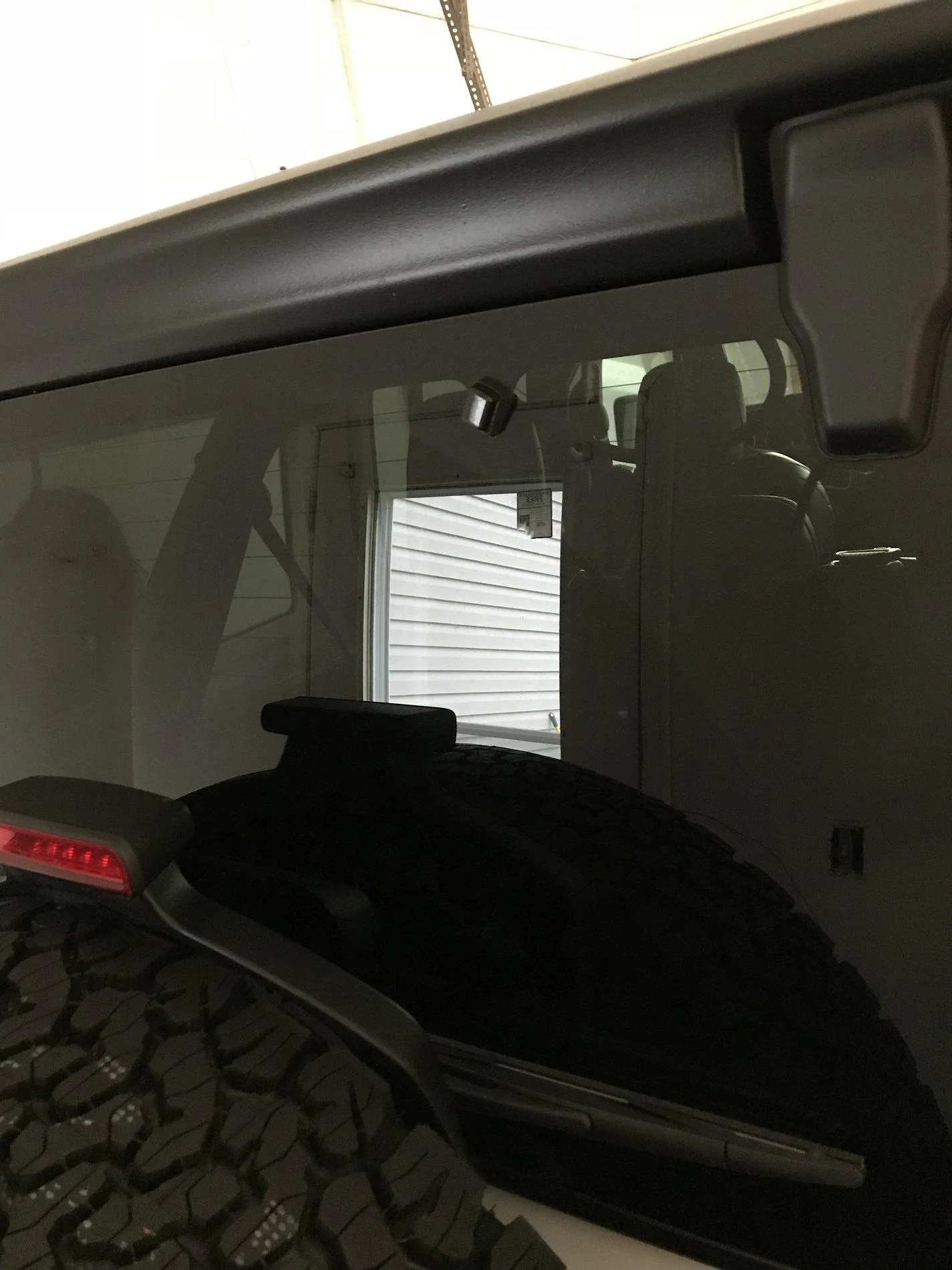

Add me to the list as well, JLUR. Makes a nasty mess on the glass that really bakes on and is hard to remove.

I have good news everyone, drilling a hole in the washer fluid tank lid solved my leaking rear washer nozzle. I also noticed the lid hasn’t popped open anymore either most likely due to not having the pressure built up in the tank. It’s been a week but I will continue to monitor the situation and report back if it starts leaking again.

Checked my washer fluid reservoir under the hood and the cap was ajar and not snapped on so I'm wondering if the pressure built up as stated earlier and popped the cap and now maybe it won't drip down the glass? I'll see if that works, if so I'll vent the cap like someone did earlier.

I will pm @JeepCares with my info, I went to drill the cap on the tank and found it off so was thinking maybe if I just left if loose no pressure will build up in it but it needs to be addressed, my buggy is a daily driver and I am pretty OCD on things being perfect so after it gets washed and a quick detail wax once a week it’s pretty annootying to have those dribbles down the back window
