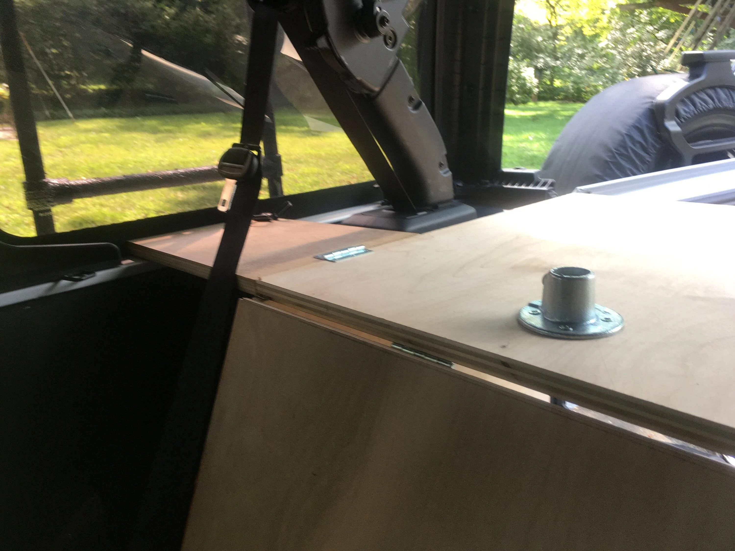

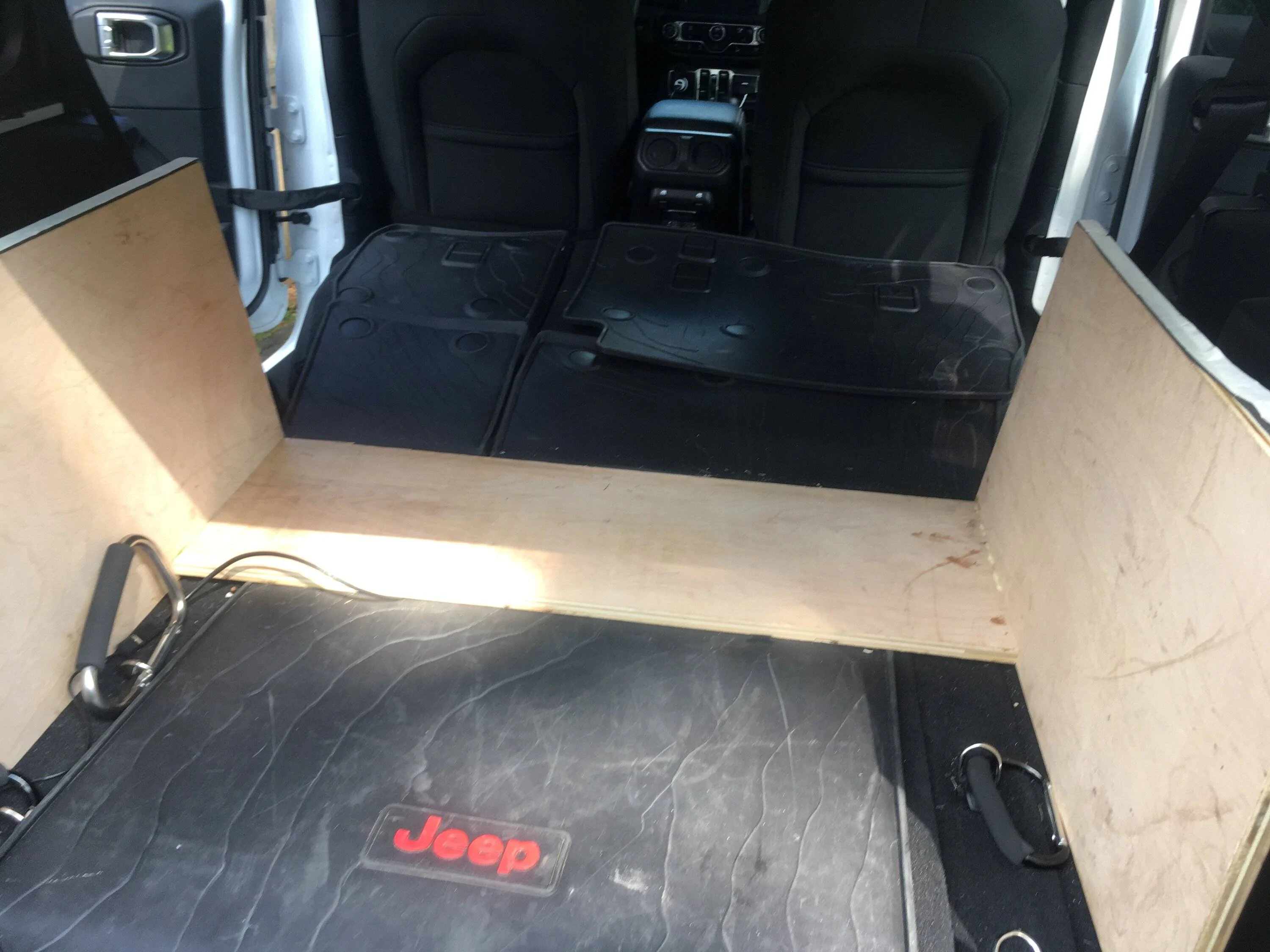

My platform, as I hope the selection of pictures I provided show, is supported both by a box like structure from below (whose size you can increase where it interfaces with the floor of the cargo area if you seek to add slide out drawers) and its connection to the cargo tub's lip's hard top secure down points.

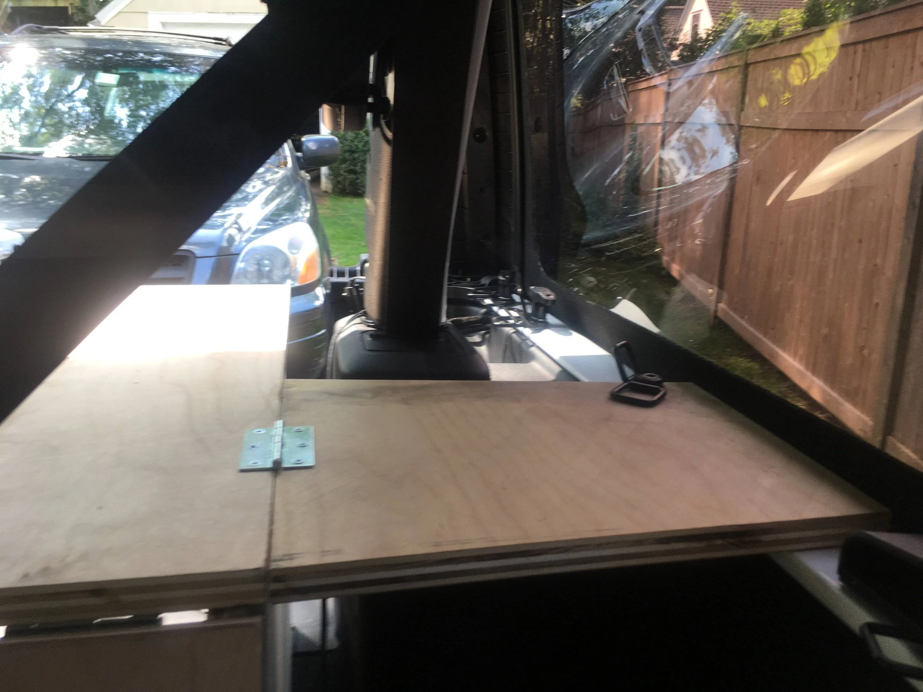

Those hinges that connect the wings.....they're connected to the platform not with wood screws but bolts that screw into threaded inserts that make removal of their hinges easy. As you can appreciate, its impossible to install a platform as wide and deep as the tub without the sports bars getting in the way. When the wings that I thought would address this also would not fold down (because of the sports bars again) the easiest solution was to come up with a way to remove the hinges each time I wish to place in or remove the platform without stripping out the wood platform holes which accept the hinges.
The hinged area behind the back seats (not the wings) is designed to fold up with those seats down, to make a platform (which additional construction not shown) in the entire area behind the front seats.
Please add tiedown points on whatever secured platform you devise to harness in your furry friends.
