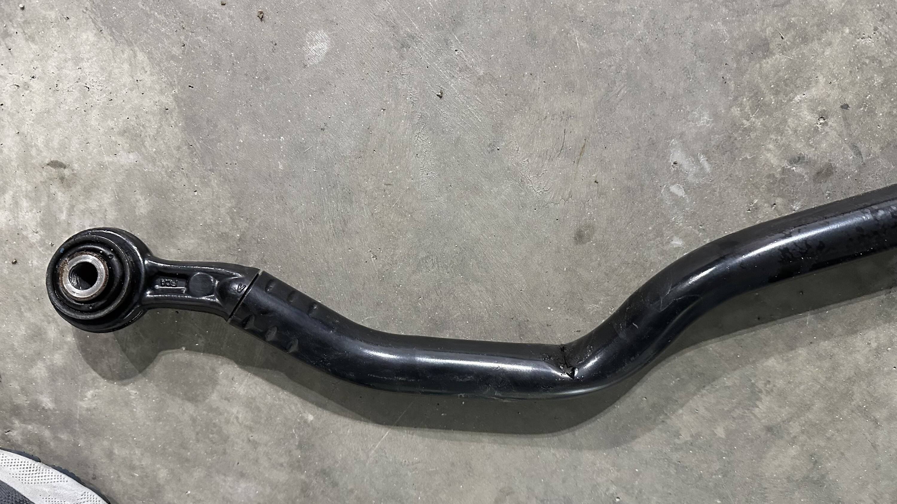

Update: I just tore into it and the rear track bar appears to have saved everything else. I would think if it bent the axle I'd see wobble on the brake rotor, but it seems to rotate pretty true. All in all he was pretty lucky and this could have been a lot worse.
I will probably replace the rear track bar with an adjustable one, as they aren't that much more expensive than stock.

Check the rear track bar bracket for cracks as well. When I had my 2019, I got t-boned back in 2021. The truck hit my drivers side rear wheel and it sheared off the track bar bracket.

Thanks for the heads up. I just took a good look at it, and fortunately it appears fine. I also looked over as many other mounting points as I could see and all look ok. I’m hoping the track bar sacrificed itself to save others!

I slid off a rock and into the side of another on a wheeling trip and folded my rear trackbar the exact same way, but had the same result. It took one for the team and everything else was fine.

This is interesting, and it makes me think an ultra-strong track bar might not be a great idea. Sacrificing the track bar is a whole lot easier repair than anything else damaged along the way.
