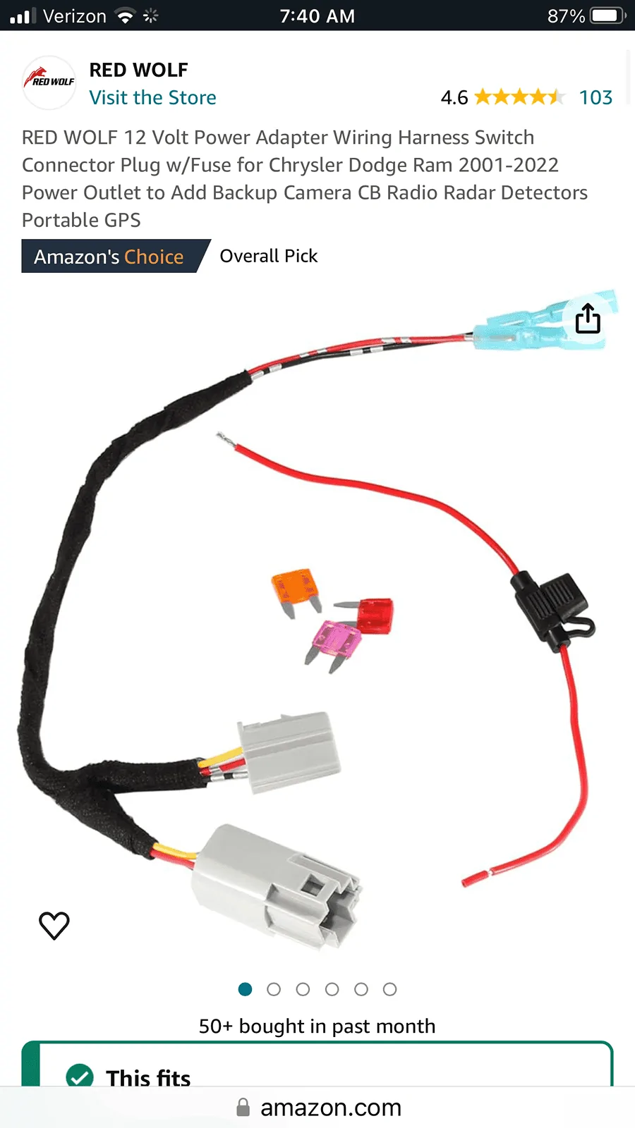

i don’t, sorry. i think most take from the dash 12v outlet or the one in the trunk. i think one is battery and the other is keyed as per the diagrams on their covers. also to note is that i believe there is a pretty cheap amazon product that serves as a splitter - you unplug the outlet and plug it back into the splitter and then you have a free end to connect to whatever you want to power. i’m sure someone else can explain this better, lol
