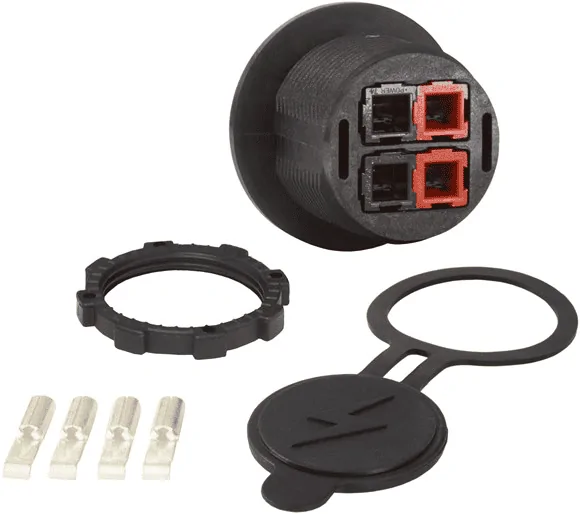

That's what I was thinking. What kind of connectors would work best for this? The compressor has alligator clamps that clamp to the battery. I know they could be removed/ swapped out, just tryingt to plan this out in my head.

If you want to use Aux 1 or 2 you can just run an 8 gauge wire from the passenger footwell to the back by tucking it under the edge of the trim. Remove the trim piece at the curve on the passenger door and you will find a ground stud you can use for the ground. You can fish the wires out thru a small carpet slit on either passenger or driver side. Those WAGO connectors (amazon) work really nice for connections you might be changing later.

Updated on this: I went through the trouble of ordering all the parts but my compressor wouldn't fill my 4 way tire inflation system so I ended up spending the $$$ on an ARB Twin (knock off) from Amazon, wiring it in to the battery, and tying the switch wiring to Aux 2 (40 amp fuse). Details in my build thread.
