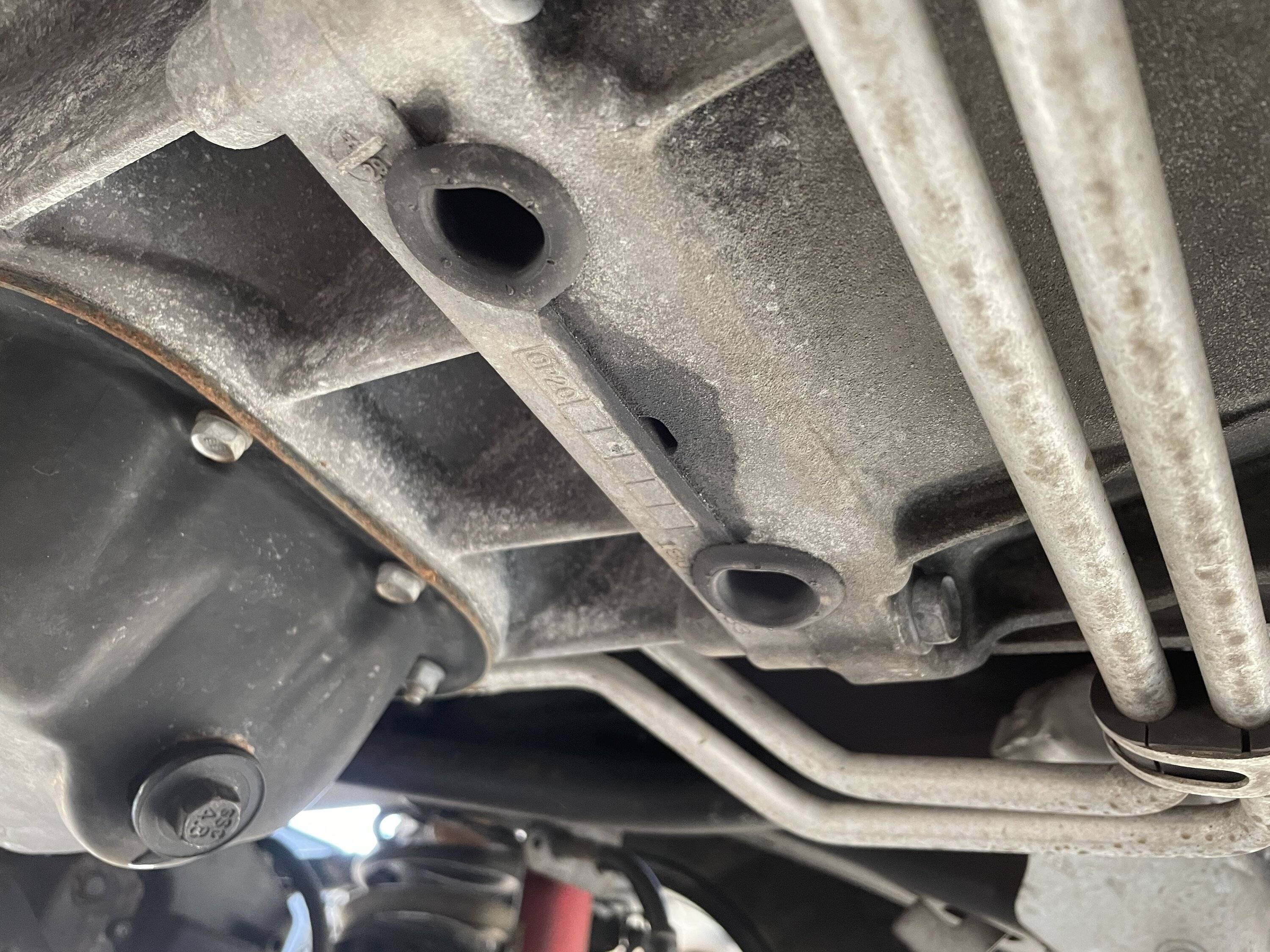

I need the experience and help of the jeep community to tell me if what I’m seeing is a rear main seal leak or not. At the same time I did notice that it appears that my oil filter housing may be leaking as well. Not sure if it related. Anyone seen anything similar to this?

That could be a rear main seal, but could also be the upper oil pan. Oil filter housing leak would more likely be visible towards the top of the engine, such as on the valve covers.

Thanks, upper oil pan? Is there another layer up there? Also, is there any easy way to inspect the rear main seal? This is a 3.6 Auto.

Oh yeah, the section above the smaller black pan is notorious for leaking into the bell housing, too. If that's the case, draining the oil, pulling the pan, and resealing it with RTV will do the trick.
Unfortunately, there isn't an easy way to see specifically what's leaking when it's inside like that. You can pull one of those rubber plugs and feed a snake camera in there, but unless you get lucky, all that's really going to do is confirm there IS a leak, not so much what is leaking.

I think I can manage that as is it seems pretty straightforward. I’ll add it to the list. At 48k miles not pleased that this engine is having these issues. You would hope at the point Jeep would have figured their stuff out. There are guys here in the forum with this issue at 5k miles… absurd.

If you can manage the oil pan, I'd start there on your next oil change and see if that helps. If not, then you know it's the rear main seal.

I was recently having a conversation with my mechanic in this vein. IIRC, what he said is that the oil filter housing is fairly common to develop a leak. And when it does, it runs downhill until it where it drops out, it gives every appearance of being a rear main seal leak.
So, the fact that it looks like your oil filter housing is leaking makes it pretty unlikely that you're simultaneously experiencing a rear main seal leak.
Oil filter housing is a much easier repair.

That’s good news, I know it’s a pain to swap the oil filter housing but now with the after market aluminum housing I think it’s worth it. With that fixed I could wait until the next oil change and see if that oil stain got worse or not.
Again, why has jeep continued with this plastic design? JKs had the same problem and they kept essentially the same housing for the JL.
