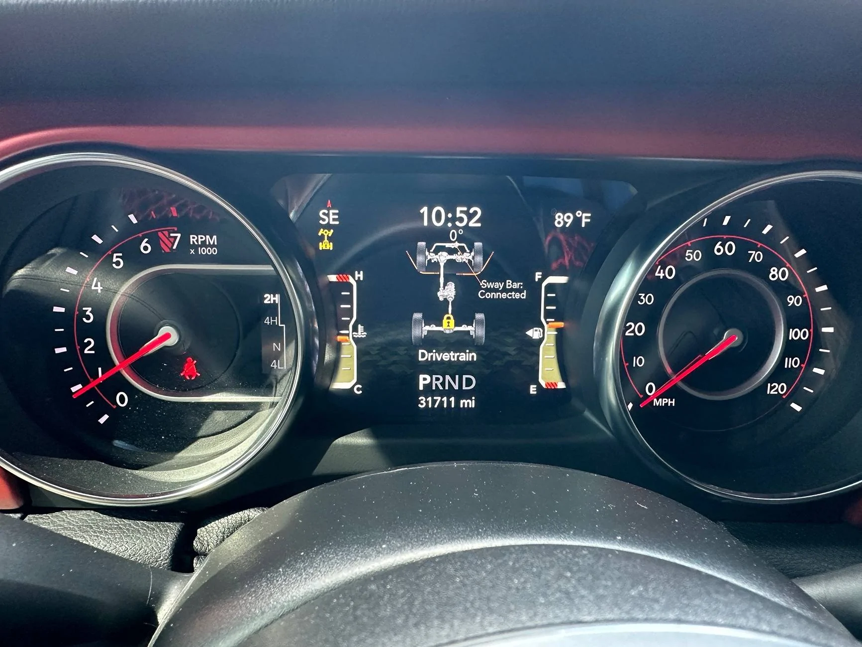

Driving (2WD) today and noticed the locker icon in the instument panel and the light at the switch flashing. I did not try to turn on my lockers but they won’t turn off. The screen says for a brief second that it’s disengaging but does not. How are they even on in 2WD?!
In an attempt to get them to turn off, I went in 4LO and engaged all the lockers, then disengaged them. The rears stayed on.
Whats going on and what would the remedy be?

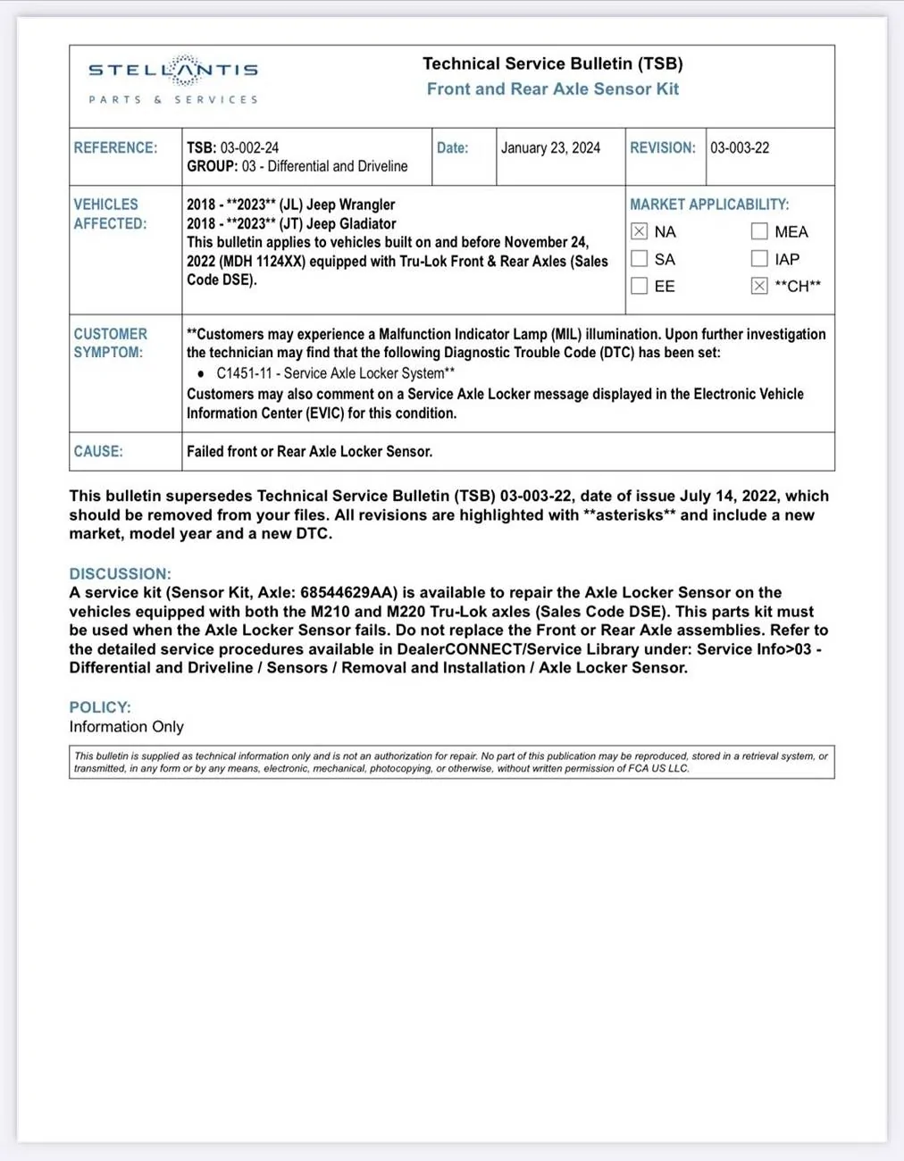

Found another thread that had posted a
Jeep Wrangler JL Rear locker automatically engaged in 2wd? IMG_5869
TSB about this. I’ll have to reach out to the dealership to see what they say.
In addition to the DTC, IIRC I could confirm which locker it was with a good scanner.
that is correct! your warranty should cover it..
before they started replacing the sensor they were issuing new axels
