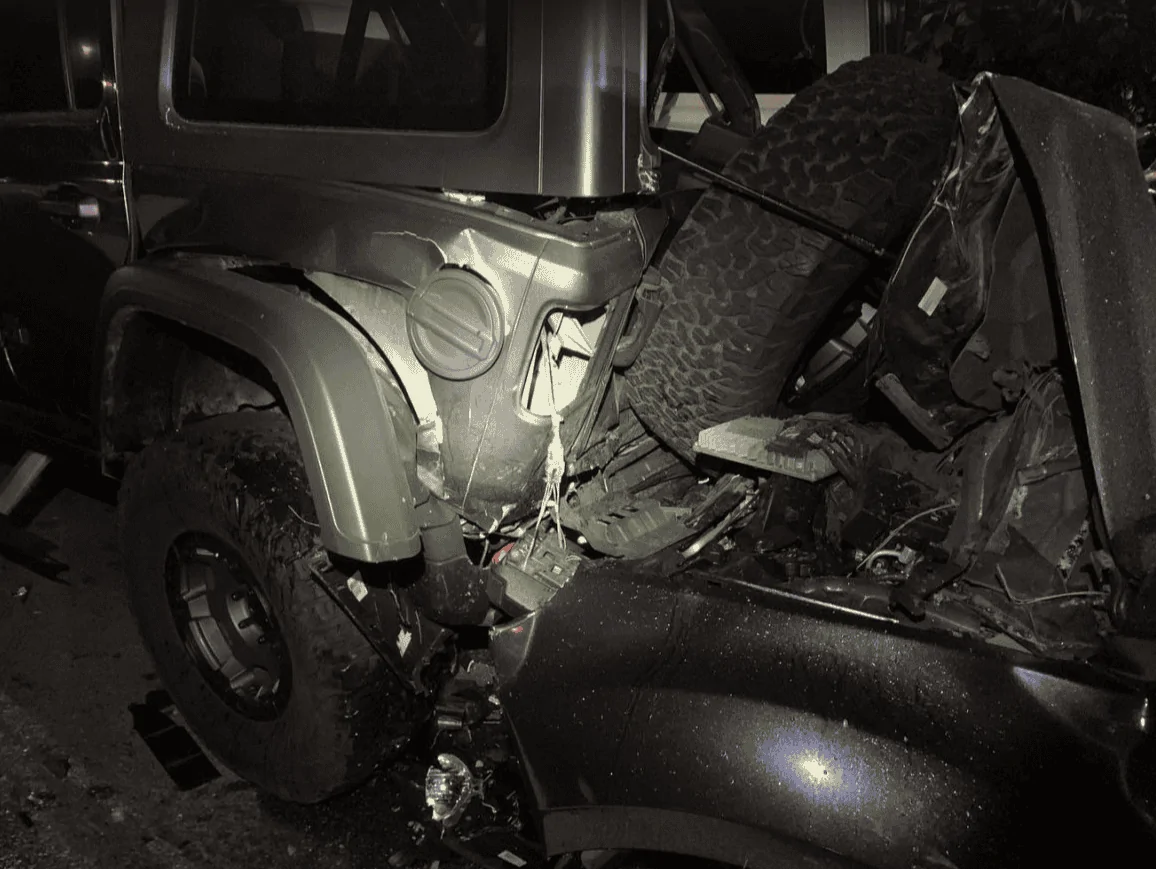

kah.mun.rah
Merenkahre Jr.
May 16, 2022
41
4,625
9,745
Duat
You have conflicting info - hit pretty hard but no signs of damage?
Take it to body shop and have it inspected. Call your insurance.
Hey! Give him a break. I was also hit pretty hard and it took a lot of looking to discover if anything was damaged or not on my Jeep.
Jeep Wrangler JL Rear-end hit 1682107605693
