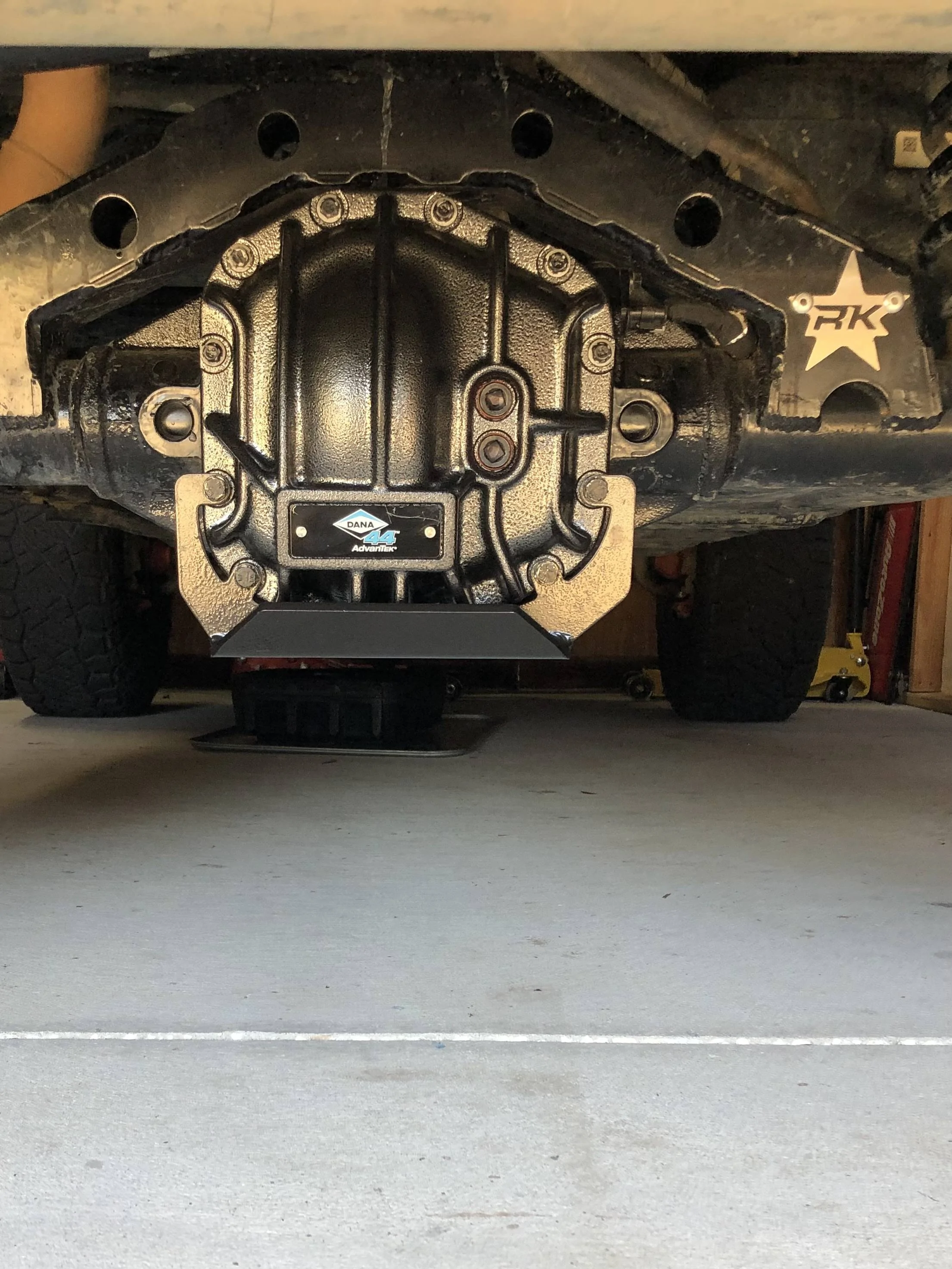

I added the Metal Cloak diff. skid (aka: Golden Diaper) last year and though I haven't hit yet, it's great knowing it's there for just what you described. Easy to install. I did end up notching it to accommodate the fins on my Advantek diff. cover - then hit it with a little golden rattle can. It didn't quite seat perfectly until I did. Close, but not quite. Between it, the @Rival 4x4 muffler skid and @EVO MFG shock mount skids I feel like I'm pretty well covered in the rear.
Looks very nice. Looks like the fit is nice and tight also.
I'm a Willy's sport, so I have the m220 which I think is the basically a D44. So no issue finding a skid for it.
But I'm a m186 in front and I am not seeing a lot of options for it. Like a lot of stuff mfg's just want to cater to Rubicons. Still looking.
Thanks for posting.

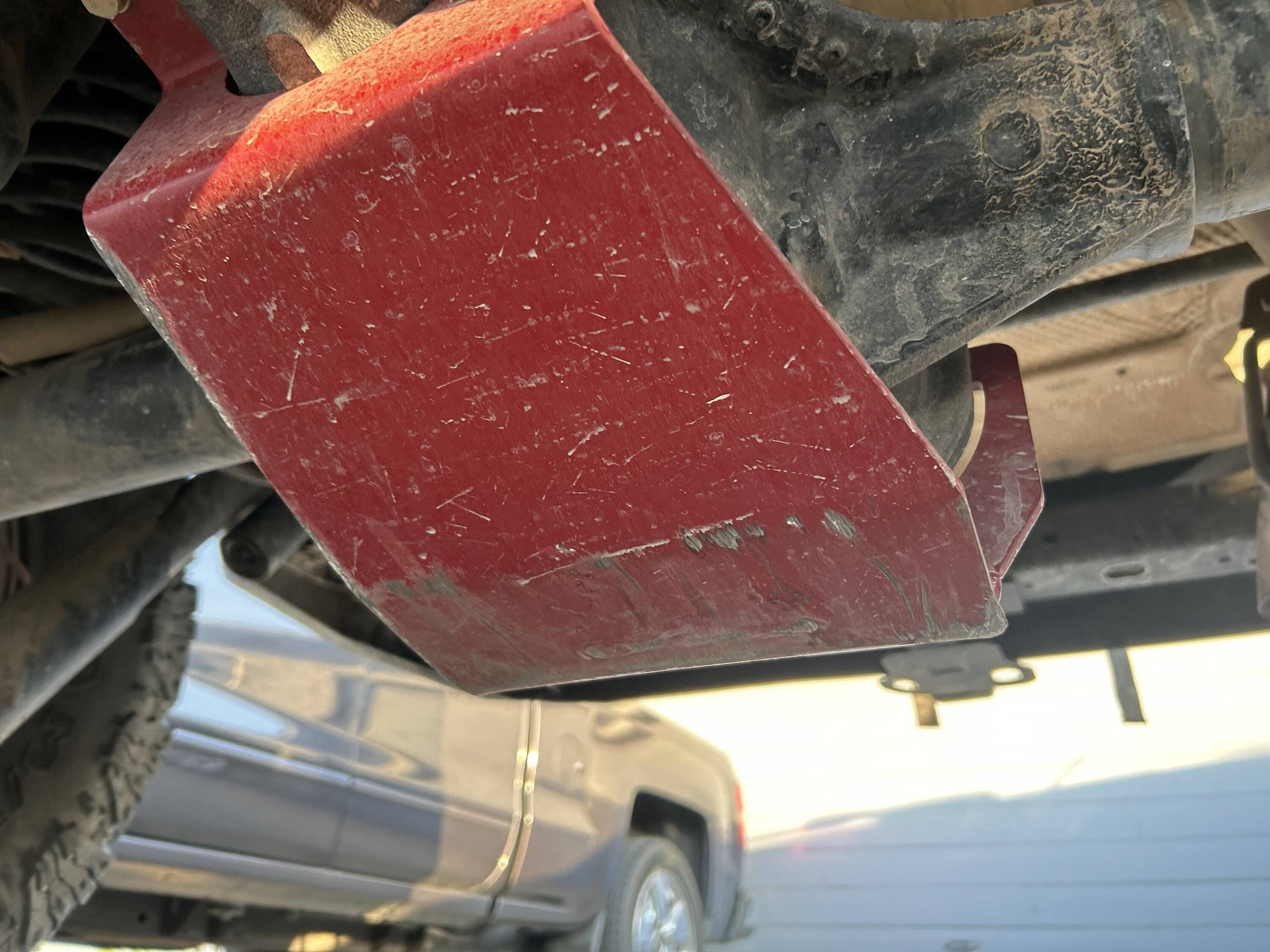

i run the rancho diff skids. had them installed in less than 20 mins with my hand tools. Ive hit them a few times and they have held up nicely.
Rancho RockGEAR RS62124 Skid Plate - dana 30 front skid
Rancho RockGEAR RS62117 Skid Plate - dana 44 rear
Jeep Wrangler JL Rear Differential IMG_8072
Jeep Wrangler JL Rear Differential IMG_8068

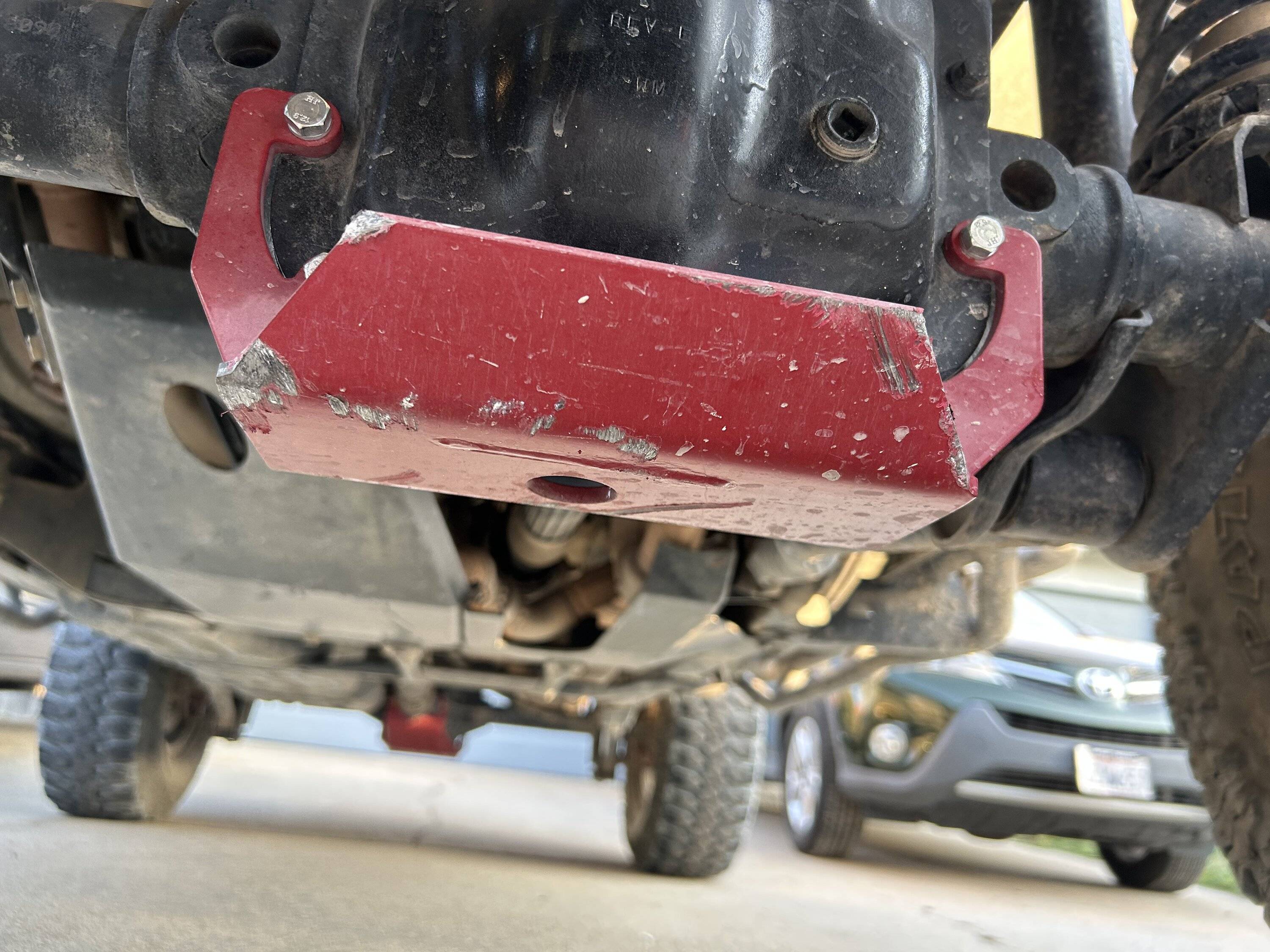

I’ve got the heavy duty Dana covers and Rancho skids…. It only takes the thickness of the skid away from ground clearance (1/4”)…..Been working great, I rattle canned the skids to match my covers though….. even though red is my accent color, it was too much red, lol….
