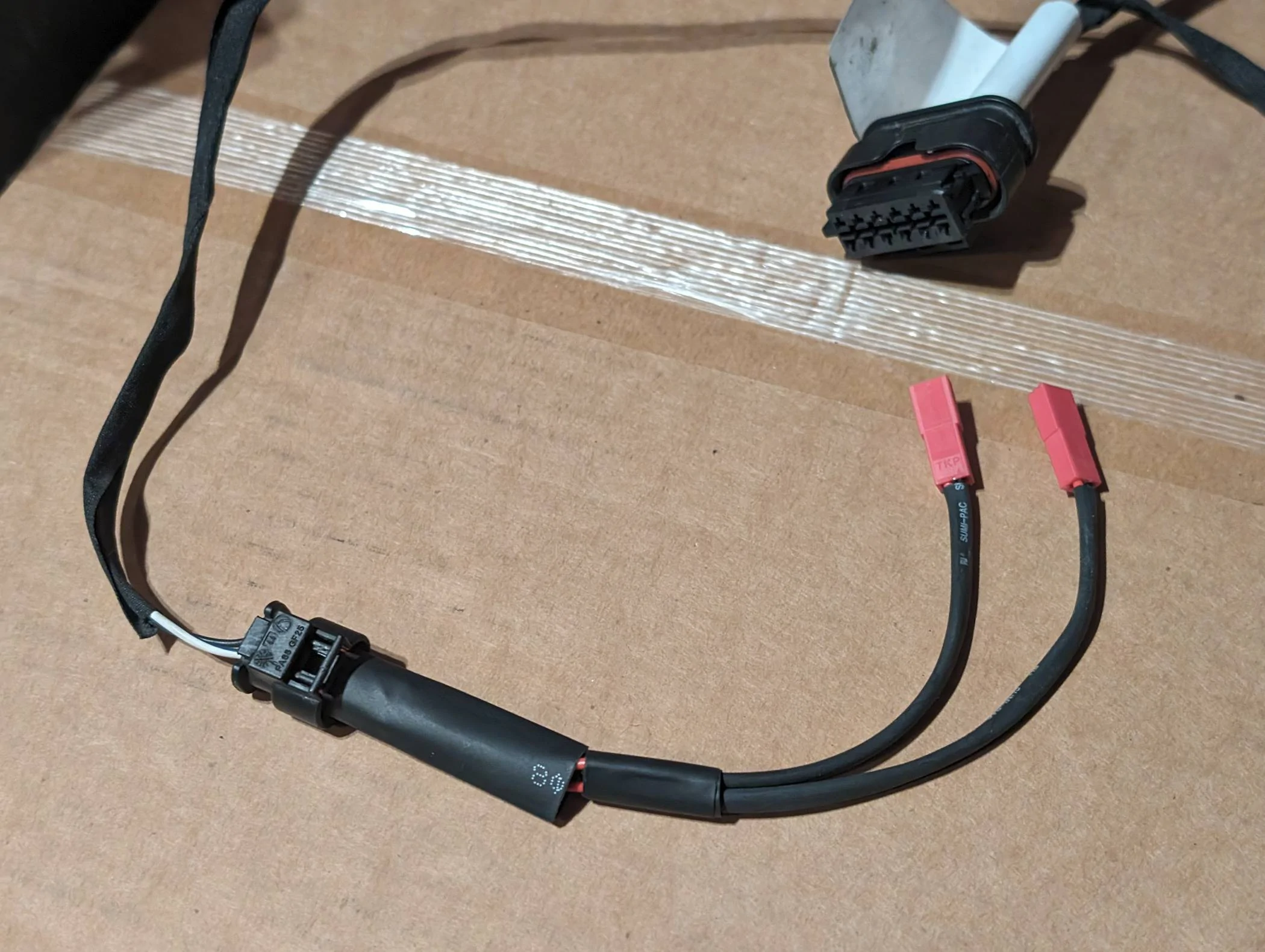

I'm swapping my rear bumper, and need to come up with a solution for the license plate lighting. Luckily my jeep doesn't have rear sensors so the only wires in the bumper harness plug are for the license plate light (they match pins 4 and 8 from this wonderful resource). Ideally I'd like to find the matching plug and appropriate pins so I could wire up my own cable, since I want to keep things as reversible as possible.
Alternatively I could pick up a spare harness to cut up, but I'd need to find the part number. Is there any resource we can use to look these up ourselves, or is that the reason why everyone here asks Benny these questions? I was going to reach out to my normal parts supplier to ask, but I don't want to take up their time if I'm going to look for the correct plug on it's own from somewhere else.

Nah I spent a grand on bumpers, but they're only for the weekends and holidays. Actually I have a leased 4xe, so I figured it's probably a good idea for me to be able to return it to stock. I'll see how hard it would be to unscrew the bumper and pull the wiring.

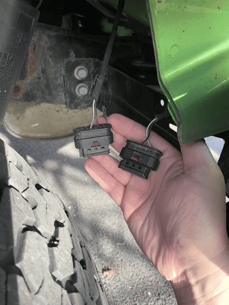

I recently bought a used rear bumper to replace my damaged original and the connector in the body was the same as the one on the bumper. I guess someone screwed up in the factory.
Jeep Wrangler JL Rear Bumper Wiring Harness 1714269476733-hm

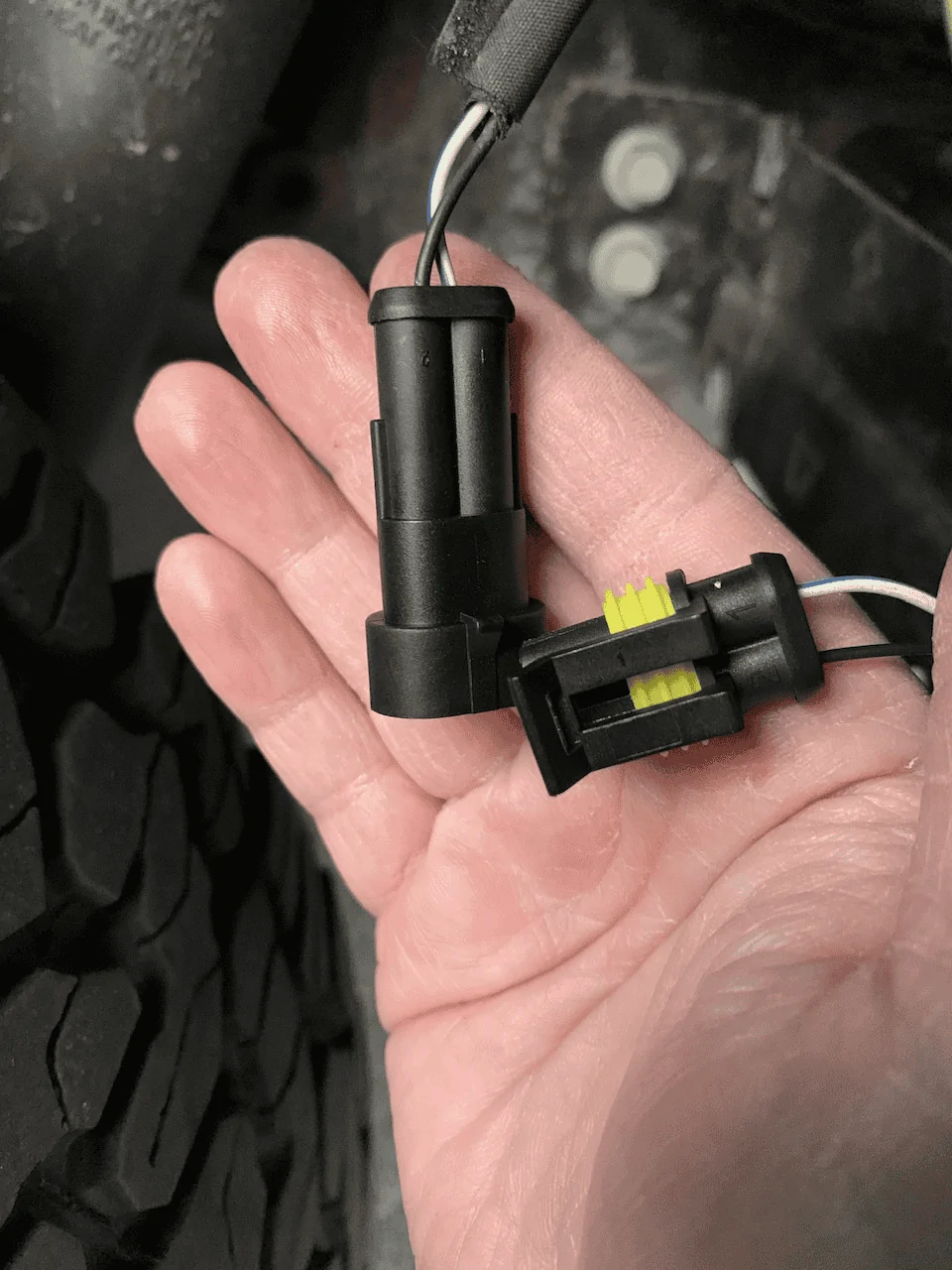

So, I got some DIY Weatherpak connectors and made it myself. You could do the same, and then add one to your OEM bumper if you need to reinstall it.
Jeep Wrangler JL Rear Bumper Wiring Harness 1714269371519-d

Woah there, mr fancypants. You mean the Jeep approach isn't to just shove the wires into the plug?
Jeep Wrangler JL Rear Bumper Wiring Harness A proper wiring harness
Well, at least I used some spare shrink wrap--heat shrink you fool, it's called heat shrink tubing.
