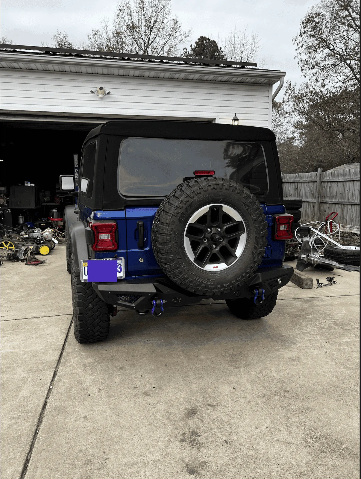

Alright, its in! Install went really well. Removing the bumper was pretty straightforward, and taking out the parking sensors was easy but rly time consuming. There are probably 25-30 little screws that you have to take out to separate the two layers of the bumper and take the sensors out (which are held in by these plastic clips that can be bent back to be pulled out - just be sure to be gentle). The real pain was putting them into the bumper. The system of using little screws to tighten the sensors is pretty illogical and time consuming, and I only ended up using one screw per sensor since it was nearly impossible to reach half of the holes. Other than that, pretty straightforward.
However, I did find one issue, but I guess its not Bestop's fault. My rubicon tire no longer fits on the back, so I have to get a spare tire relocation bracket. However, there's a hole on the right corner of the bumper that seems to be a potential spot for a future tire carrier. Not sure what specific tire dimensions you are running, but just something to keep in mind. Lastly, I threw on some D rings to match the ones I had in front. Really happy with the way it turned out!
For clarification, in this photo the tire wasn't fully tightened. When tightened, it hits the bottom of the bumper.
Looks great! I don't have any parking sensors so that would potentially speed up the process. I see the OEM tow hook is still in use, per Bestop's instructions. As for the tire, is it just a little snug? My BFG might be a tad smaller, don't know. Definetely something to watch out for. Question, where did you purchase from and how long did it take to get delivered?
Thanks for the write-up!
Yeah without the sensors it will be much faster, probably half what it took me haha. For the tire, it completely prevents the trunk from closing, to the point where I had to take it off until my bracket comes. Other than that though, this thing is awesome. Would totally recommend, minus the tire thing, which like I said isn't really their fault. The KO2s are definitely a little smaller than the wild peaks, but not enough to make a difference unfortunately. Got it from Quadratec and got here in like 4 days, their shipping is insane.

@sebythellama , I think i read that you have WP 33's. Am I correct? Bummer that a 33 spare will not fit. I do like the look of that bumper.

So the reason why it didn't fit was that I was using my factory sport tire carrier with the rubicon wheels. I've since gotten a used rubicon tire carrier off of Facebook marketplace for like $20 and installed that and now it almost clears. It's still making contact (but not interfering with closing the trunk or anything) but that's because I realized I kind of installed the bumper a but farther away from the body, so sometime in the next few weeks I'm going to see if I can loosen it up and push the bumper closer to the body to make sure it has room.
