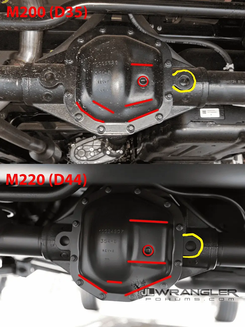

If you want to know if your stock has been swapped, here is an image from @Terrymo that might help:
I got that image from someone else. I don’t recall who, but I deserve no credit

Thank you both, much appreciate it! Mine looks like the M200 and that's what my VIN search in the link you provided shows too. The $1,200 is everything assembled, to me seems like a no brainer. Thank you both again!
