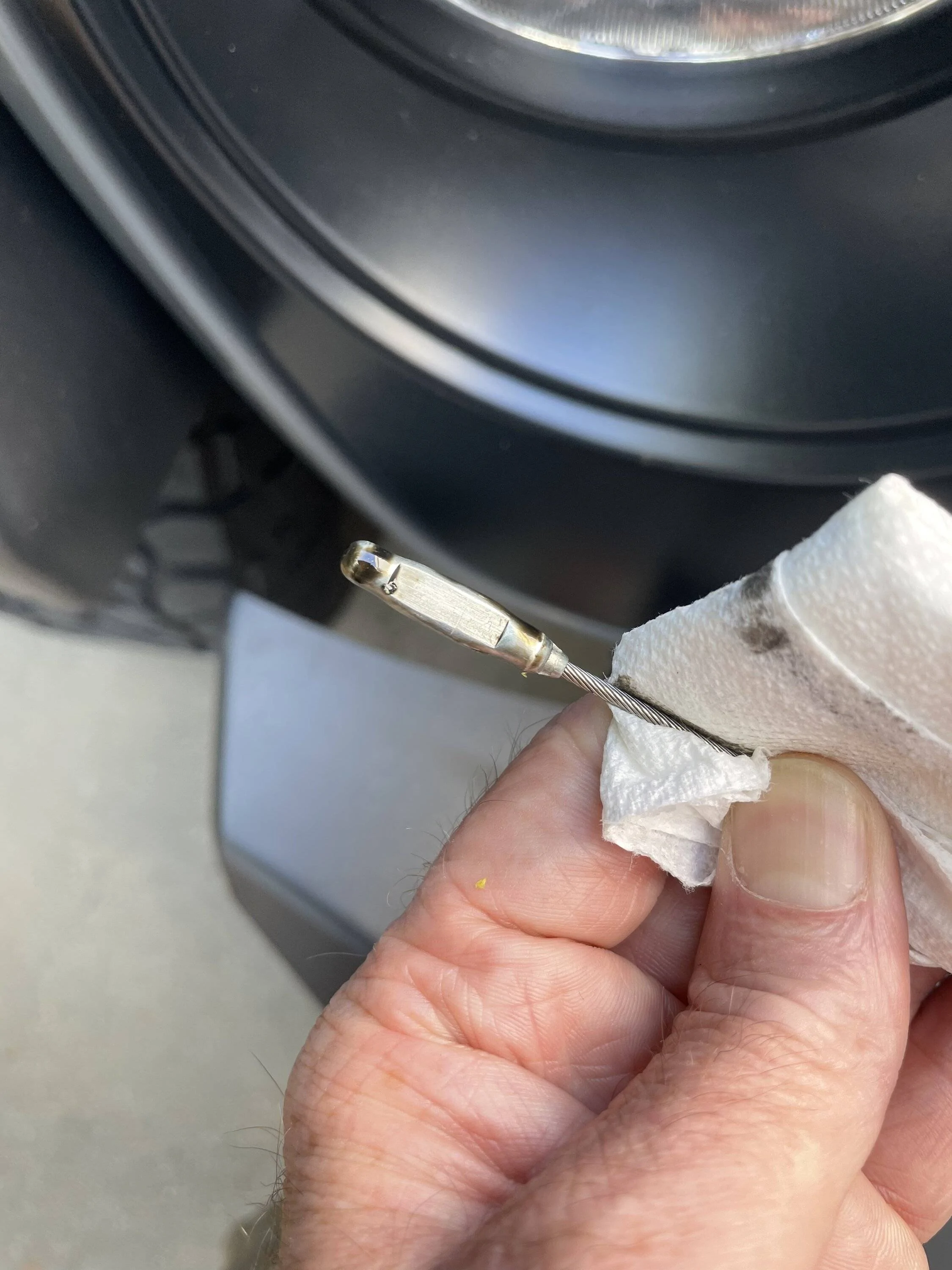

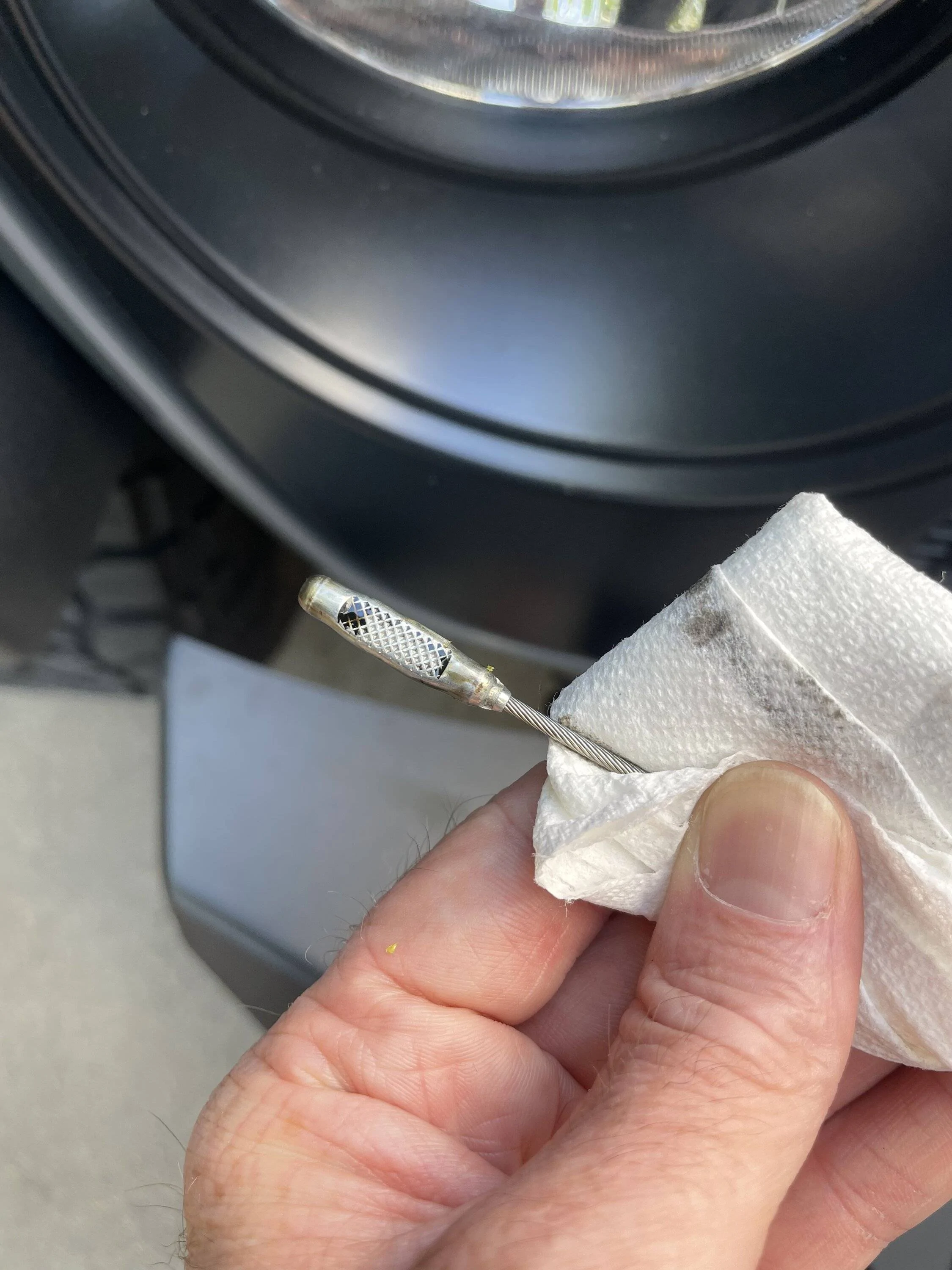

So please be nice…..I checked the oil for first time and I want to know if I’m reading the diesel dip stick correct. There arnt any marks like I’m used to with the old 4.0L straight 6 engines. Just looks like this…
Jeep Wrangler JL Reading oil dipstick 1FF2F03C-691F-4212-8C6F-F89EC2969FF4
Jeep Wrangler JL Reading oil dipstick 61A303AF-7319-4B52-83E2-21E6E3413BBD
Am I right in assuming if oil is in the hash marks it’s OK level?

Yeah, but why not add a little to get it to the top edge of the hash marks? It's easier on the oil if it is topped off full, more volume for the dilution of contaminants and you have that safety factor that the level can go down a little and it will still be fine.

Typically the top of the hash marks indicate full. Below the marks, but still visible on the dipstick is about 1 quart less than full. Anywhere in between is ok.

Thanks. This is how it came from the factory and I don’t want to add a different oil than what is in there. It’s only at 4500 miles.

How long have you owned the JL? And this is the first time you’ve checked it? Pretty lucky as a few of the diesels have eaten plenty of oil with less miles.
You are a quart low, you’d be better off if you added some.
But, you are at 4500 miles on the original oil, you could just change the oil and put all new in.

I’ve had it 5 months. I think I checked everything when I got it but I don’t think it registered the stick was different until now when it seemed liked more oil should be visible.

Well, you are a quart low, so that’s why it isn’t reading much. So either add a quart or change it.
Just for your info, when you do change the oil, good luck reading the dip stick. It’s a horrible design and hard to read fresh oil.
I love my 3.0, but there’s little things like the dip stick that just make you shake your head and ask “WTF”.

Always check the oil with a warm engine about 5 minutes after shutting down. Oil level should be within the hash marks.
At your mileage you should not be using any oil.
I’ve checked mine when cold and it is always on the low end of the dip stick. When checking with a warm engine at 5 minutes after shutting down it has always shown within the hash marks.
I have 12k on my 21 JLURD. Living in the heat of southern Arizona and after off road adventures I’ve never had to add oil.

I've had a few cars/trucks with this type of dipstick.
I've found that you get the best results by cleaning the business end of the stick of any residual oil really well before inserting it in for the read. If it's nice and clean/dry when it goes in, you'll find it pretty easy to read after pulling out.....
Am I talking about dipsticks? ??
And upon pulling out, keep it upright (don't invert the stick), to keep the oil from traveling up the hashmarks.
