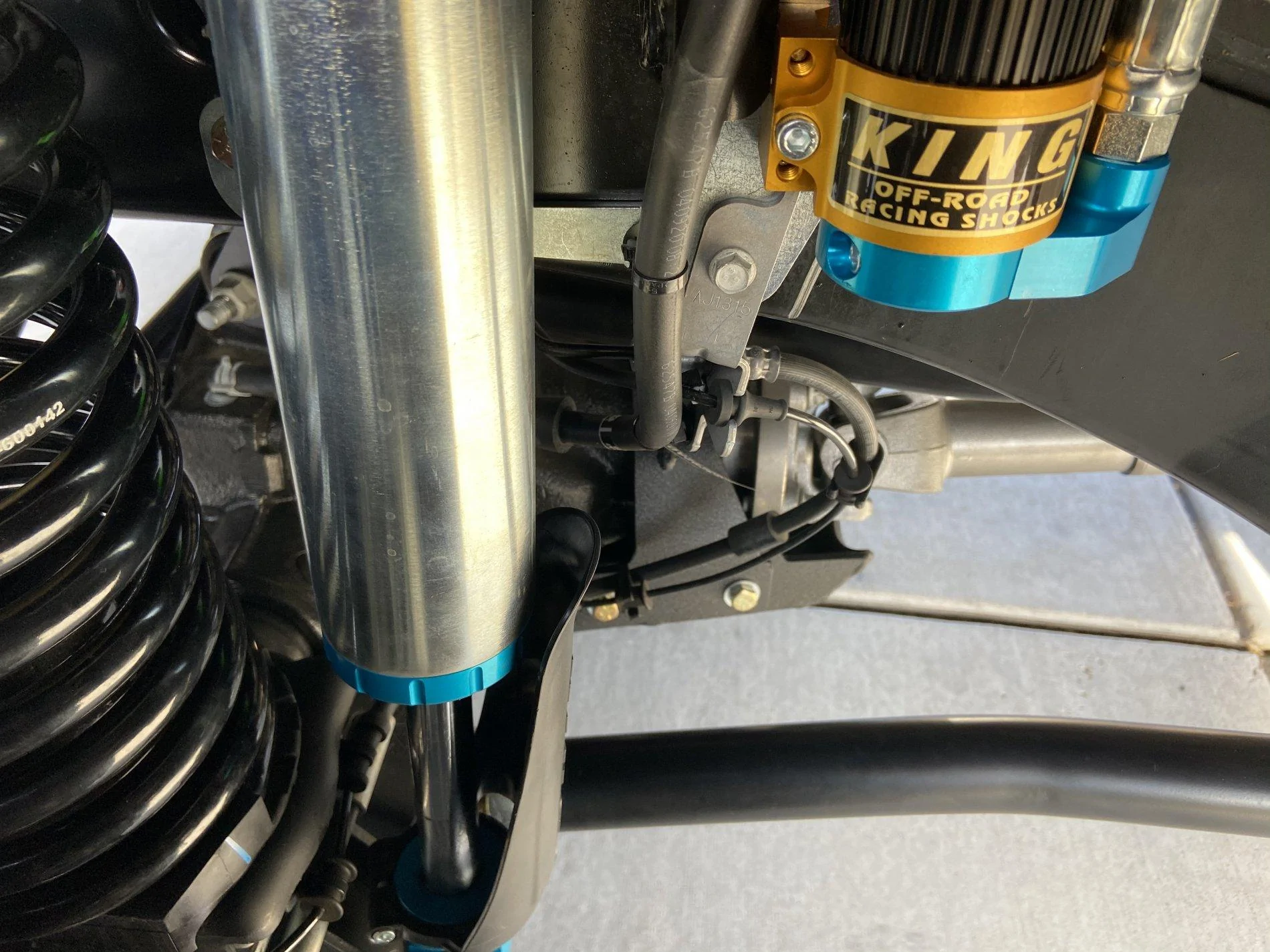

How does the EVO enforcer lift ride/handle on/off road?
I have not taken it offroad yet, been too busy and only drove it maybe 30 miles. With those shocks and tires it still feels stock behind the wheel. The speed bumps in parking lots are no issue with the shocks, you almost dont have to slow down for them.

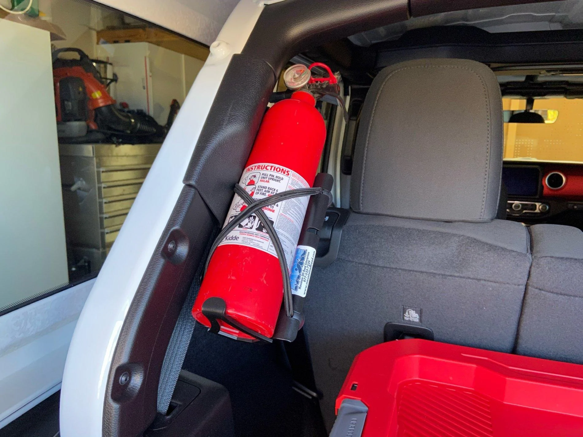

Here is m.o.r.e. Fire extinguisher mount.

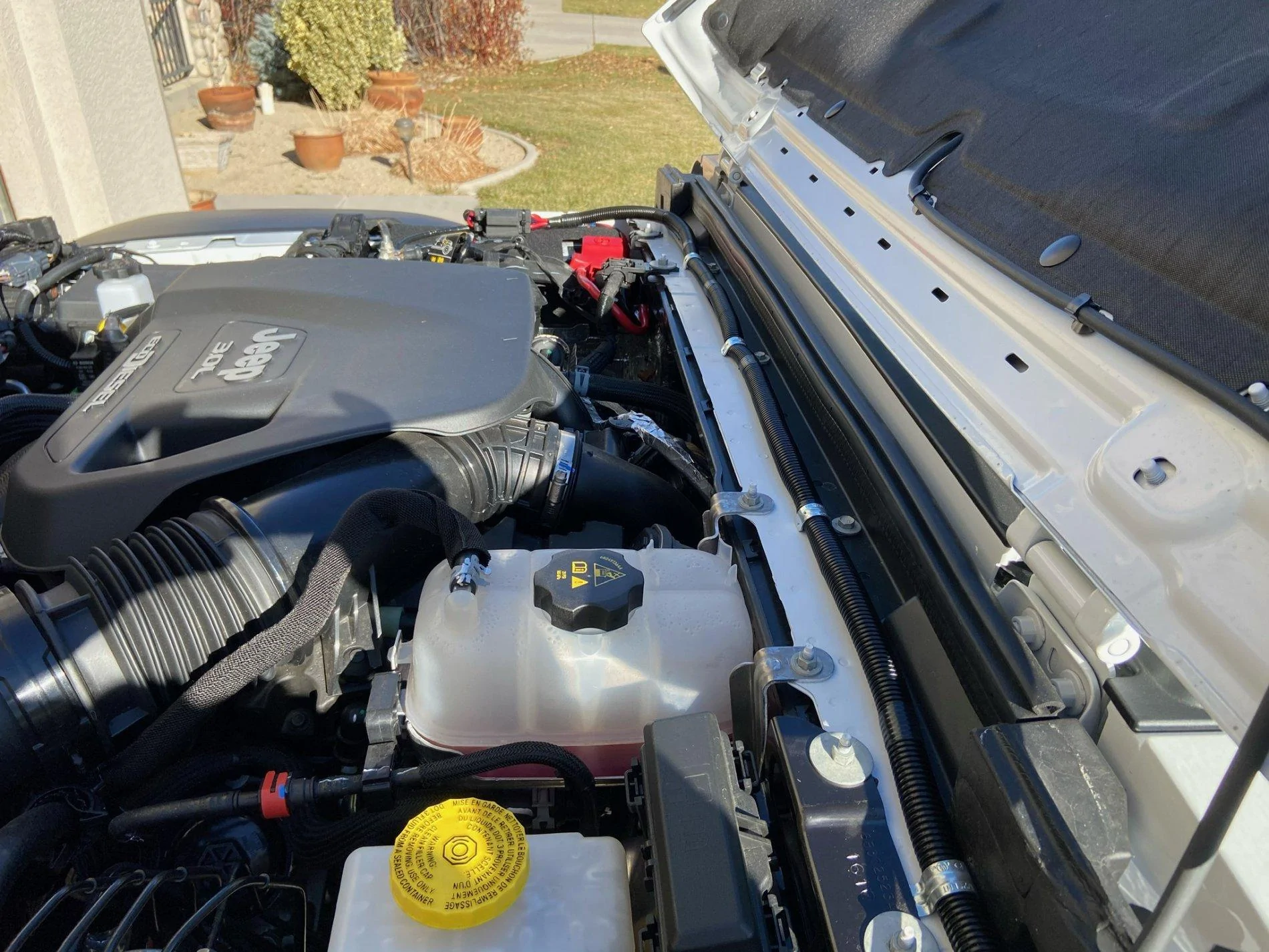

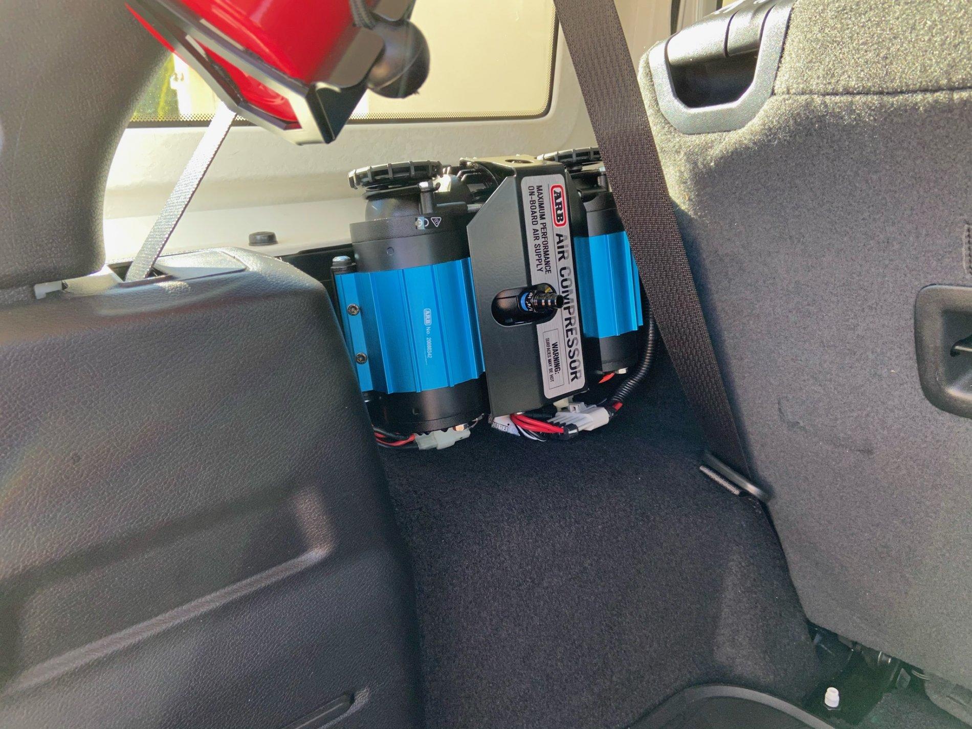

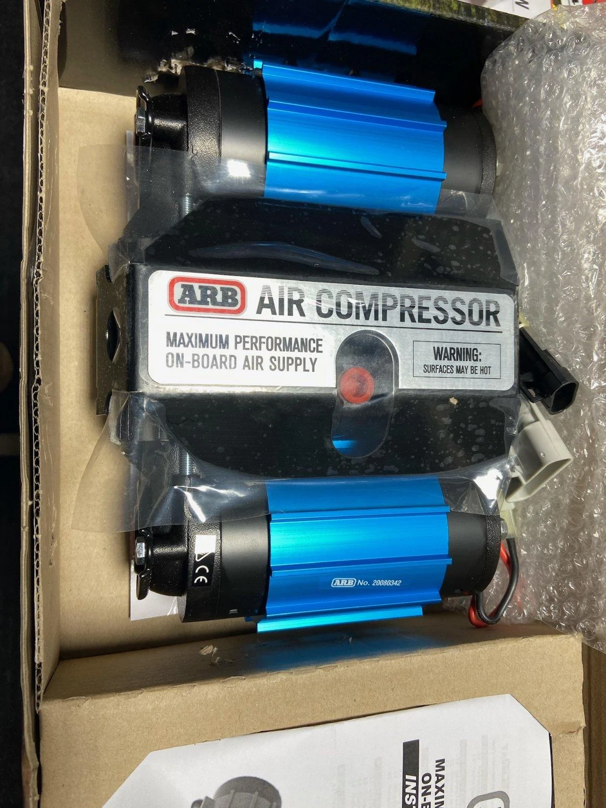

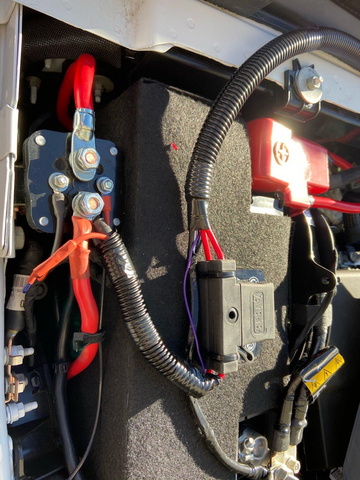

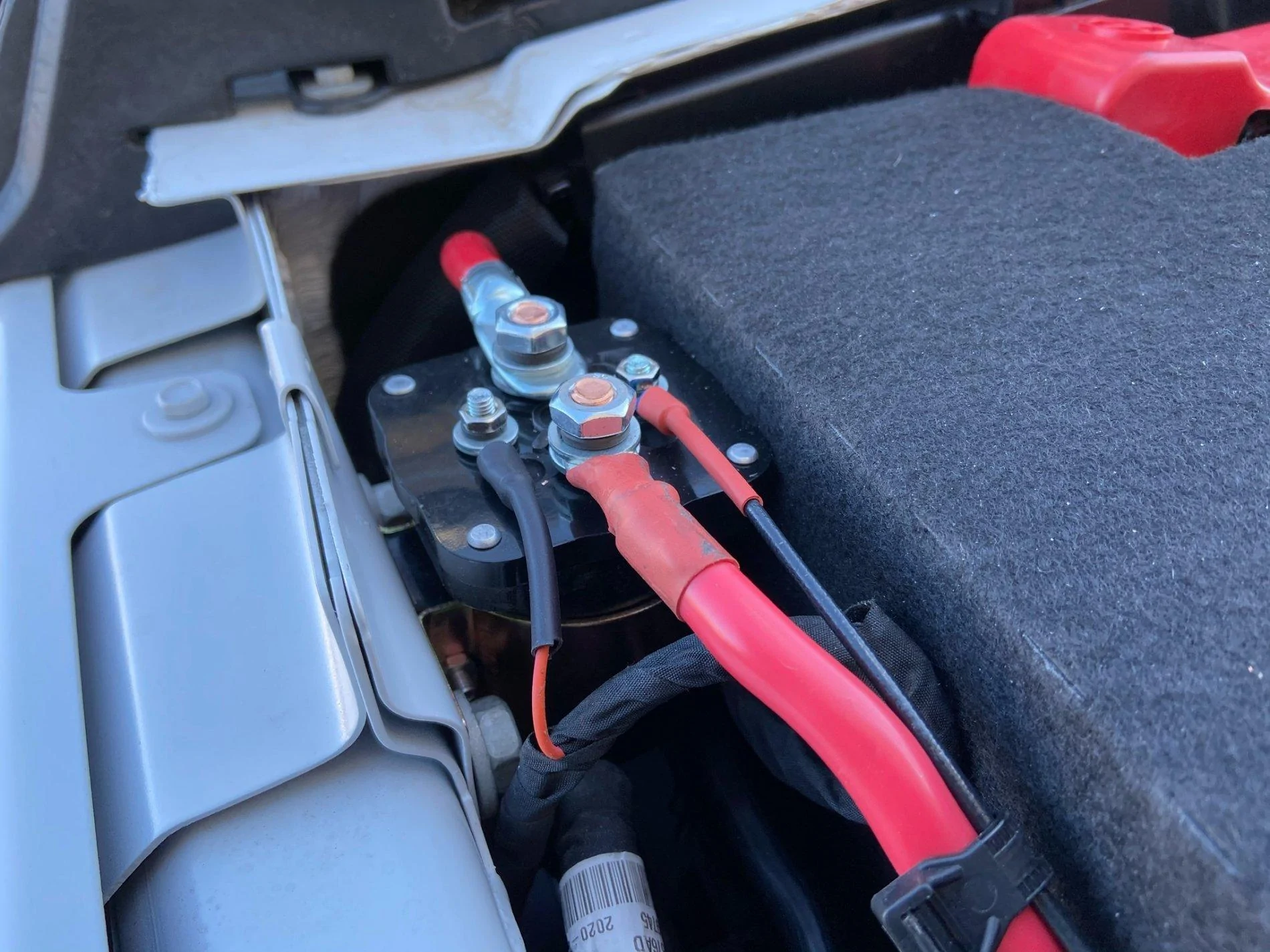

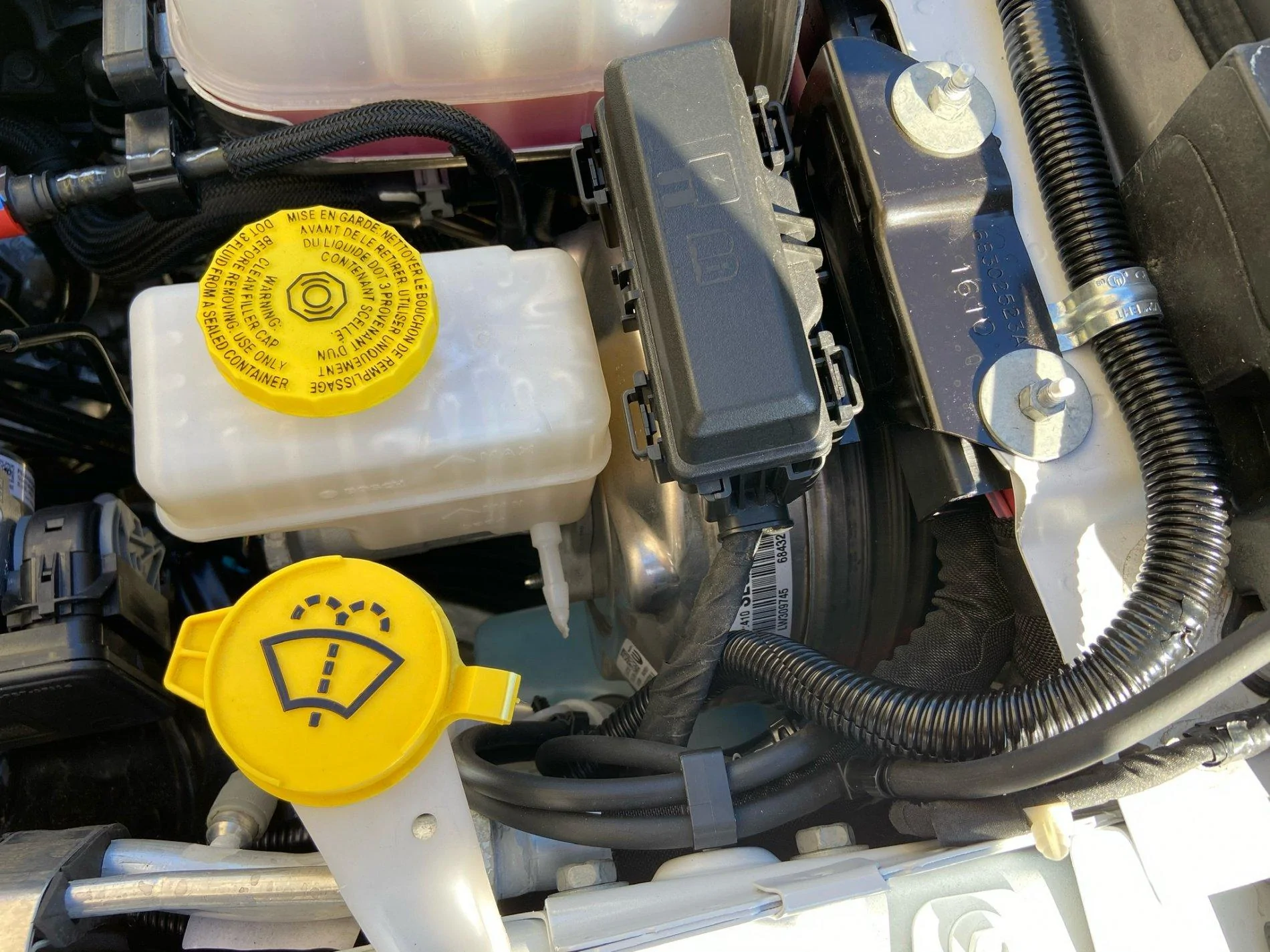

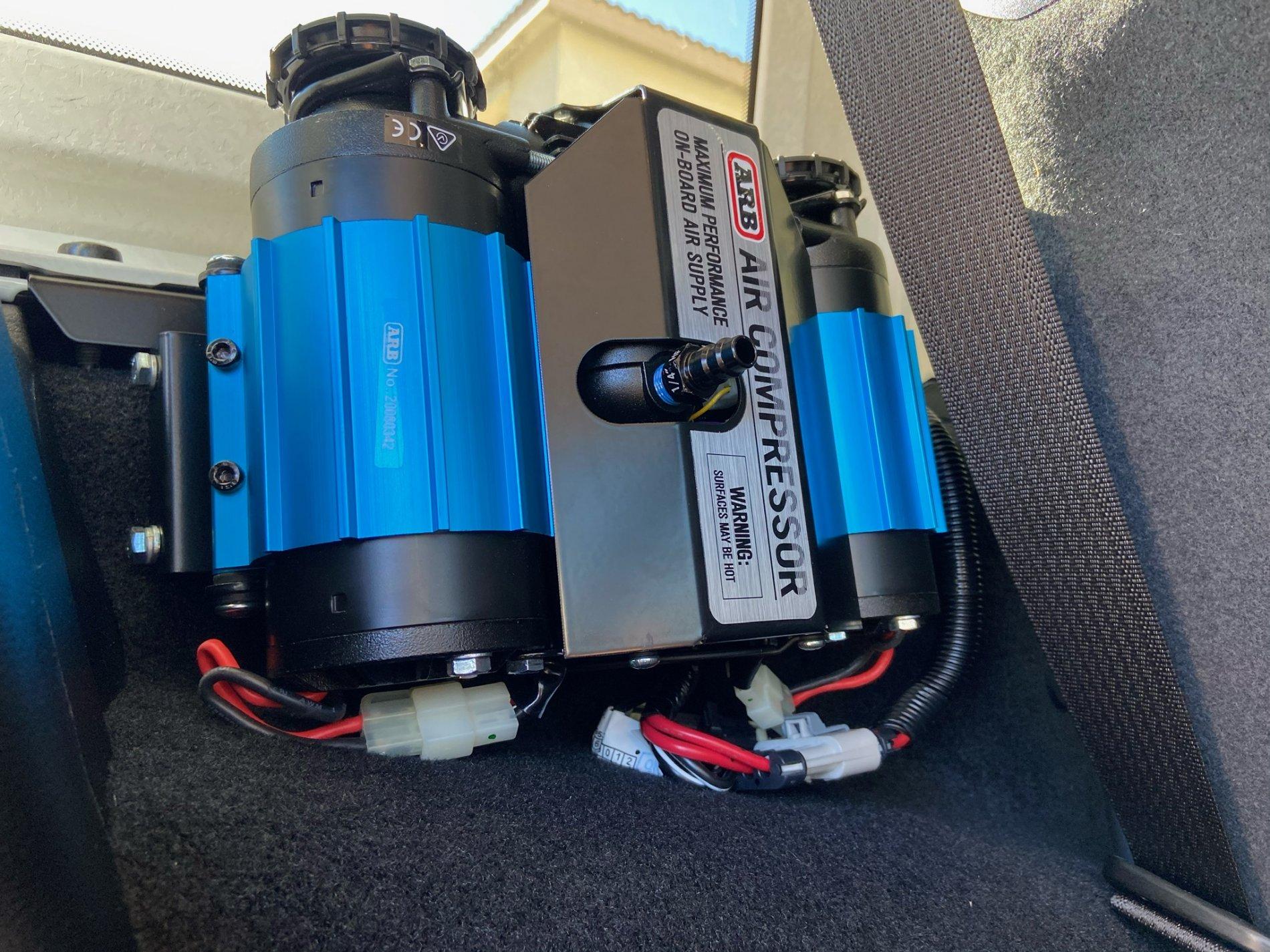

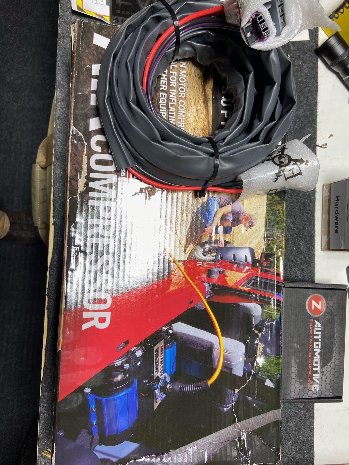

Well today I installed the ARB twin compressor with the more mount and wiring harness from:
https://expeditionessentials.com/co...ts/bedside-compressor-mount-extension-harness
I routed the wiring harness under the drivers side door trim. Be careful removing the trim when its cold. I broke a few plastic clips when removing the trim. I had to remove the clip from the wiring harness to work the harness through the plastic plug in the firewall. Has you can see everything turned out great. I can control the compressor from aux switch on my dash. Main power is routed through the relay for the winch so the compressor has no power going to it unless you hit the aux switch to turn on the relay.

Nice work! Do you have the same aux switch turning on power to winch and compressor?
yes, you can only use one at a time.

When you say clip do you mean the connector of the harness that plugs into the compressor? I need to remove that to run my wire but not seeing how to disconnect the 4 wires into it.
You will need a little tiny screwdriver and you slide it in the connector by each wire and it will release the wire from the connector. Make sure you take a picture of the connector and wires so you get them back at the same place.

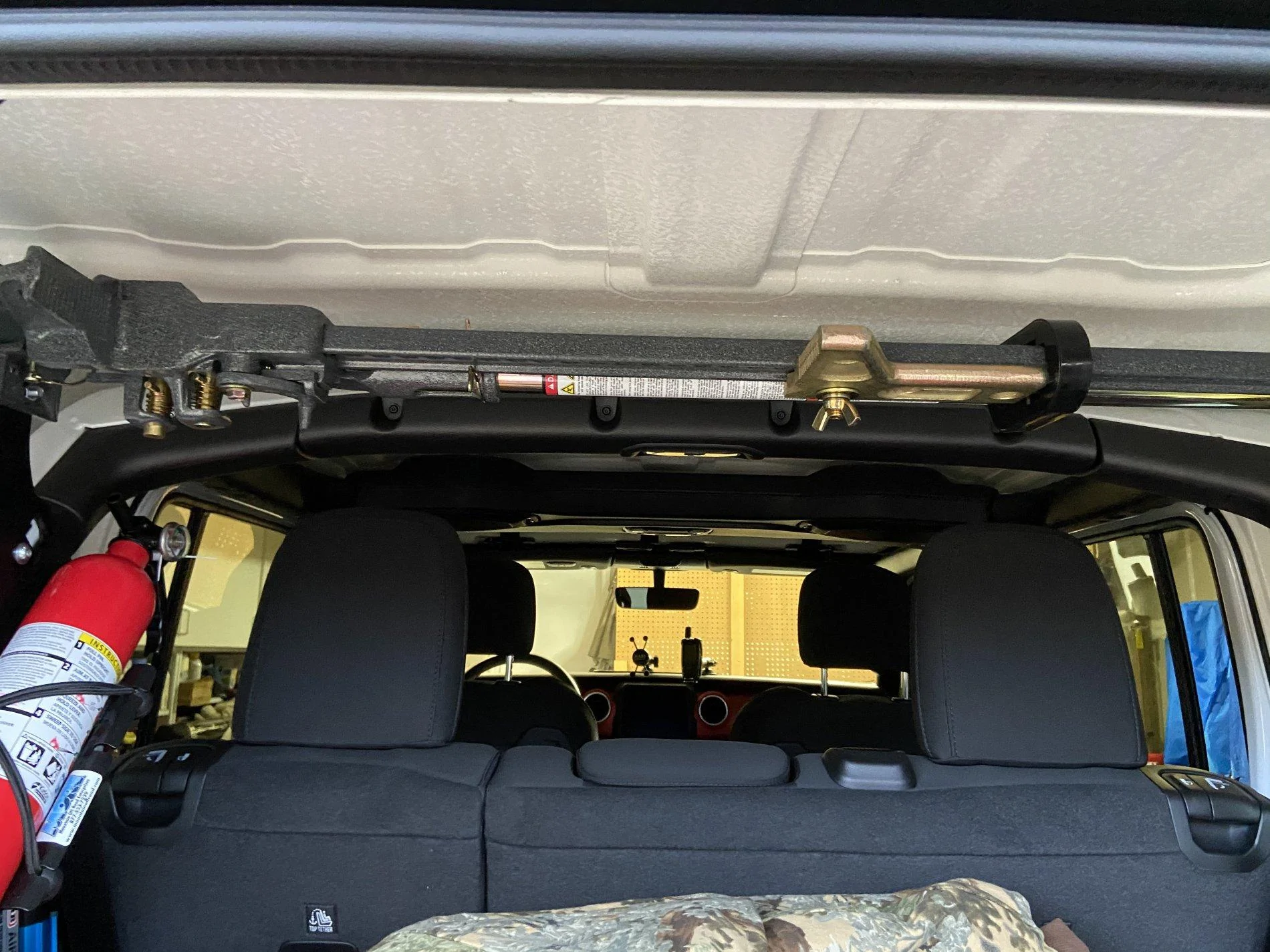

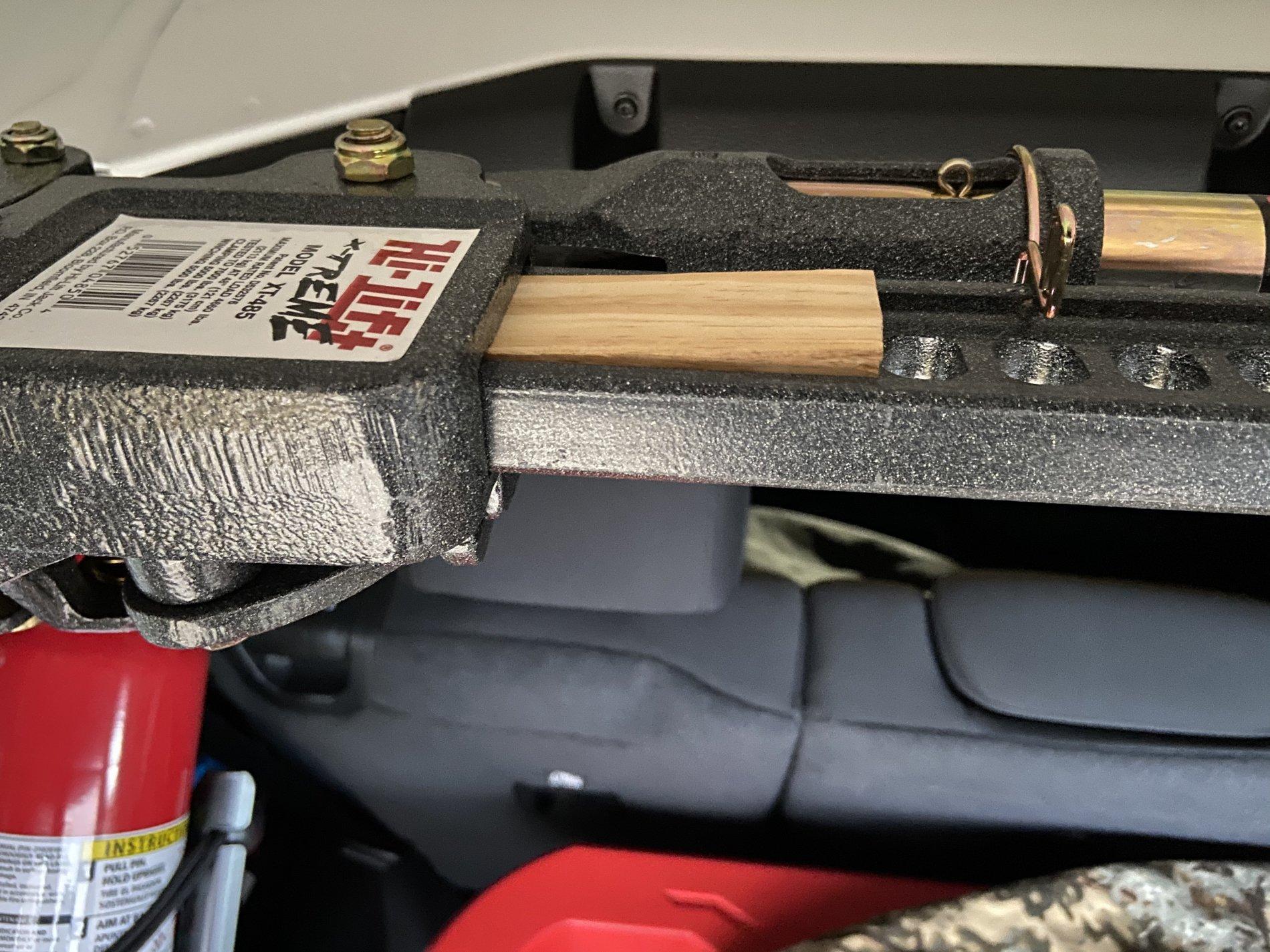

Got the rear hi-lift jack installed in the rear of the jeep. I found if you use a wood shim and wedge it down in the jack it will stop the rattle.

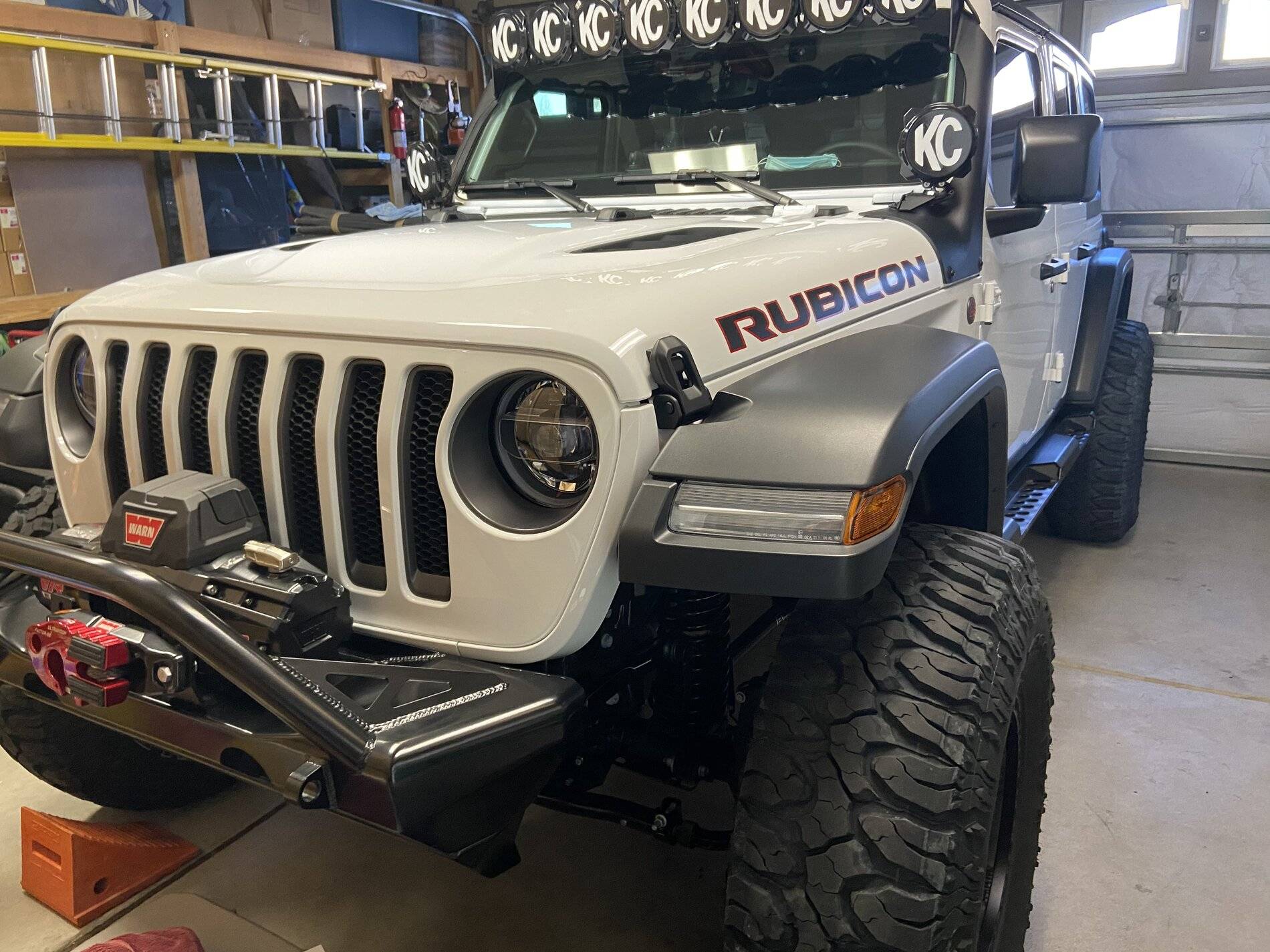

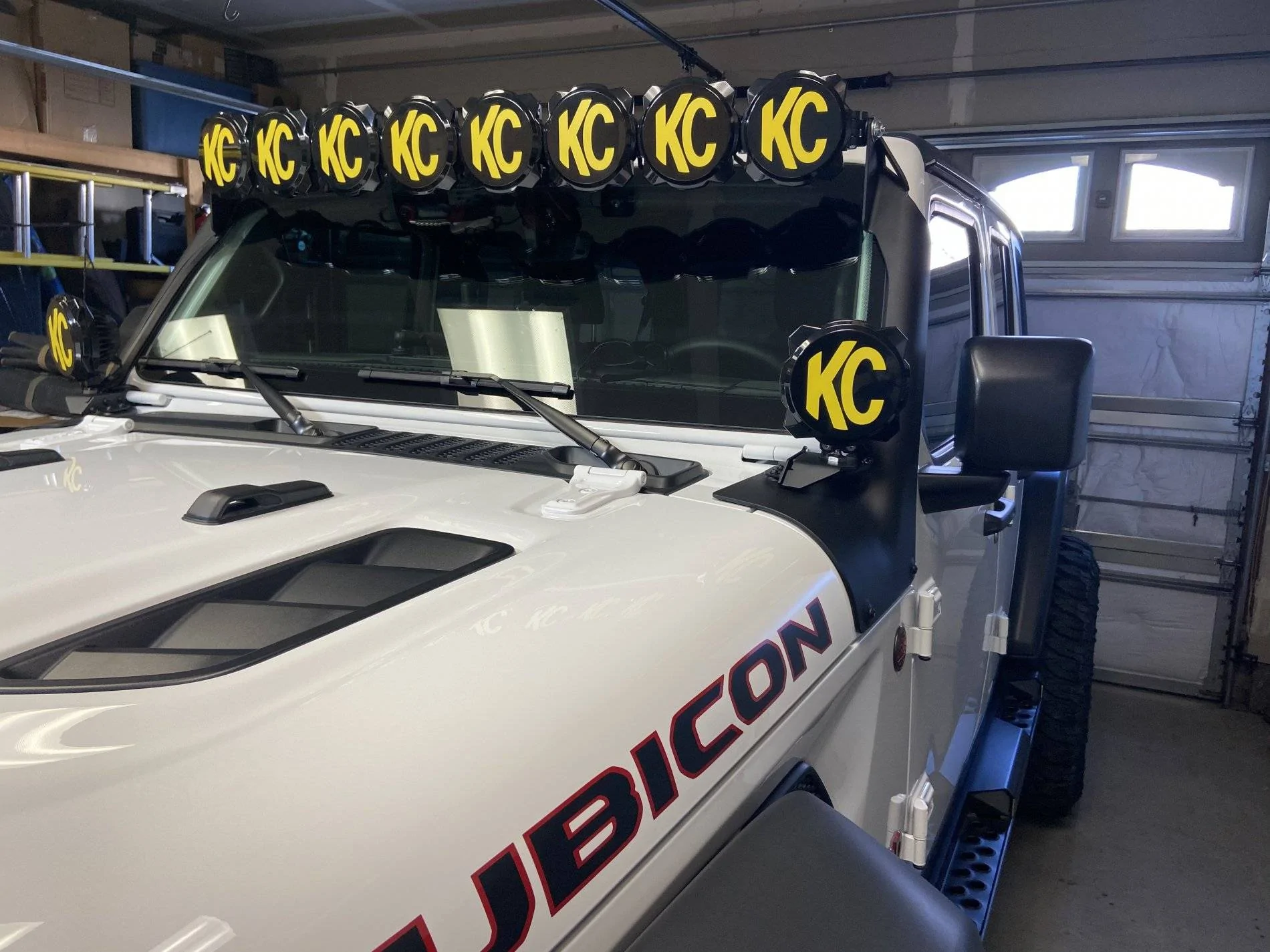

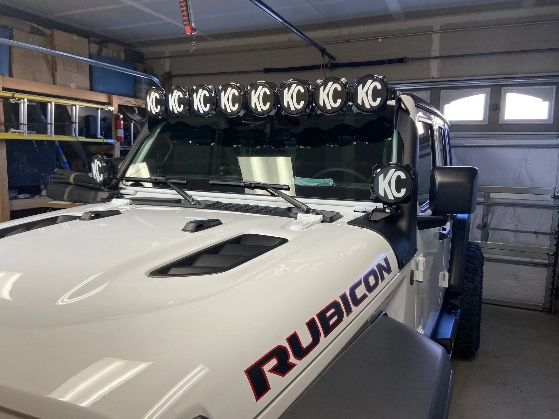

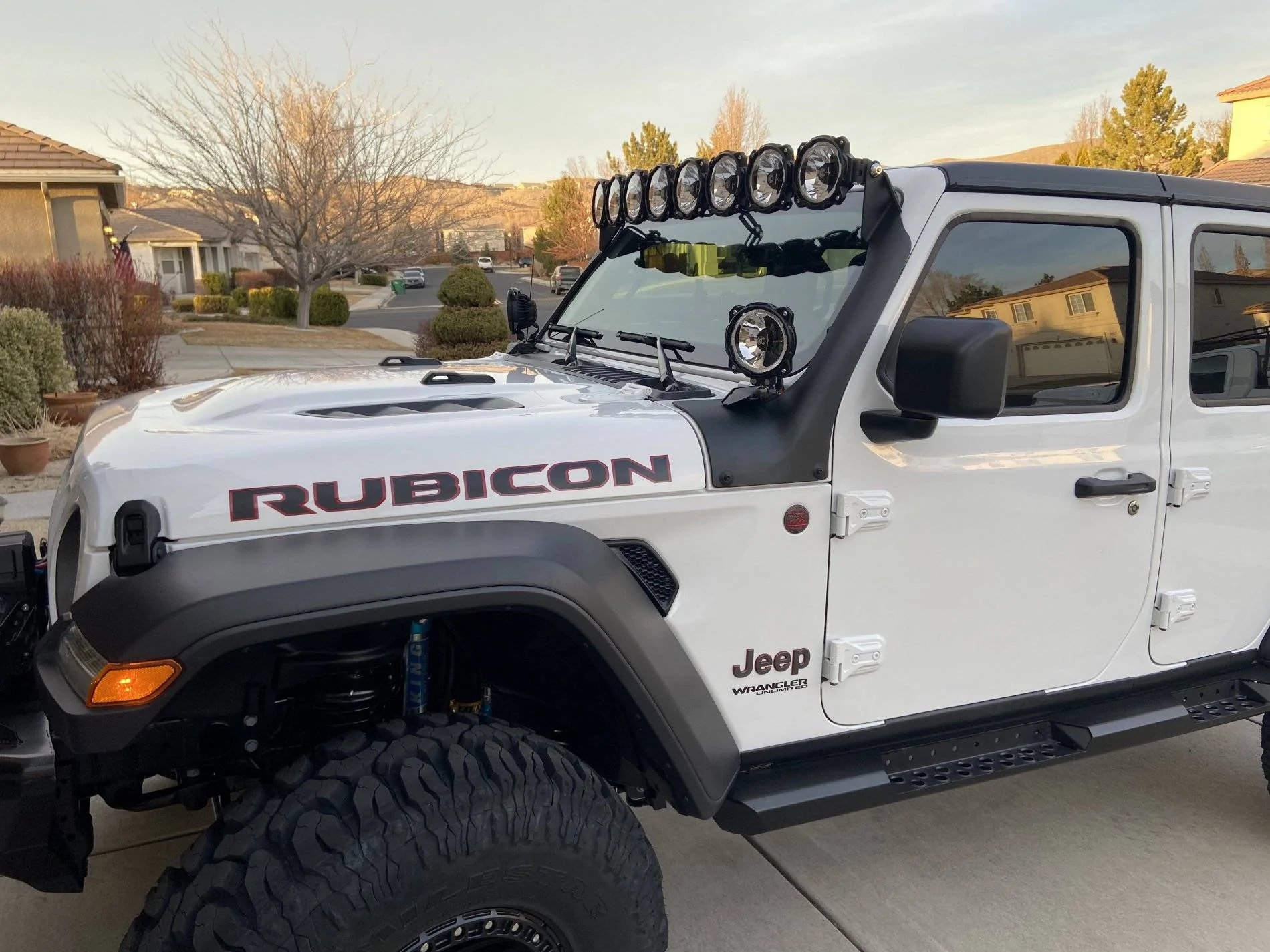

Here is pics of the KC Hi Lights, I got in a few weeks ago. Took almost 3 months to get, installation was easy was done in a hour or so. Don’t care for the yellow lettering, ordered new white stickers to cover this up.

Here is pics of the KC lights with the new stickers.
