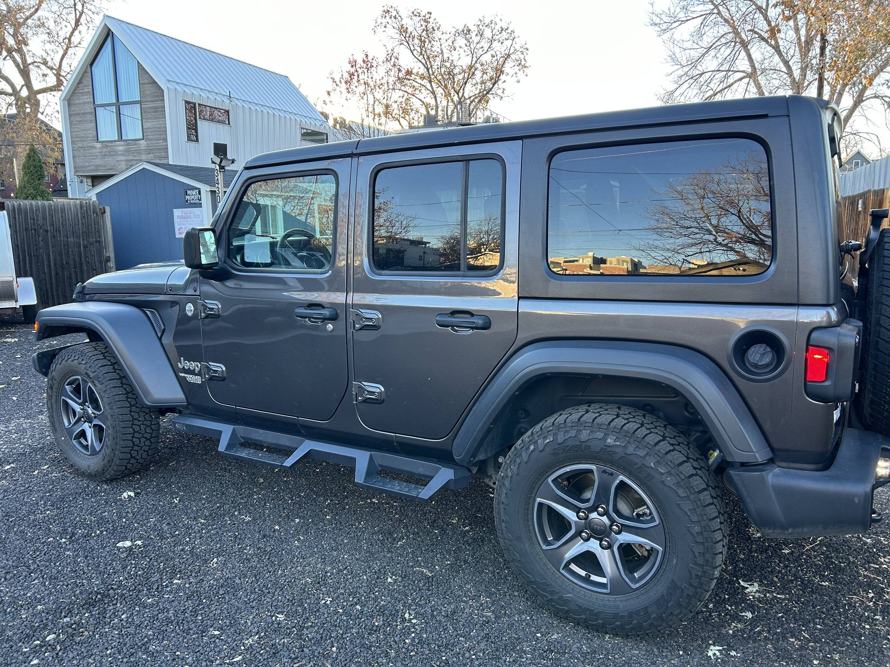

I have a 2018 JLU Sport S. Stock height and only thing aftermarket are the Westin running boards. I run Wildpeak AT3W passenger tires at 31 psi so overall it’s fairly light. I’m looking for more of a daily driver shock and go off-road every other weekend.
I made the mistake of purchasing Bilstein 5100’s for my Jeep. They ride very firm and have a harsh/jarring feel on larger bumps on the asphalt. Off-road they are even worse.
I’m debating between buying the Rancho RS5000x because the valving is progressive and should offer a smoother ride at slower speed.
I’m also interested in the fox 2.0 performance, I believe the valving is more linear. I worry that my Jeep being on the light side will still ride firm on asphalt as a daily driver with the Fox’s.
Any advice is appreciated! Hopefully this post will help someone else out in the future. I’ll be buying from Extreme Terrain.
