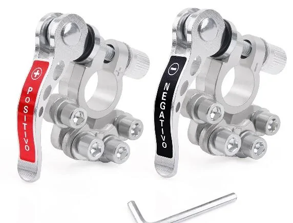

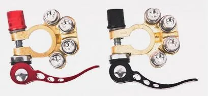

I've seen variations of these on sites like Amazon and Ebay, but none on manufacturer sites or "Jeep-focused" online stores.
I'm still new to doing my own work to vehicles. Are these common? Okay to use, Stupid for Wranglers, Useful, etc?

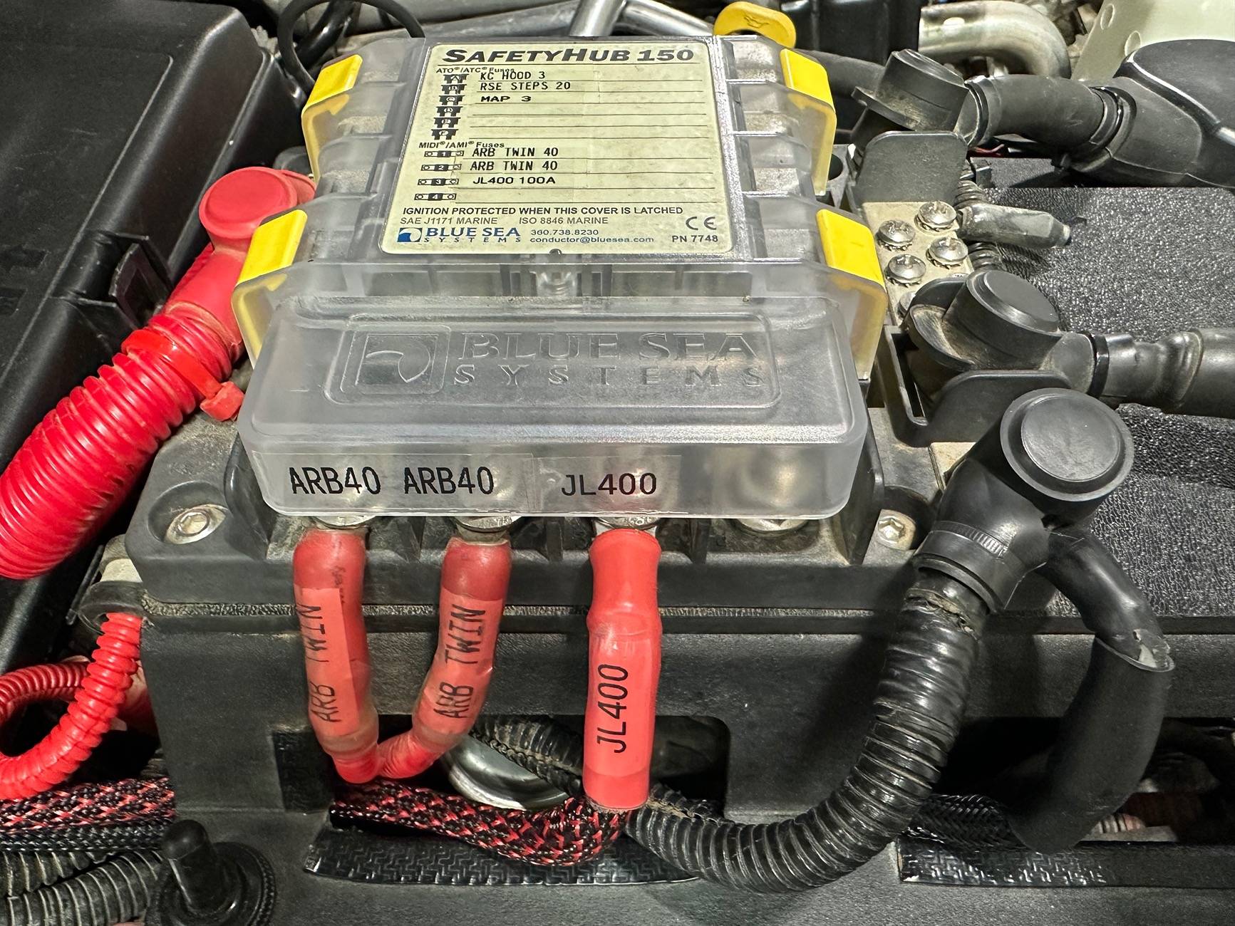

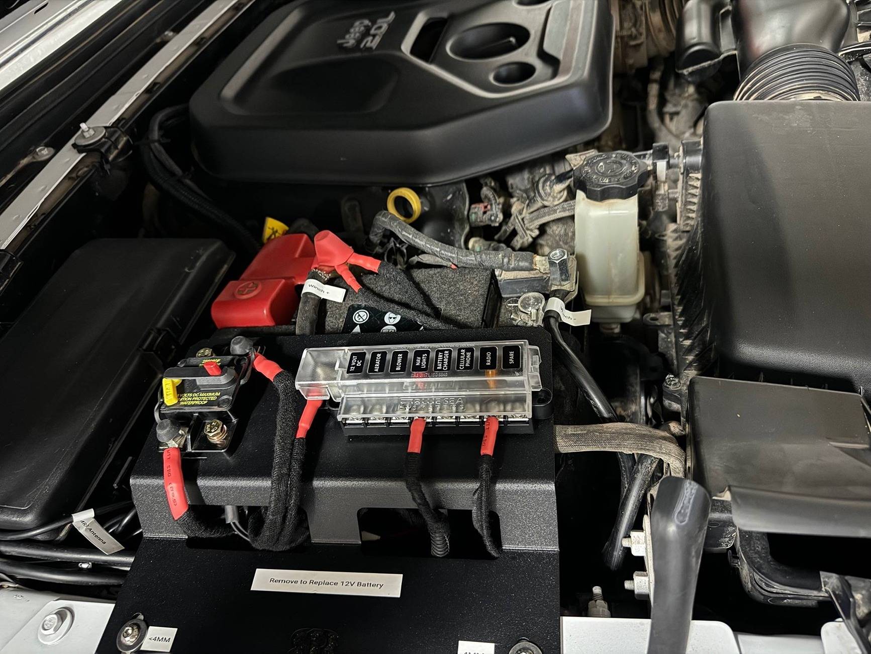

I'd almost guarantee you'll get stranded at some point trying to figure out why the jeep won't start with those.
It's not dirt cheap, but I really like how mine turned out with the 813 panel:
I've had the lever break off on one of these from Amazon.
I like that setup. Where did you find that bracket?
