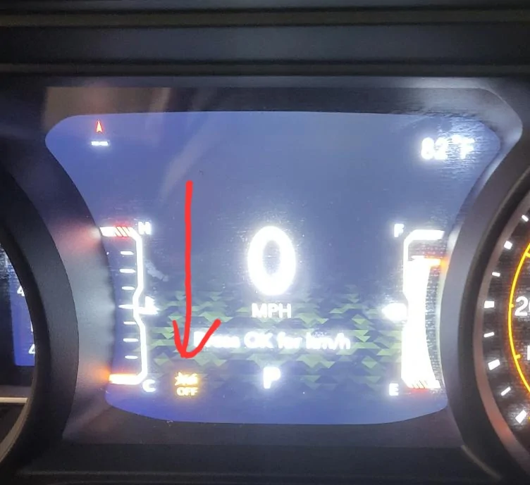

You talking about this?

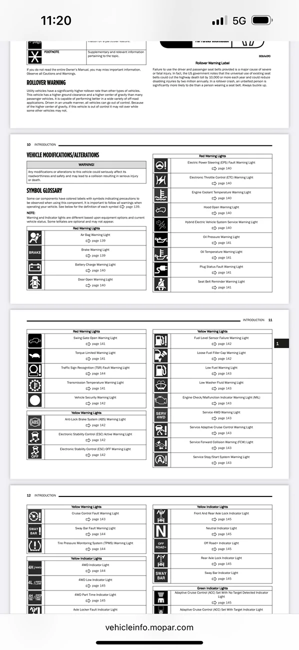

Yup, you know what that is/means
No, not really but google says,
The star/off symbol on the dash of a Jeep Wrangler JL typically indicates an issue with the stop/start system, which may be related to the secondary battery or a faulty switch. It's advisable to have it checked by a dealer to diagnose the exact problem.

  • Things to check.
  • Faulty Secondary Battery: The JL Wrangler has a second battery dedicated to the stop/start system. If this battery is malfunctioning, it can cause the warning light to activate.
  • Loose Connections: A loose wire or connection at the battery can also lead to this issue.
  • Hood Latch: If the hood latch is not properly closed, it may prevent the stop/start system from functioning correctly.
  • Fuses: Sometimes, fuses related to the stop/start system may not be seated properly, leading to the warning light.

I read it as "**** off", have you been abusing the thing? Maybe it's had enough.

Forward warning is my guess. Mine does the same thing and as long as it goes off no problemo. Its in the manual.
