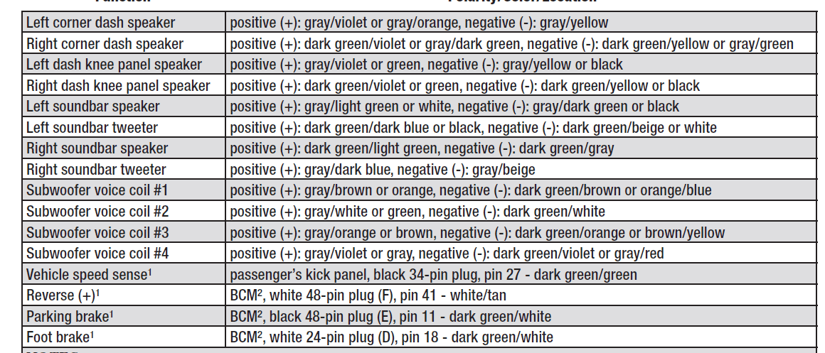

Yeah was thinking of doing that. Chatted with Crutchfield yesterday and they sent me this...

So they are definitely wired backwards. And you can't simply connect the blade connectors to the opposite terminals on the speaker as they are different size terminals.
I removed and swapped the wires from the Metra plug end using a small jewelers screwdriver. There was another thread on this somewhere.
