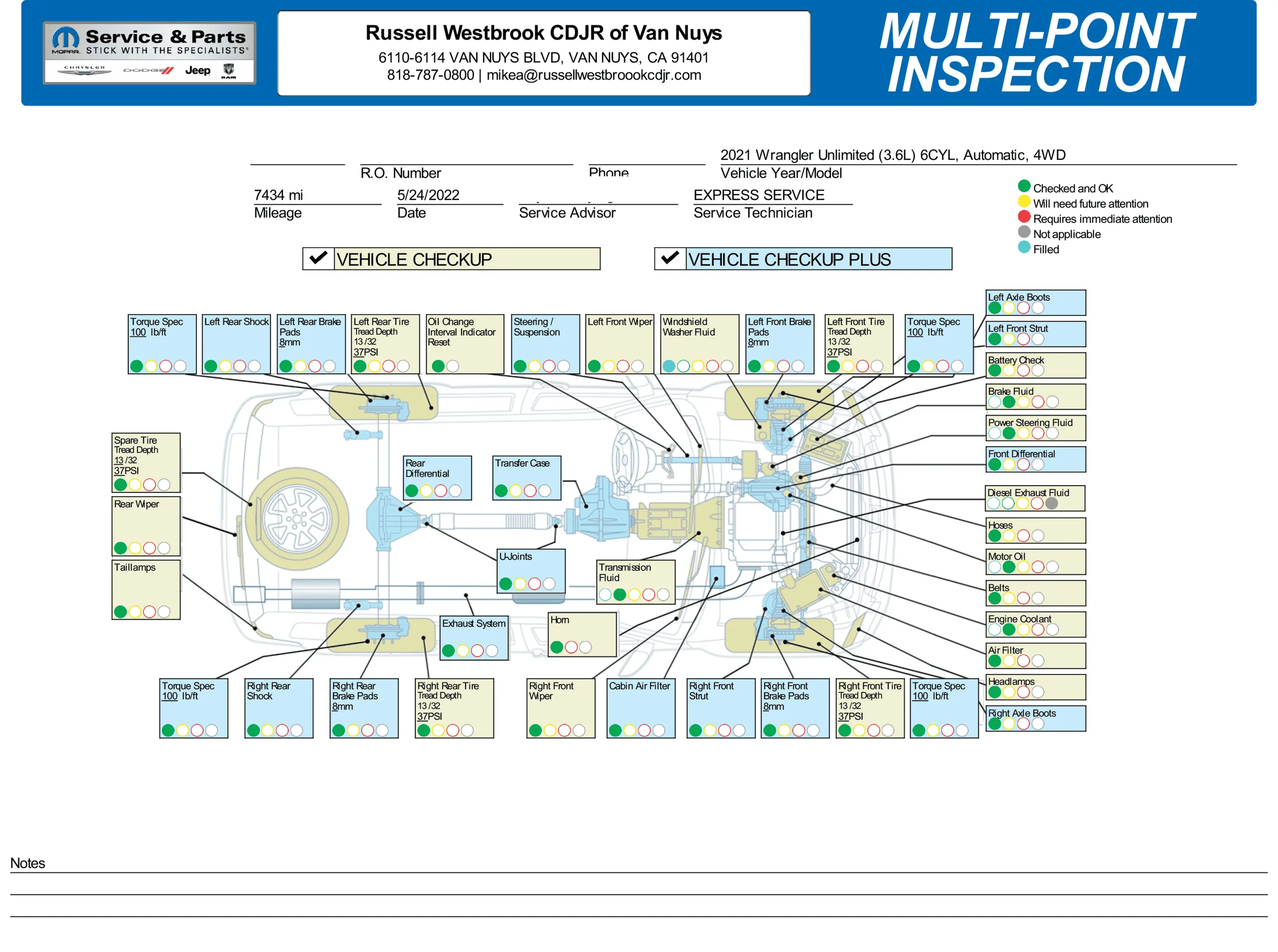

2021 Willys JLU mostly driven on road and only one off-road trip thru Berdoo Canyon in SoCal has a squeak. After the trip the Jeep started to make random squeaks when going over uneven road / bumps (noticeable when windows are down). The Jeep needed an oil change at 7434 miles on the clock, so we took it to Russell Westbrook Chrysler Dodge Jeep Ram of Van Nuys, CA since we had three free oil changes + tire rotations when we got the Jeep new.
When we got the Jeep back it still had the noise. Few weeks later We made a second appointment took the Jeep in and after two days they said it needs new rear breaks and the parts were on order but we can pick up the vehicle till the parts arrive. At this point the Jeep has barley 8004 miles.
It makes no sense to me... specially when they sent the report during the oil change showing there were no issues with the brakes (se below).
What am I missing here........Any input would be appreciated. Thank you all.
Jeep Wrangler JL Question - please help Jeep Report

Brakes don't wear out in 8,000 miles. Sometimes the rears pads go at about 40,000 This depends on ones type of driving.
Squeaks over bumpy roads, would be suspension related. Or if it is a squeaky rattle, then something loose.
Thank you Bill I agree with you, it would be premature at 8K hence my confusion on the stealers findings.
