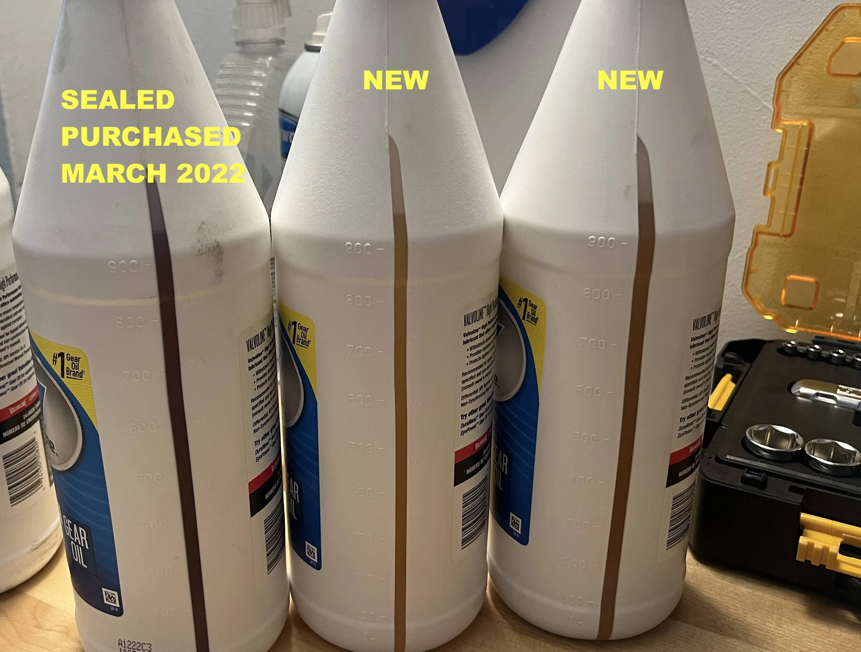

Can I use this sealed oil from 2022 even though it's pretty dark? Can gear oil go bad somehow?

Unless there's a listed expiration date on the bottle, I'd be inclined to use it, if it was my Jeep.
I put 75w140 synthetic in mine even though the owner's manual recommends otherwise. For my M210/M220, the Dana rebuild spec for these axles says to use 75w140 so that's what I'm doing.
Yes.
I've several quart bottles of years-old moto-specific engine oil on the shelf, the result of buying every one at the store due to closeout pricing. I just used two quarts last month when the oil change came due.
Used oil samples are sent to Blackstone Labs for analysis. The reports don't contain any untoward data, nor have there been any observed running or shifting issues.
Proceed as you decide here. ?

Google says as long as it’s unopened it has well over a 5 year shelf life. Some posts I saw said to give it a good shake in case any of the additives might have settled.
Also understand that if it’s not synthetic it’s already a few million years old.

Id use it still for sure. zero worry about it having an issue
