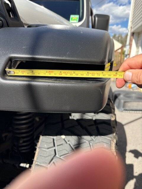

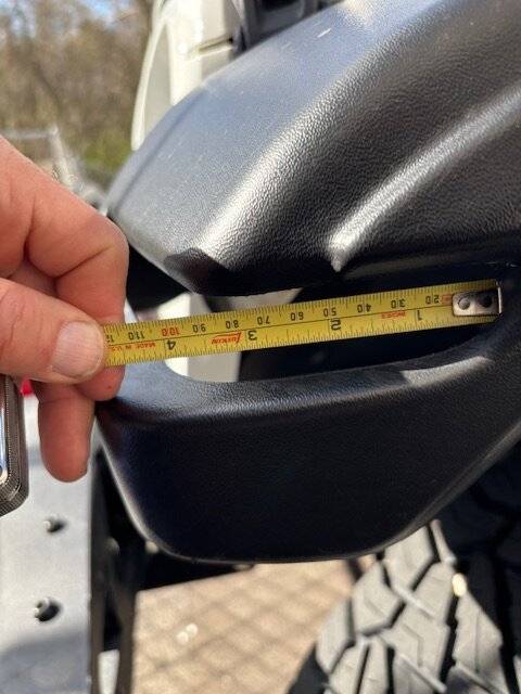

I bought the Quadratec Baja Fender Flares for my 2021 Wrangler. I had talked to a tech their to find a turn signal set of lights to go into the fenders. They recommended the Mopar LED Parking Lamps which are 7" x 4" x 4". The opening on the Baja fenders are only 1-1/4"H x 7"W X 3"on the side for turn signal marker. My question is does anyone have any ideas on what will fit or what they used these fender flares? Thanks ahead of time \.

Their marketing material states they reuse the factory light housing (modified) and get “restyled with a slightly smaller, more aggressive-looking profile”. Based on the installation instructions, you remove the factory tabs on the housing, use their hardware, and install the light housing from the inside of the fender flare. This means the size of the cutout doesn’t matter, and part of the light is covered by the flares. Hope that helps!

Good morning Brett,
So for these we used the standard mopar ones from the oem flares, with a few modifications! I've gone ahead and attached the Instruction sheet for these, please refer to step 10 in the I-sheet. Hope this helps! Feel free to reach out with any more questions or concerns you may have!
