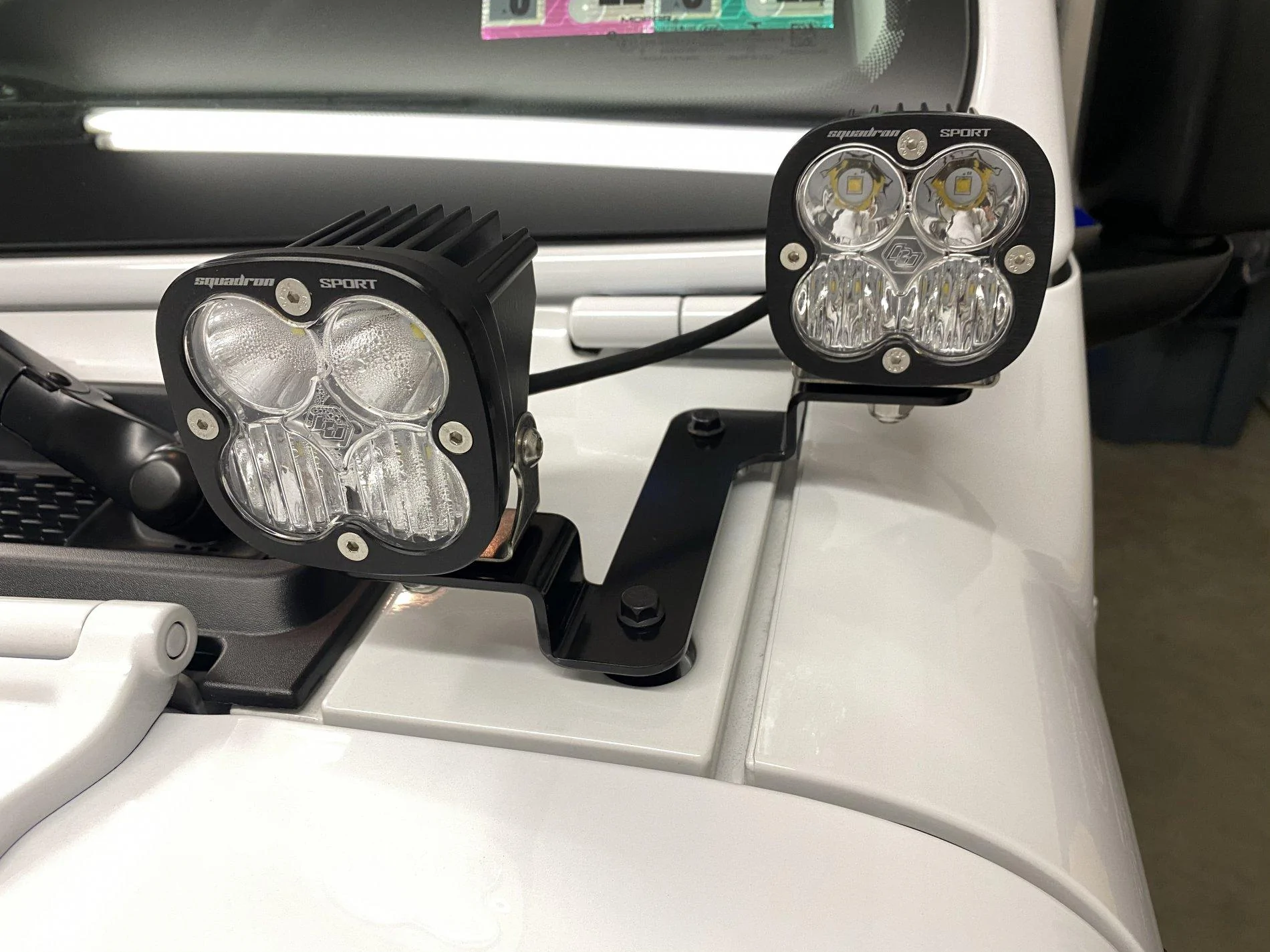

Take off the cover. Check it for damage that might let in water. Check the sealing gasket to see if it’s pinched or broken or out of place. Reposition or replace as necessary. Wipe the moisture out and reseal it. If this fixes the problem you’re great. If not, send it back to Baja for repair or replacement.
