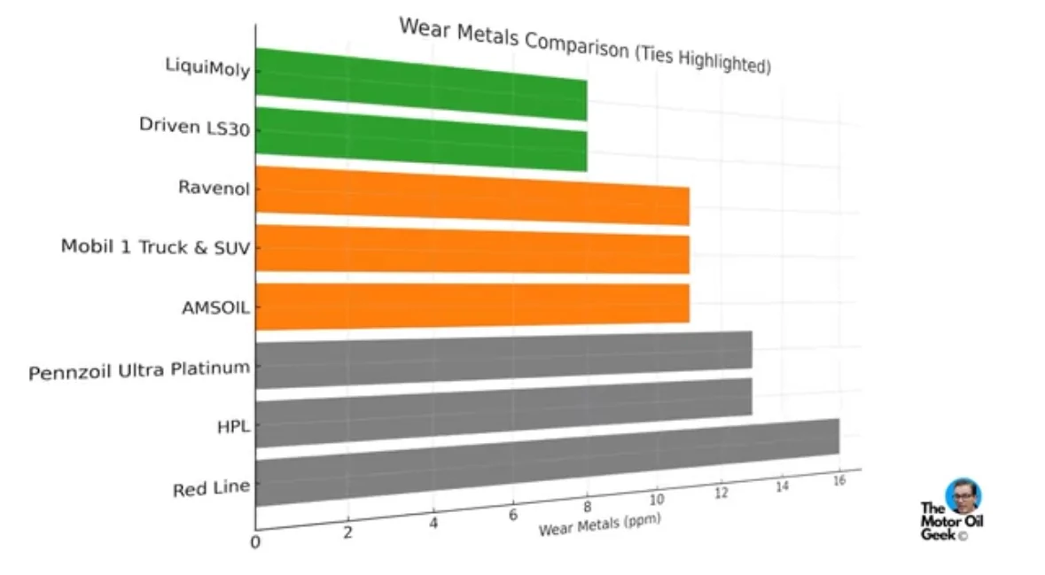

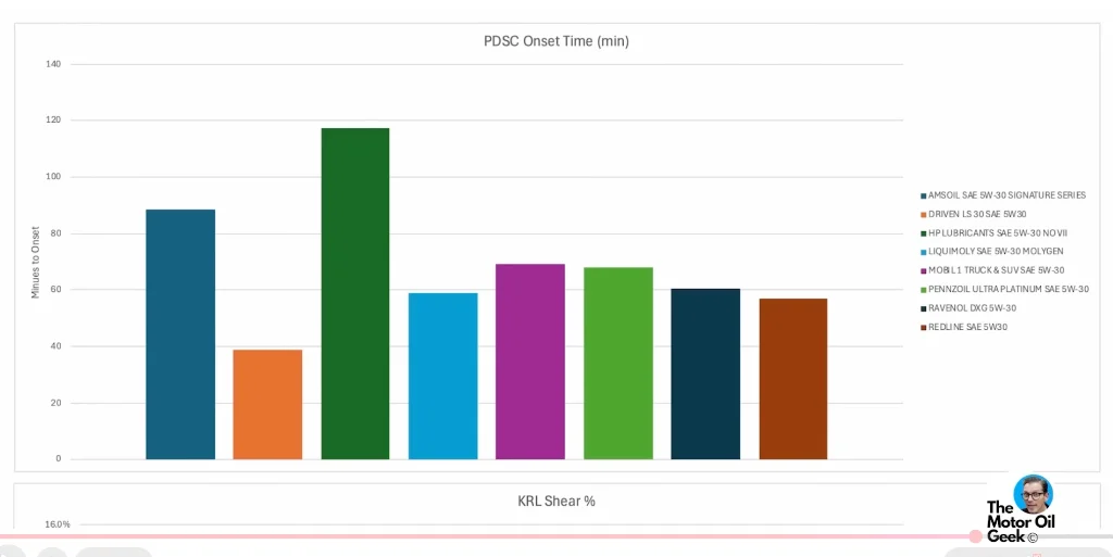

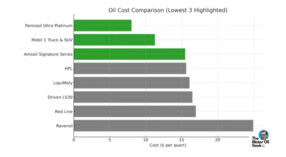

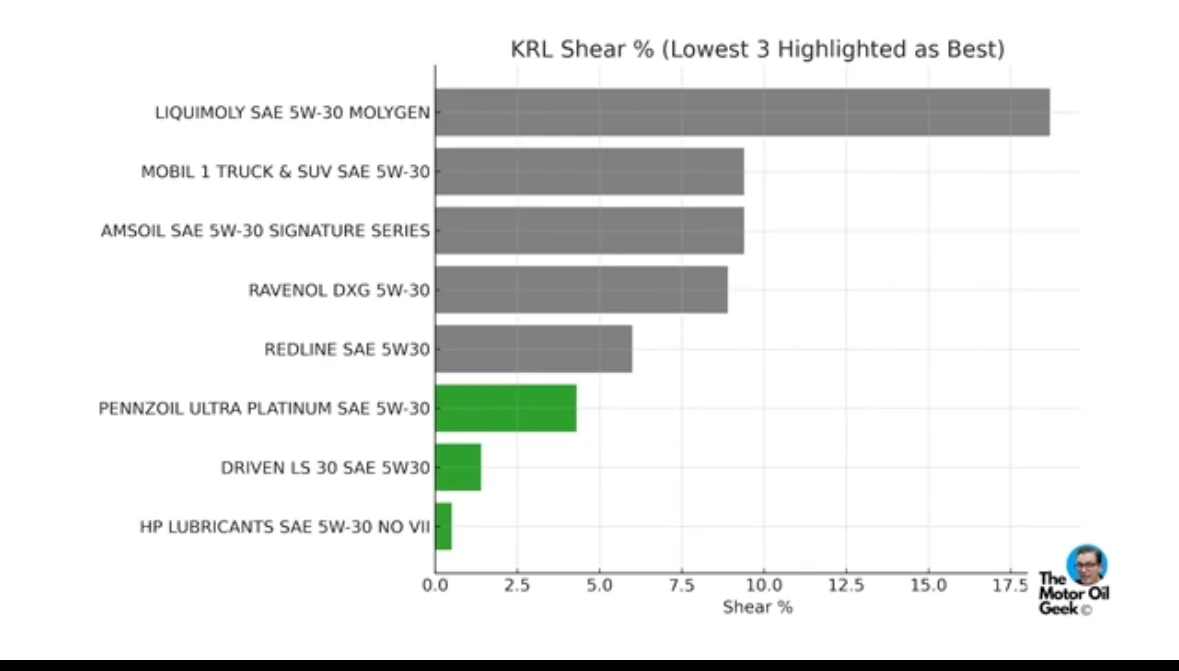

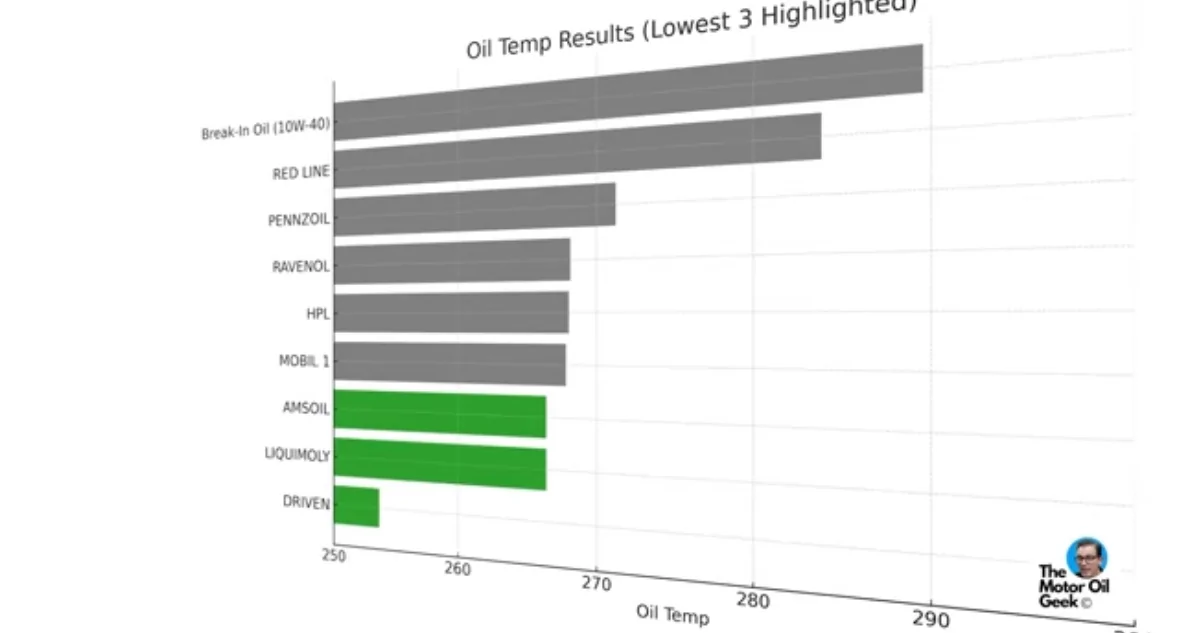

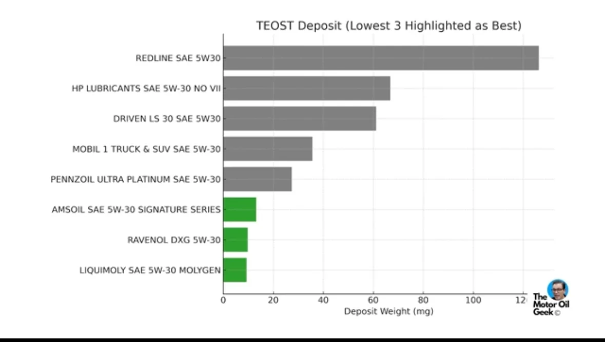

It is crazy. I don't understand how PUP achieves such things with its GTL. Test done by Motor Oil Geek where he puts oils in a machine that chews the life out of them.

I just wish PUP had a higher HTHS and was in thickness closer to 5W-40 than to 5W-20. The lawnmower 2.0T is so much noisier with PUP than with Mobil1 ESP.

You know I’m just going to go ahead and admit that I don’t like PUP. I think in terms of value for the money it’s great, but it’s not a premium oil. It’s “the best” middle class oil out there. I really don’t get on board with its HTHS value. And before folks put me in a specific drawer: I think even less of Amsoil.
Redline and Driven are built-for-purpose oils that have no business inside a Jeep engine so the comparisons are moot to me.

From the result above, I think I will give a try to mobile 1. My priority are on wear protection, torque and heat values. I change my oil every 3k so the rest is not that much of a issue. No I cannot bring myself to go liquid moly

The torque difference on a 3.6 might be 2-3ft/lbs between the best and pup. Never going to feel that.

never hurts to try new oil mobil1 is great oil no doubt but 2 or 3 ft/lbs of torq will not be noticeable in a 5000lb vehicle.. if you look at the difference in torq between the top performer and everything else in a V8 making ~470lb it is not that much no more than 4 or 5 ft/lbs so within 1%. The graphs with their color and scaling make it look more pleasing to the eye but just like wear metals there really is no difference.
