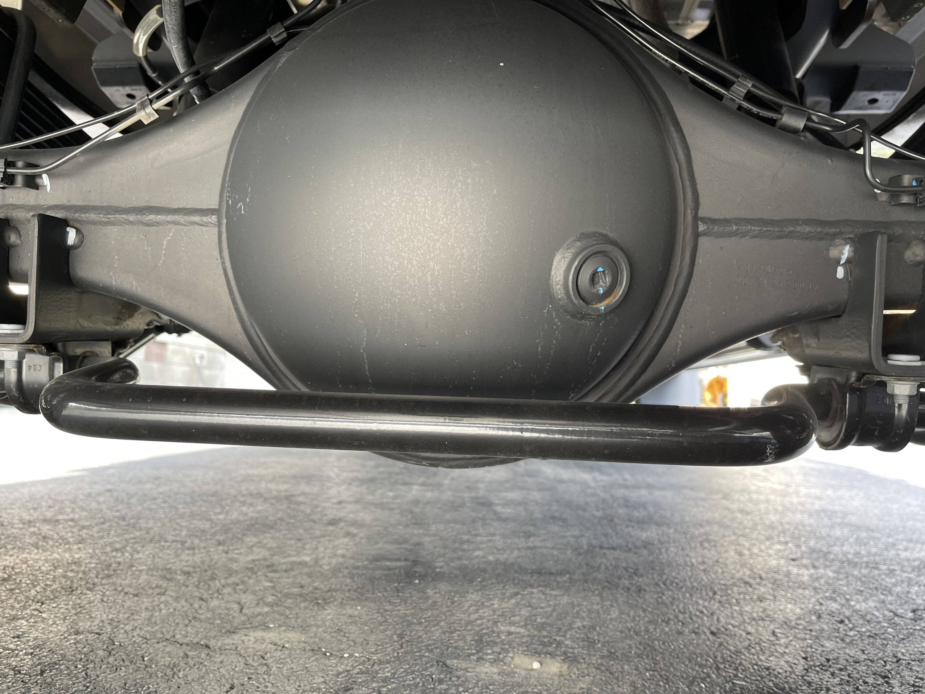

I am not going to argue but “most” people have historically added till the fill hole weeps on all things. Including differentials. But I think that is not the case anymore. Every vehicle I have bought in the last 9 years was not filled to the fill hole on anything. RAM or Jeep. My JK MT was not full, none of the Diffs were to the fill hole. My Ram is the same way. The AAM axles actually now has it pressed into the cover. Sorry blurry, it is dark under there:)

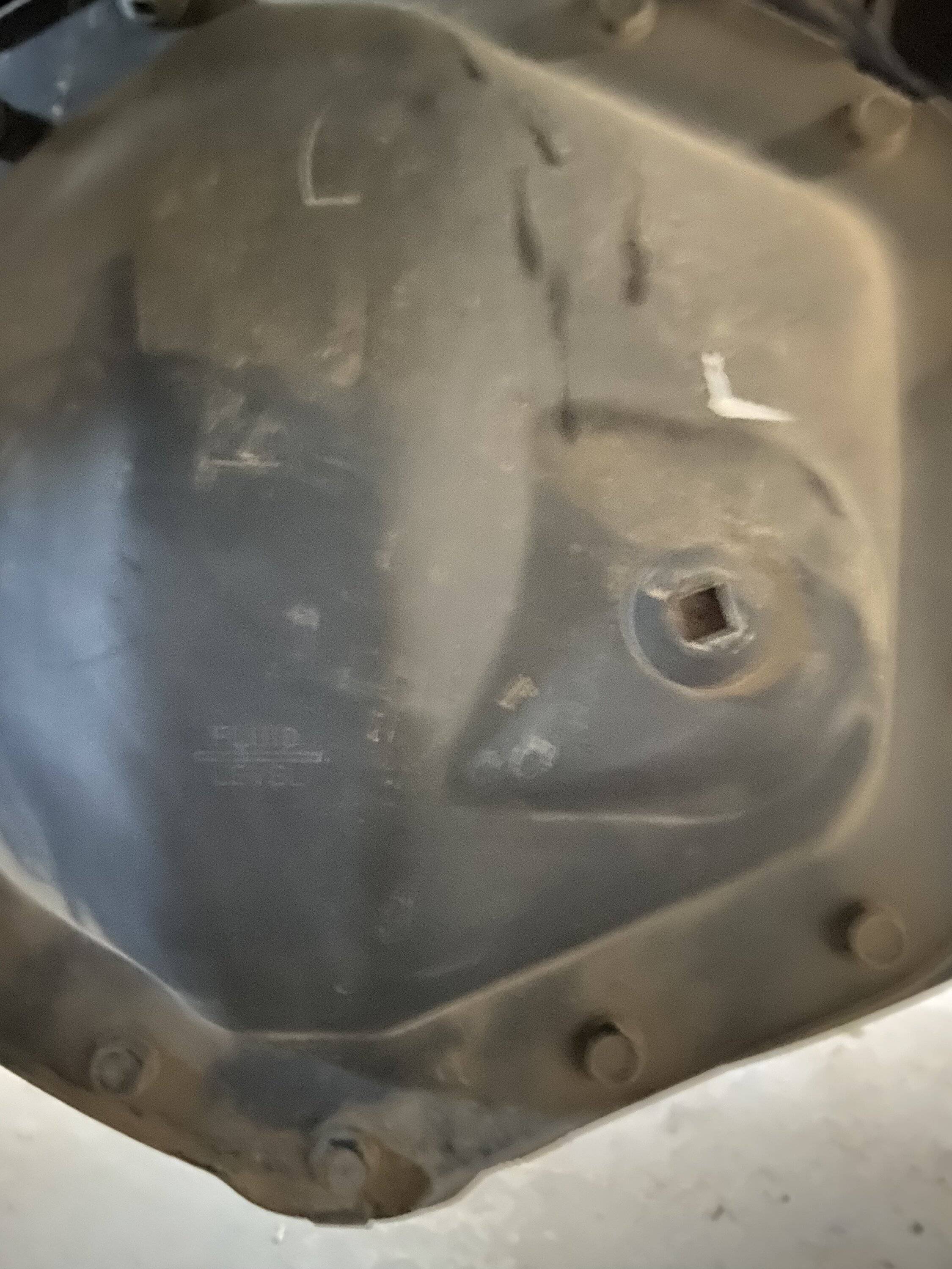

If only my RAM had that nice, reusable differential cover gasket......
