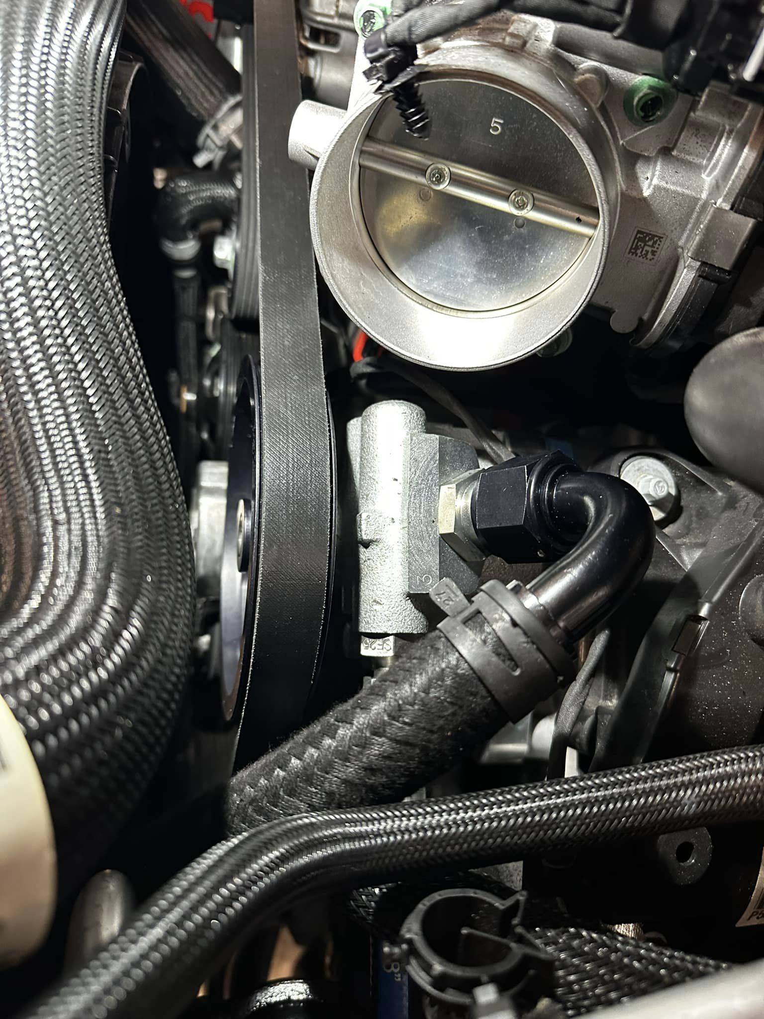

I am getting ready to put my tons on (14 bolt\60 front ECGS). After installing the psc kit i noticed the kit came with -6 return lines so even on the JL they are -8. So quick call to PSC and they confirmed should be -8 so not big deal to swap but for those who have installed it already i check your lines. As far as the install typical PSC no directions for 392 but pretty straight up if you installed their kits.
Better bracket then JL for hyd reservoir and vent but the pressure lines from pump to gear box is way to long, i have new one made while installing the axles and atlas.

I have the psc kit on my 392 installed by a shop. What and how would I check?
look at small line on reservoir, if it looks like mine it’s -6, 11/16 wrench the -8 bigger
