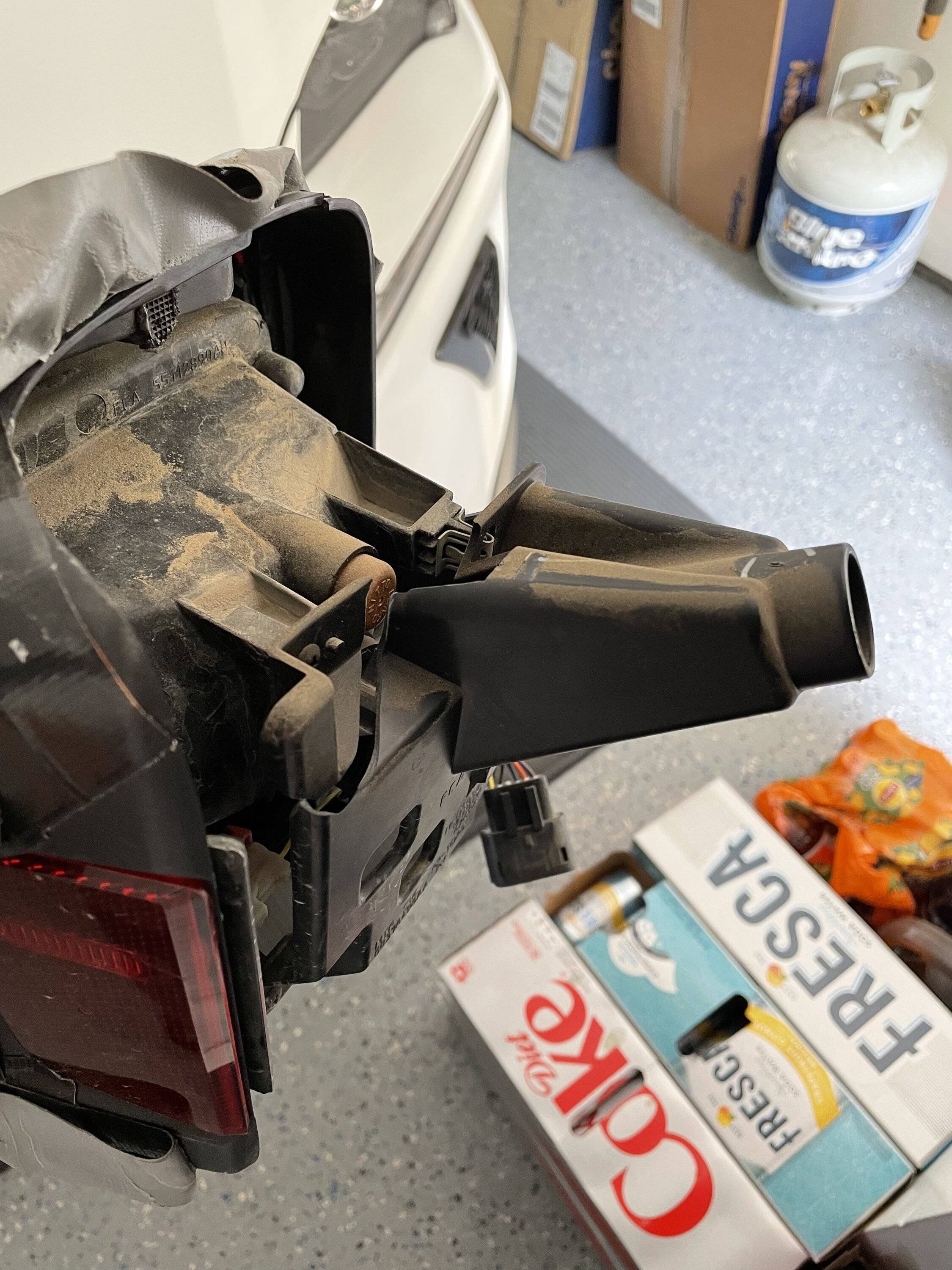

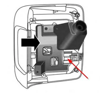

This is the single bolt and what the back of the light looks like when it comes out. I broke mine out on the trail, slid into a tree. That plastic bolt-spring works by compression and sucks the assembly into the body, so go easy on it removing and installing.

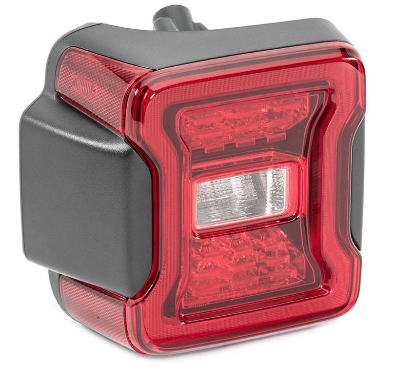

There is no way to replace the broken red lenses or a faulty LED board on a JL's LED tail light. You will need to replace the whole tail light.
Factory Led tail light:
Jeep Wrangler JL Problems figuring out how to replace light bulb in tail light Taillights2
For a replacement tail light, do look to forum classifieds, eBAY, FB Marketplace, etc. for pull offs that guys/gals are trying to sell.
Also, you could go with an aftermarket tail light offering.
With a Halogen, JL tail light, yes you can do a bulb change but the red lenses in not replaceable.

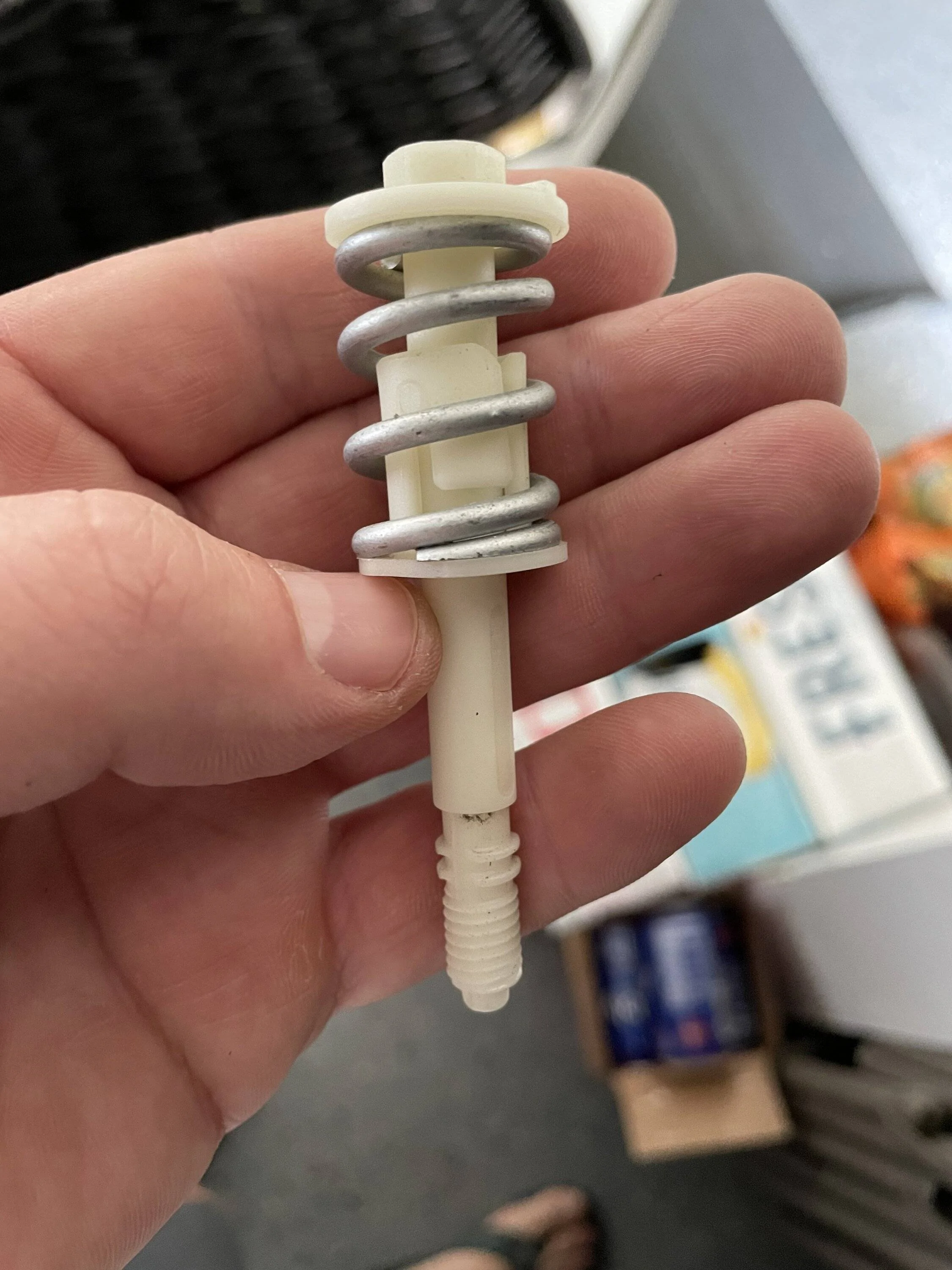

If you break the white plastic screw with the spring that secures the JL LED or halogen tail light, the Mopar part for that is... Taillight white spring screw: Mopar (06512356AA)

Thanks. I've gotten the tail light completely out and everything off. I just couldn't get to the final step of getting to the lights. Now I know why. Why does Jeep make the reverse lights so dim? I have to use the brake lights to be able to see what's behind me, on the camera.
