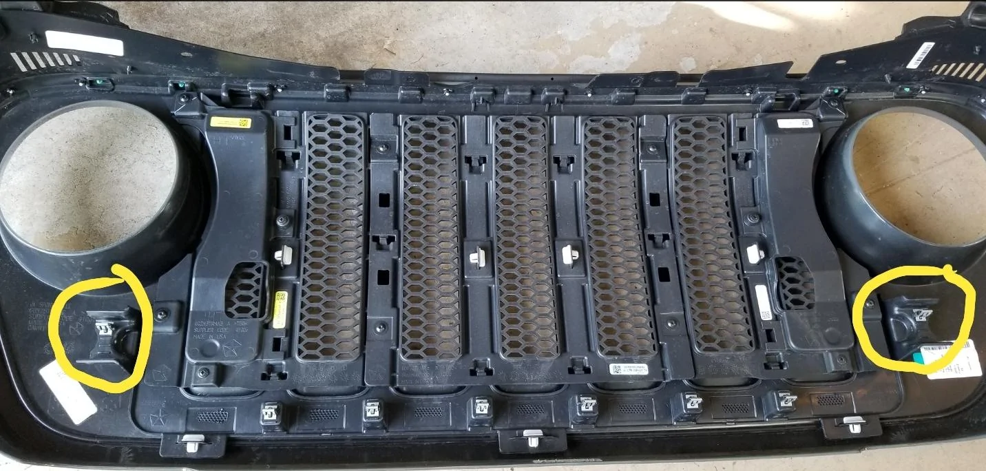

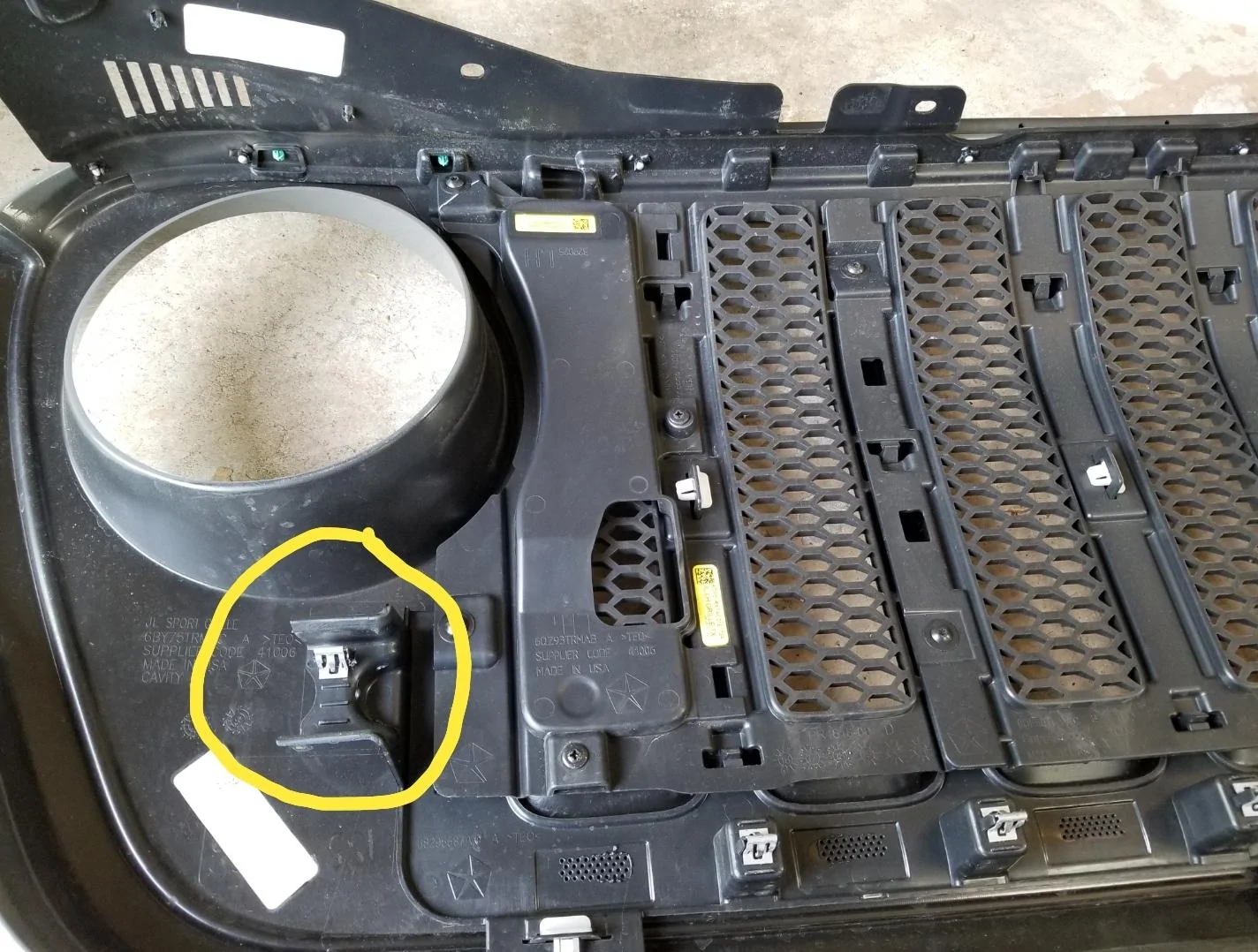

Pull straight out, and pull hard. Make damn sure you pulled all the plastics rivets out of the top first, but that’s all there is holding it on.
Thanks so much! There were two clips holding the mesh grille insert to the Jeep also. I don't remember anyone mentioning these. I had to pop these two by hand.
Jeep Wrangler JL Headlight and Fog Light Bulb Replacement Screenshot_20190430-171249_Gallery
Jeep Wrangler JL Headlight and Fog Light Bulb Replacement Screenshot_20190430-171108_Gallery

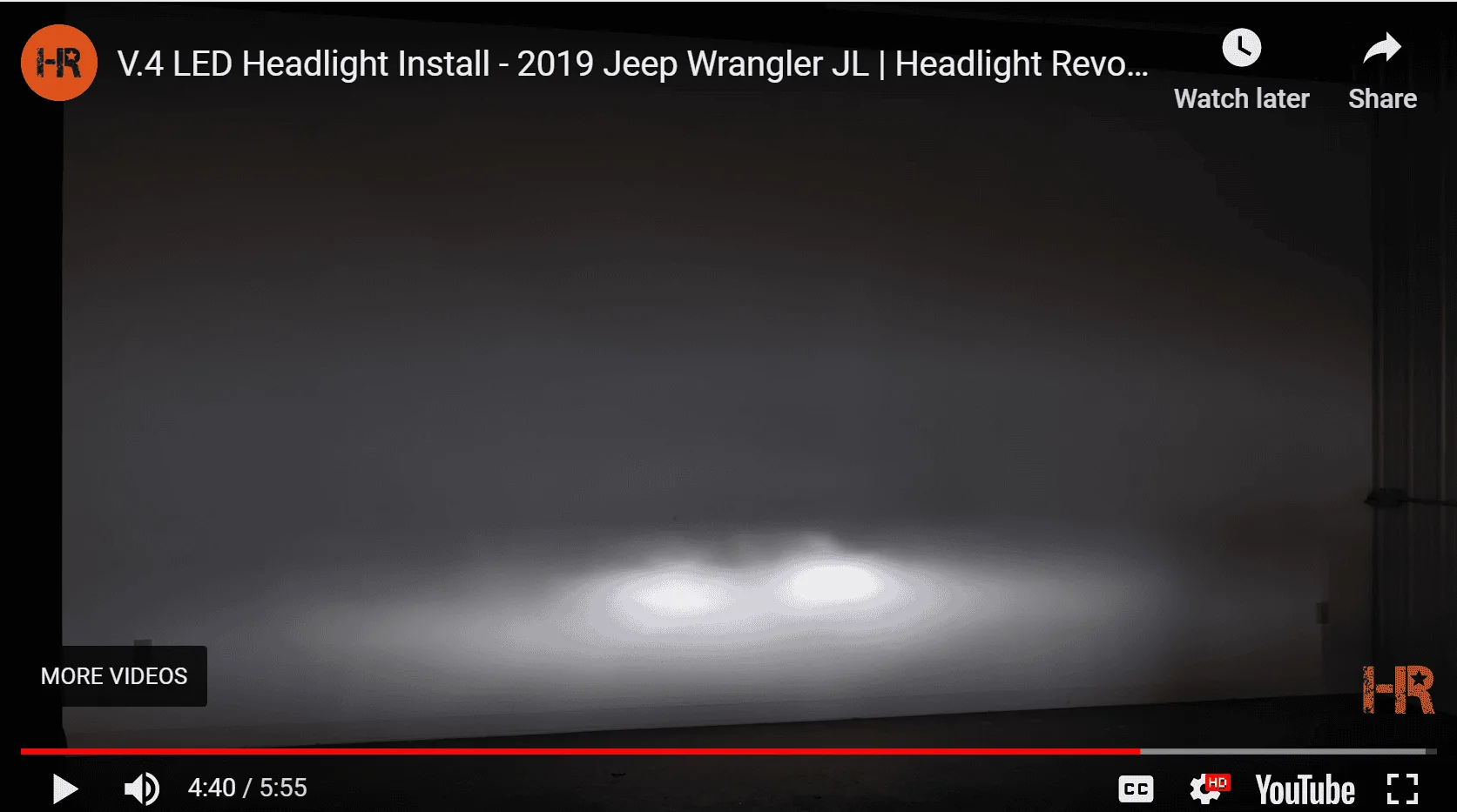

Fast forward to 7:05 to see the Supernova V.4 bulbs in the halogen housings. Even sharper cut-off than the CrystaLux bulbs I showed earlier in this thread! LED bulb tech continues to get better. These things are amazing, and I haven't even made adjustments to the aim yet to dial them in. VERY impressed.

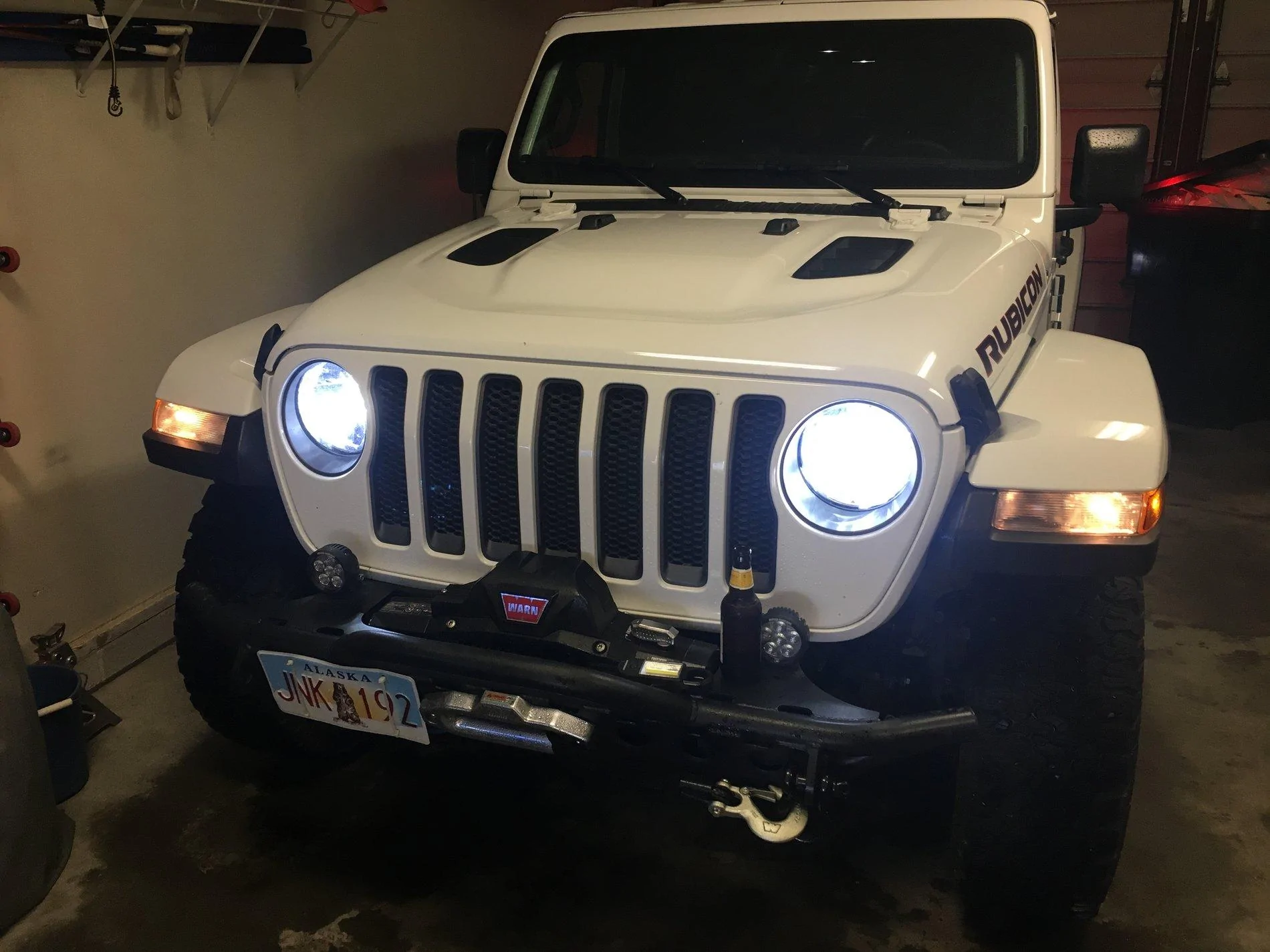

I just swapped in Beamtech H13s, the 8K lumens with passive cooling. Difference is pretty big, but unfortunately, living in AK, it’ll be a little while before it gets dark enough to really put them to use. Looks awesome, cutoff is sharp and appears to be in the same spot as the factory halogens (at least on the wall).
I didn’t remove the grill. The driver’s side had plenty of room (JLUR with V6), and for the passenger side, I pulled out the air box which has two bolts and “sticks” in a mount on the bottom. Once out, I had tons of room. My winch actually touches the grill, so I didn’t want to go there. The bulb and wires all fit back in the headlight can and allowed me to reinstall the dust cap. Pretty simple overall.

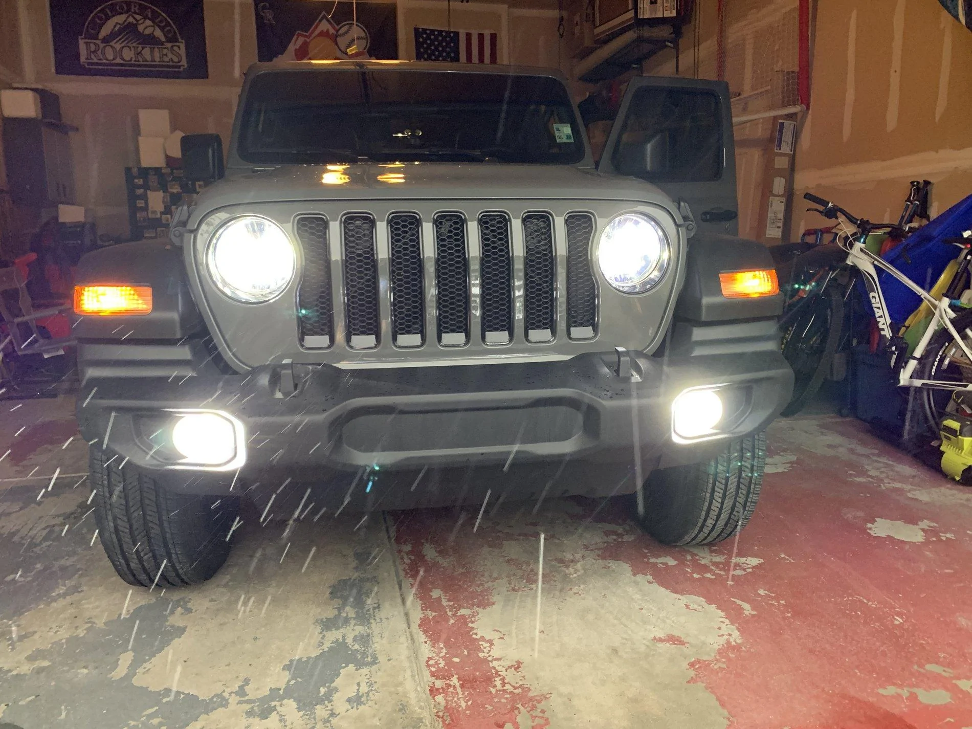

Here is difference with one changed. From cut off perspective this doesn't seem to be an issue.
Head lamps
Fogs (little bit more work 5 bolts under wheel arch)
Jeep Wrangler JL Headlight and Fog Light Bulb Replacement IMG_20190902_200930

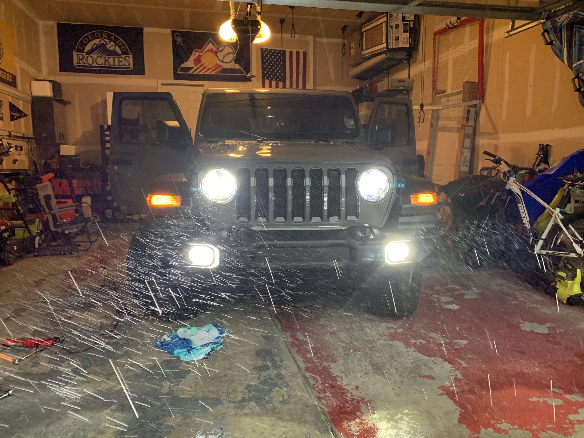

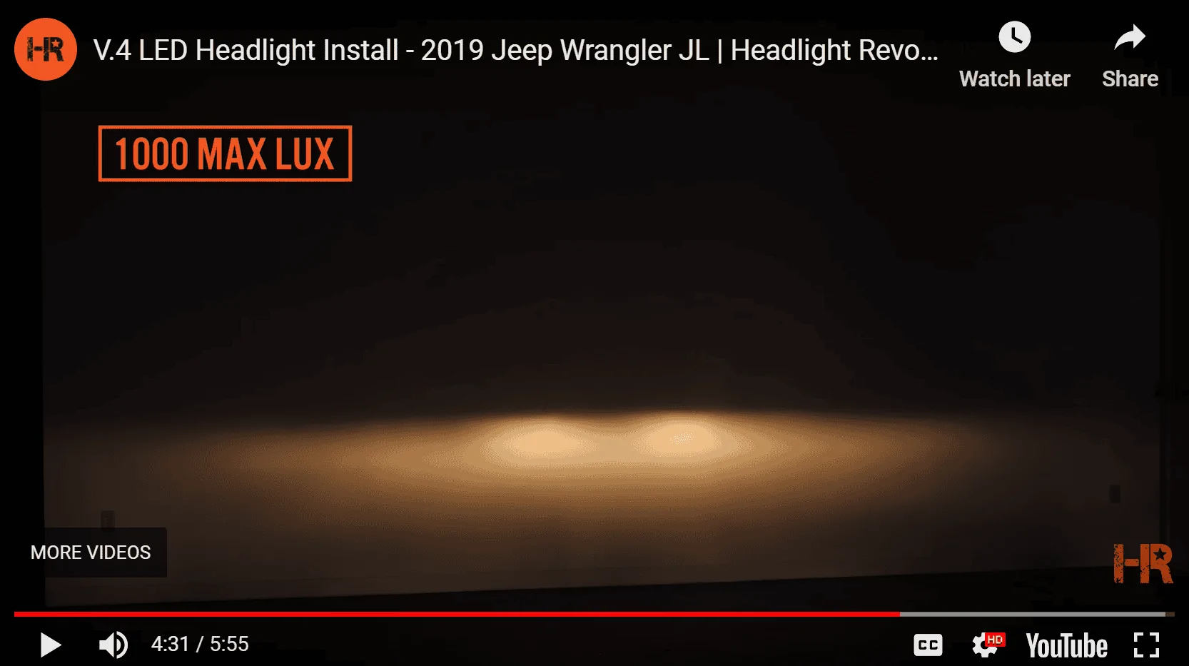

we've gone back and forth over at the gladiator forum about putting LED or HID bulbs in a halogen reflector housing and that it supposedly blinds oncoming traffic, if you look at this photo, there is like no light above the cutoff line, it is black.
Jeep Wrangler JL Headlight and Fog Light Bulb Replacement upload_2019-9-4_12-2-29
But if you look at this one, you do see white above the line, so does that mean you are blinding oncoming traffic?
Jeep Wrangler JL Headlight and Fog Light Bulb Replacement upload_2019-9-4_14-31-42
