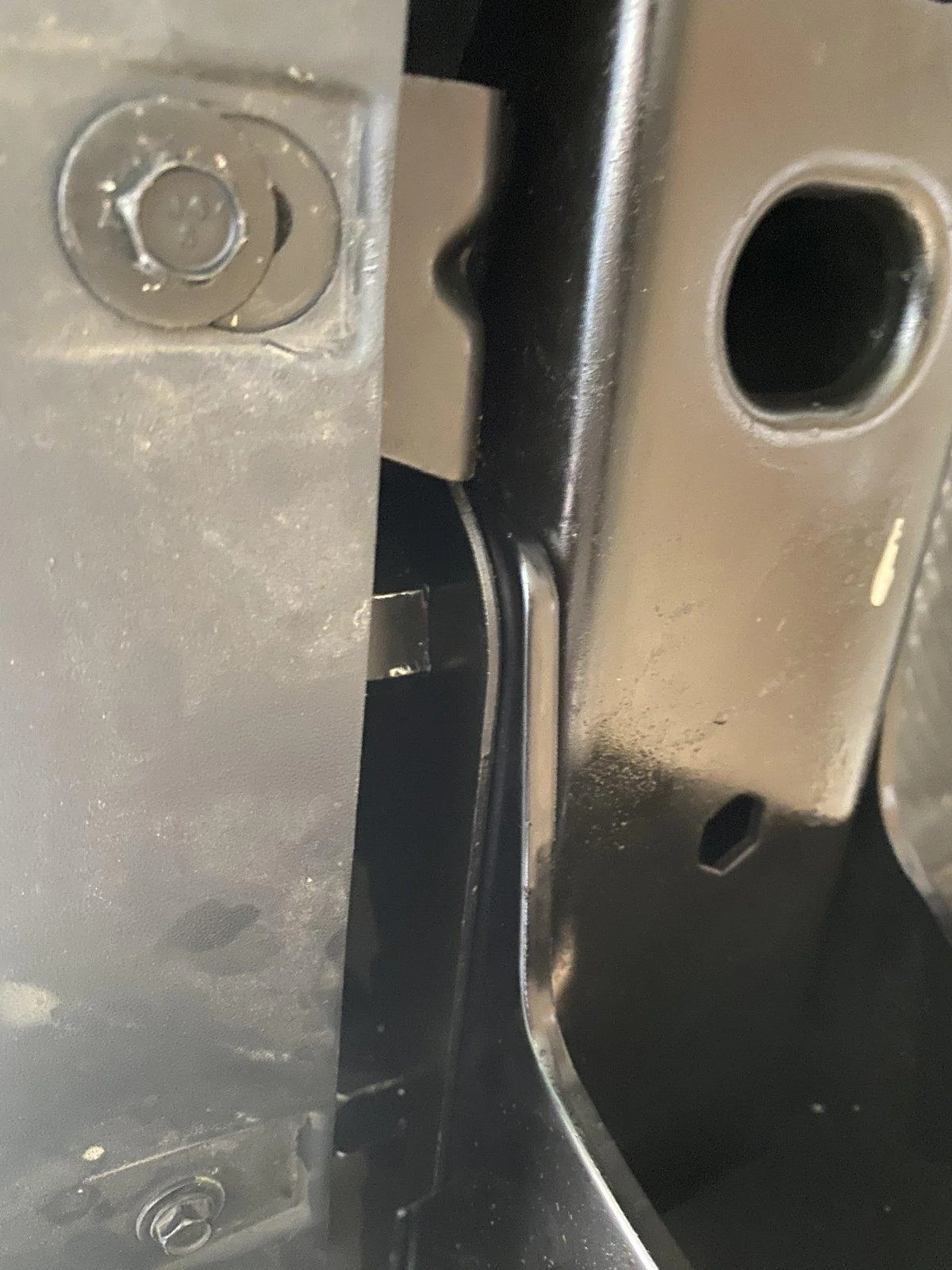

Hi all,
I’m having an issue installing the Mopar hitch to my jeep. In all of the install videos and threads I’ve read, no one seems to have encountered the problem I’m having with the two black bolts that seem to be welded into the frame of the car - see photo. I’ve tried using liquid wrench to loosen them but it’s had no effect. Any suggestions?

Lol, yep. Those are welded on. Rear hitches come is several very similar variations. From my personal experience, this usually means your hitch is from a different stock bumper config.
Damn - thanks though. So back to the store and buy a new one then?
That is an inner structure support of your plastic bumper, your hitch needs to be sandwiched in between this piece and the frame rail. Unfortunately you need to take off your bumper cover to do this, adds a little bit of time.
Ok, thanks. So it is the correct part, I just need to figure out how to remove the bumper cover?

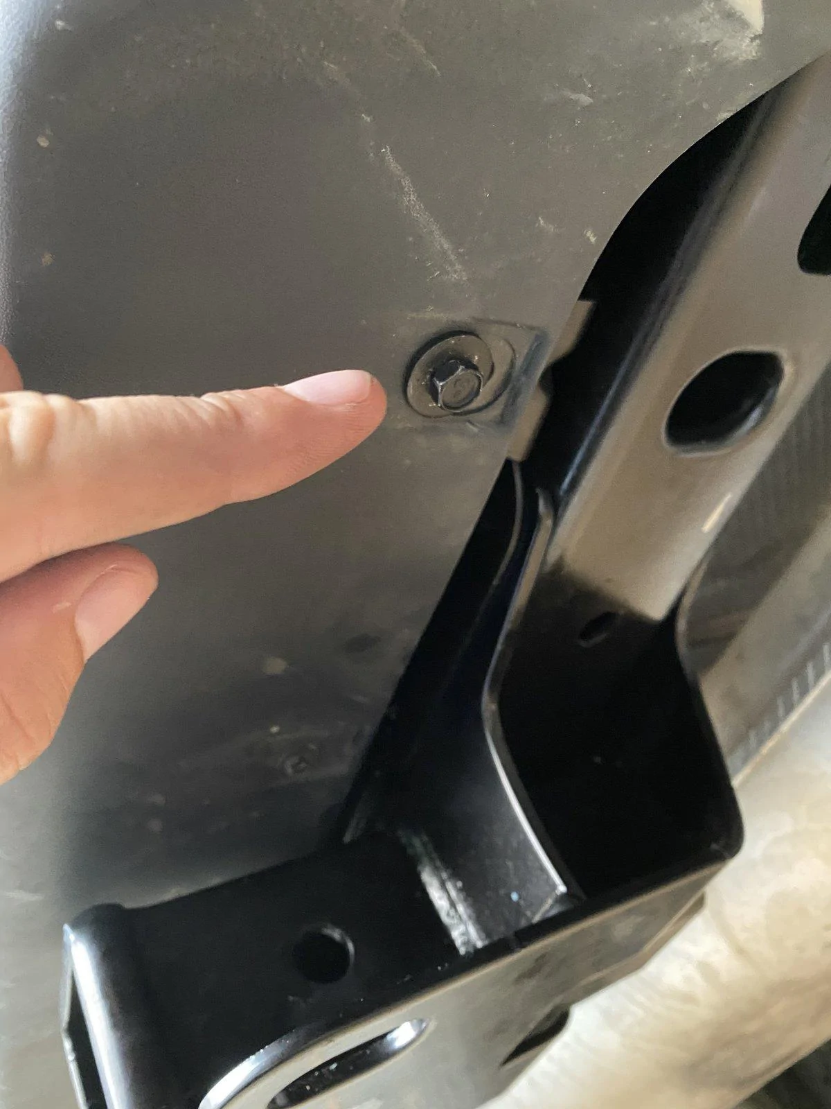

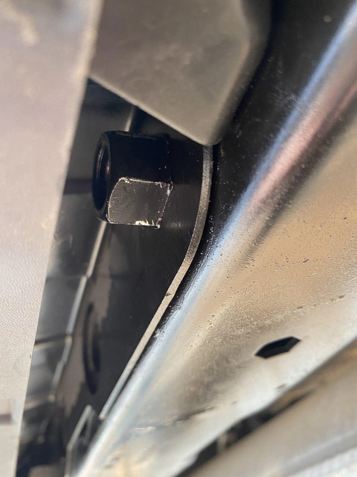

Update for anyone else who runs into this problem with the JL Sahara Unlimited plastic bumper. I was able to install without removing the rear bumper. I removed the two small screws under the plastic bumper, that allowed me to lift the steel chassis up high enough to attach the hitch. I had to force the bolts through with a little bit of force but it worked.
The hitch sandwiches between the two metal parts.
see images below

I know it is just a few years' old post. Thanks again for sharing your approach. i tried hard sandwiching the hitch and does not go in and holes are not aligned (especially the bolts on the inner plate). If anyone has any idea how to remove the plate without removing the bumper that would be great.

I got the Mopar hitch with nuts welded on (part 68251844AB). There's no way to sandwich that hitch and its welded nuts between the pictured bumper plate and the support beam, so I ended up removing the bumper and then removing that existing plate. I seem to recall I could have removed the plate without removing the bumper, but I'll have to check on that when I get home. I've got a 2022 JLU, but I think the setup is the same for the 2018-2023 models. Not sure about the 2024 model.

I checked the plate I removed, and it looks like I could've left it in place. There are holes in the plate to allow space for the hitch's welded nuts. There are only 2 bolts holding the plate in place (as pointed out by @Ciaranmc09). By removing those you may be able to reposition the plate without removing the plastic bumper, but it's possible the plastic bumper has protrusions obstructing the plate and holding it in place.
