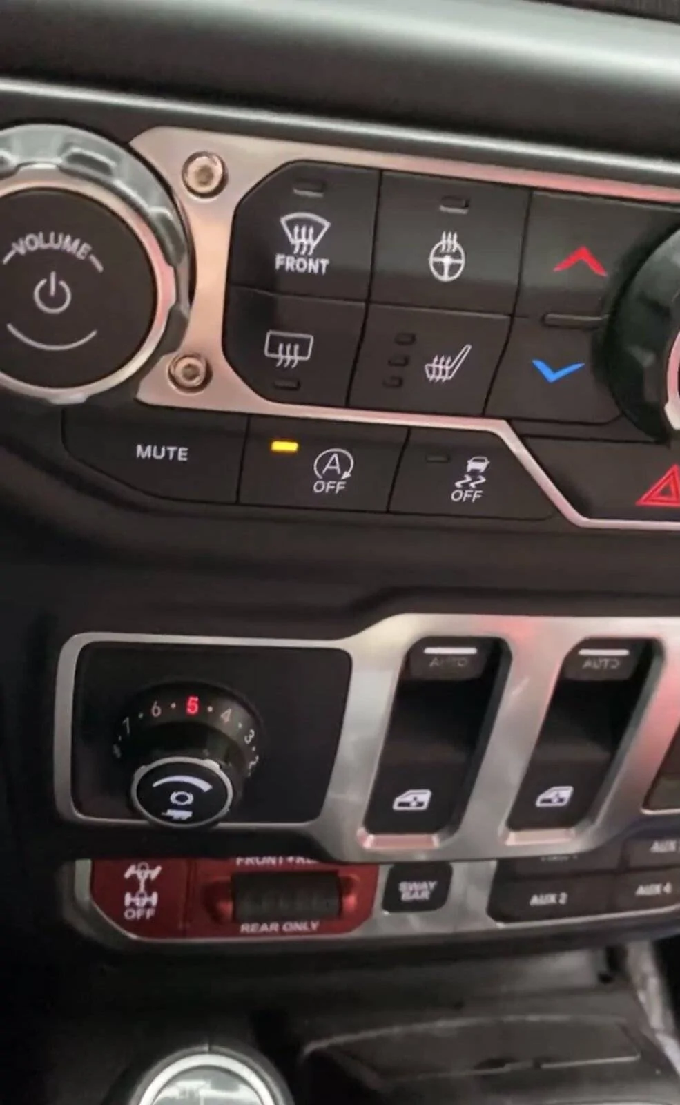

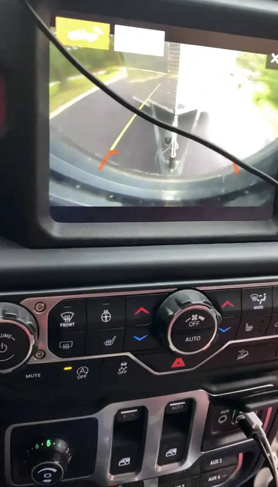

Jeep JL Rubicon 2-door 2018. With a Tazer mini and a factory tow package, I was able to integrate the Mopar trailer brake controller. I substituted the factory cable for the Tekonsha 3073-P Brake Control Wiring Adapter - (it uses a capacitor to smooth out the electrical current and prevent check engine light). And that’s about it. I haven’t seen anyone else post about this regarding the 2018 JL and wanted to confirm you can do it!
