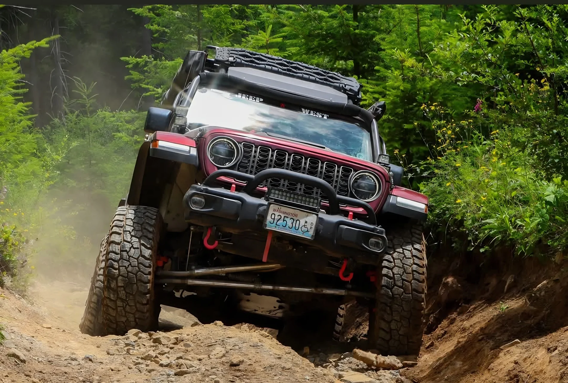

I ran some trails at Moab and lost my power steering one day due to overheating. It didn't stop me but it was tough with no power. I had the APEX kit installed at Jeep West. Took about 4 hrs. No overheating since. And the add'l steering power is a bonus. '21 JLURD on 37's
