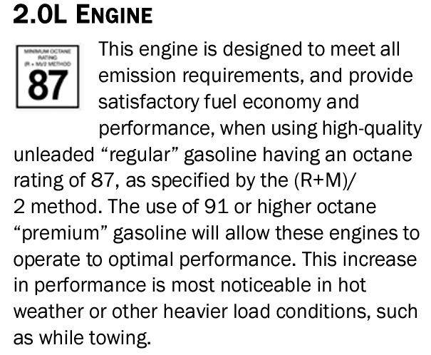

Because where I live Premium is a dollar a gallon more.
Ah - just noticed you have the 2.0l turbo. 87 won't hurt it at all - the knock sensors will retard timing and protect the engine. 91/93 will improve performance and maybe fuel economy a tiny bit.
In the 3.6 you'd just be wasting money.

For everyday use, You and the engine would be better served with a high quality, high detergent gasoline like "Top Tier" graded fuel. Ref. p. 506 Jeep manual.
Yes, but for a given brand of fuel, higher octane won't have better detergent properties than lower octane.
