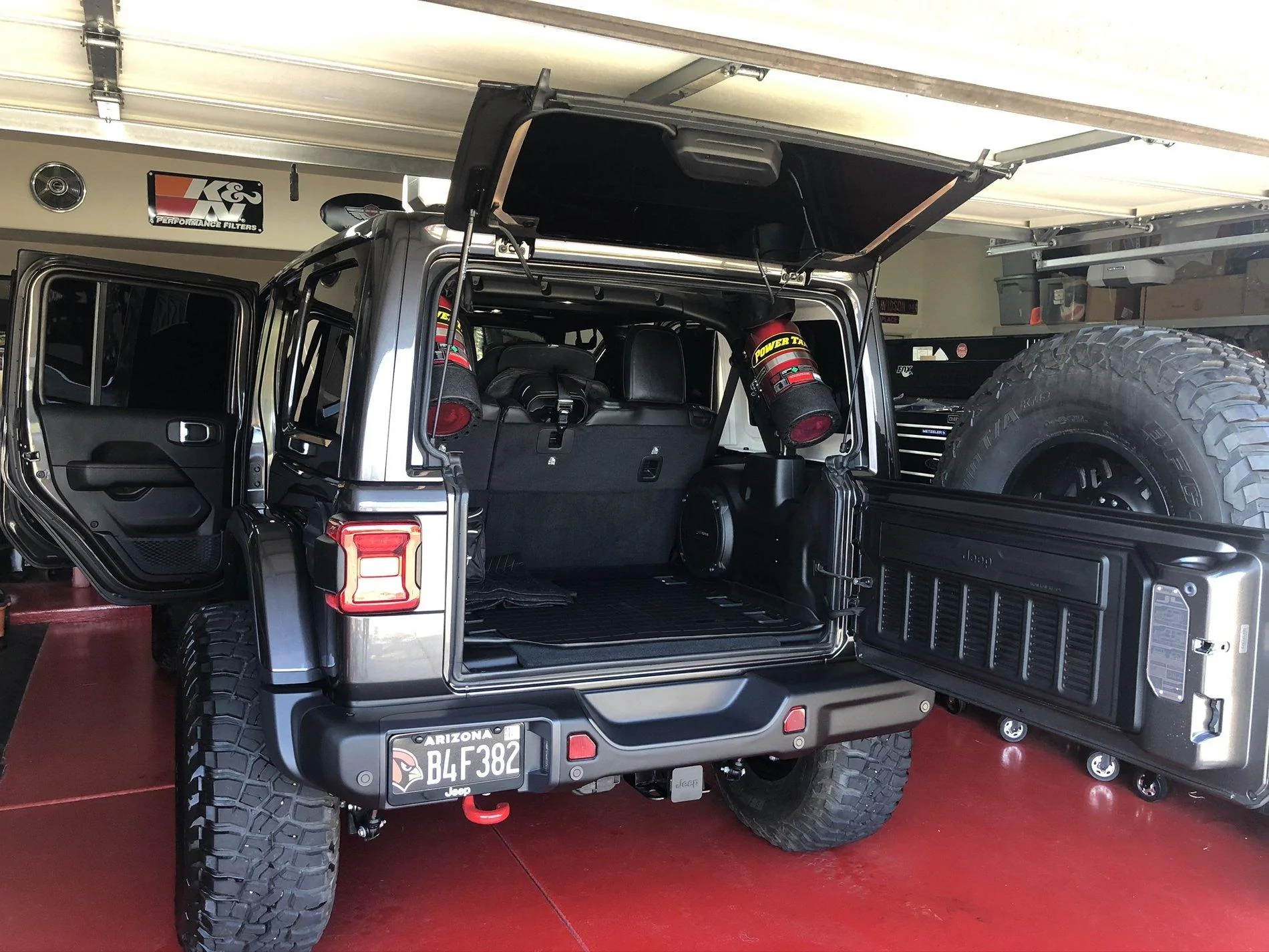

The power tanks are nice. My father in law had an arb compressor and he ended up swapping it out for the power tanks. I was sold. I run 2 10 lb tanks. The setup is nice and their customer service is great. As mentioned above $20 or so to fill up one, how often you need to do it is dependent on tire size and what u air down to.
