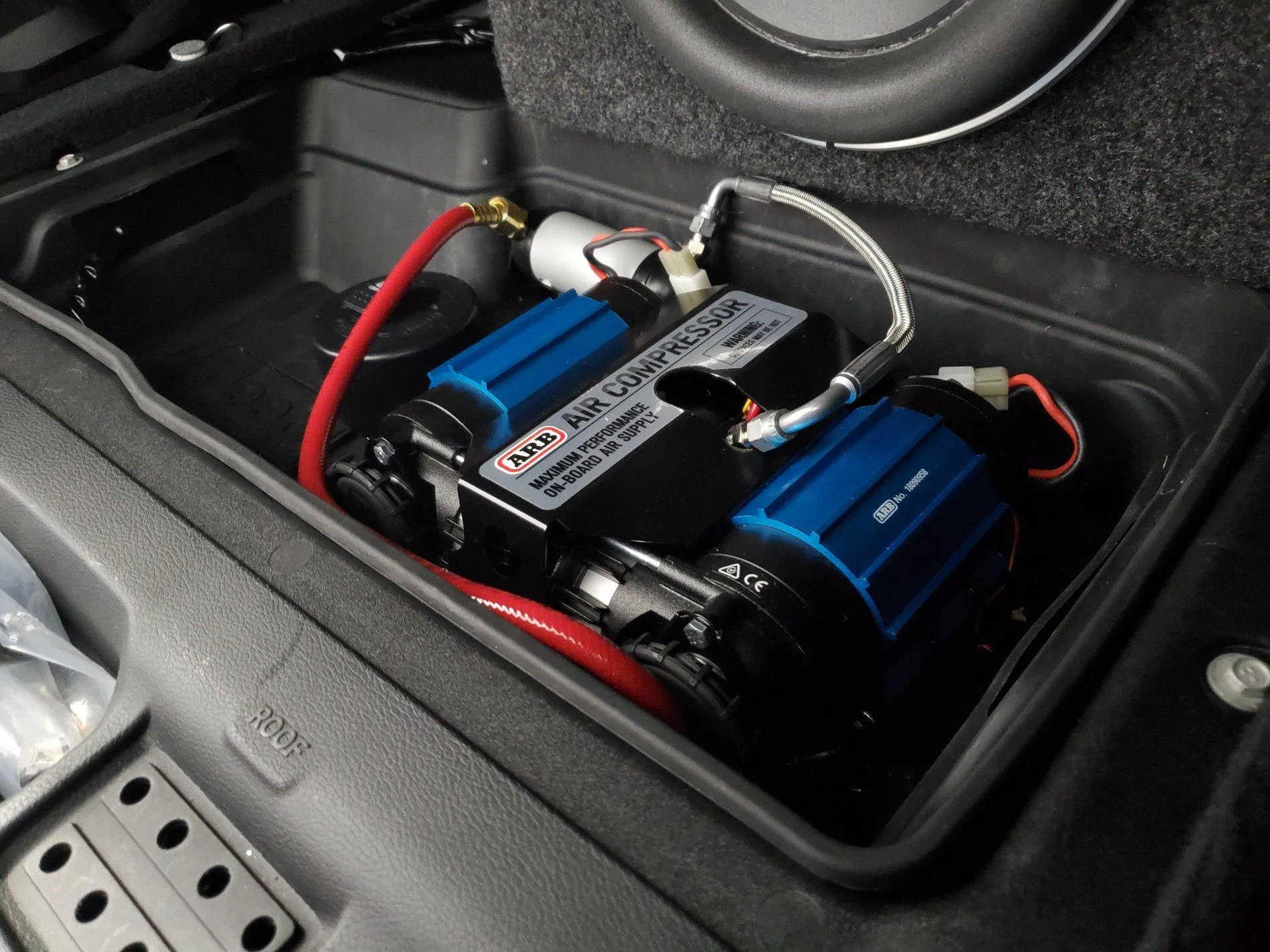

Holy Momma of the Divinity of your choice! THAT is a terrific idea! Was it easy to install?
I’ve considered adding this too.
@Sting_NC_USA where’d you mount your ARB twin? Do you have other air outlets? Where? Details!

It really was. Just have to drop the rear tail light out, with minor trimming to the inner-section of plastic fuel door assembly.

CT, I have mine mounted in the rear cargo storage bin. I ran the air hose through the drain plug at the bottom of the bin, then between the heat insulation and the bottom of the Jeep. From there, it was snaked up behind the fuel door.
I purchased the rubber cargo bin liner and have mounted the ARB Twin to that. Doesn't move, and the rubber material helps to reduce noise and vibration.
When I use it, I have a large PVC pipe cap that I wedge between the cargo lid and the cubby. Provides plenty of air, and very little modification.
This is an old picture of the mounting spot, and I've reconfigured the hoses since.

Thanks. I think I might do this. I have the under passenger seat mount with fittings on the outsides of each front seat. I want to add a tank underneath the body and route a line to the fuel opening like you have. Possibly beyond my skills, but I know a guy.
