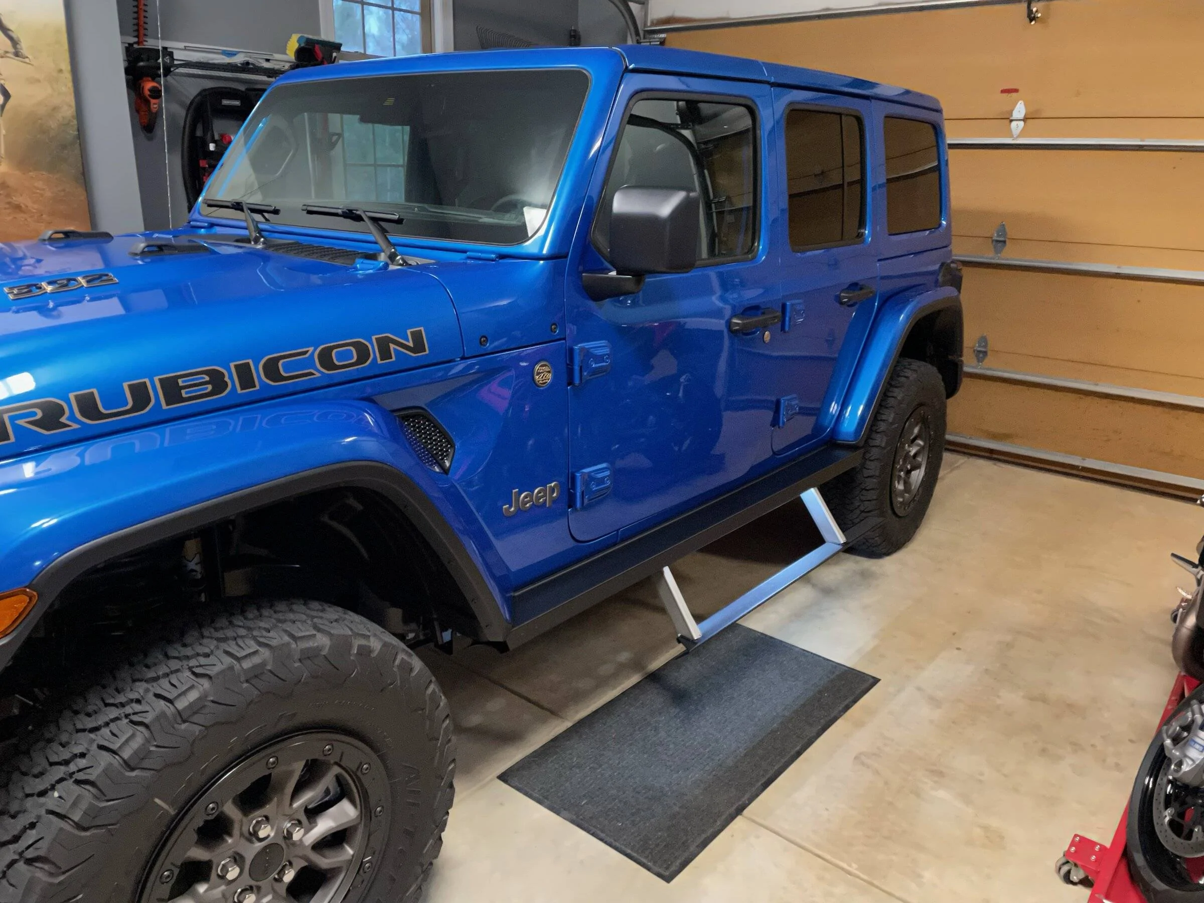

I just installed their gen 3 sliders today. They are very nice and very stout. I had to completely remove 5 of the 6 body mount bolts to file down so the washers would move. I did heat everyone of the body mount bolts because Ive heard horror stories of them breaking. It appeared to me that only the front two had red locktite applied to them from the factory so maybe those are the ones people are breaking. I got the optional light kit but did not get the extra skid plates. A buddy of mine has had them on his jk for years and has done the Rubicon, the dusy ershim, and alot of wheeling in sand hollow and his have held up great just some scratches.

Installed mine over a couple weeks (had a bad passenger controller initially, had to remove/reinstall that side) but like them a lot. The body bolts are definitely tricky, I didn't have issues loosening mine (have done similar installs before) but the filing I had to do on the middle and rear bolts to get the washers up high enough to mount the supports was a nuisance here. Wiring is good, not a fan of the door jamb switch setup but they work. Customer support is awesome, great experience so far.
